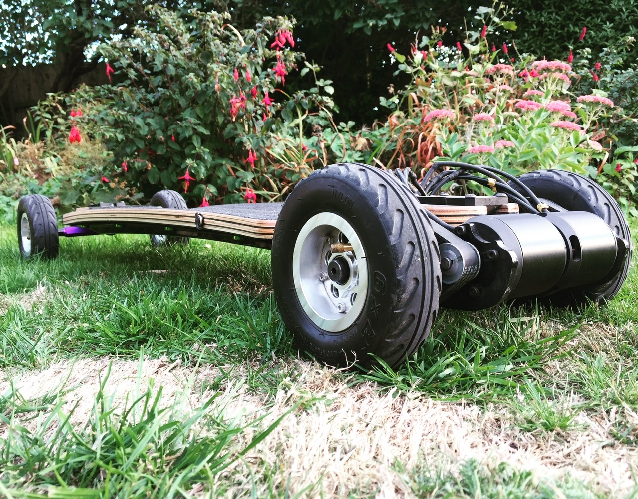

@BigBen what trucks and mounts did you use on these builds thanksšŸ¤™
Any idea now on delivery times for the hellcat wides?
These were Surfrodz with old psychotiller mounts.
Since changed to some newer prototype trucks.
Dunno! Last I heard from Ernesto they were expected mid June.

Lacroix Nazare deck, Lonestar model.
