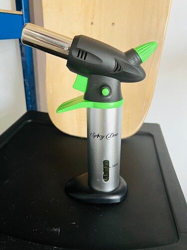

I’ve never used an soldering iron to remove a grub screw but I’ve had 100% success using a mini butane torch for those pesky grub screws.
I’m pretty sure the butane torch gets waaaay hotter than a soldering iron. Anyone know what the melting point for permanent Loctite is?
I really wish ESK8 manufacturers would stop using such strong loctite on such small screws.
Around 500 degrees F
That’s why a soldering iron does not work. The hottest mine gets to is around 465.
Ok butane torch it is. I will wrap everything I don’t want to torch with aluminum foil to be safe. This will make for a fun memorial weekend project.
