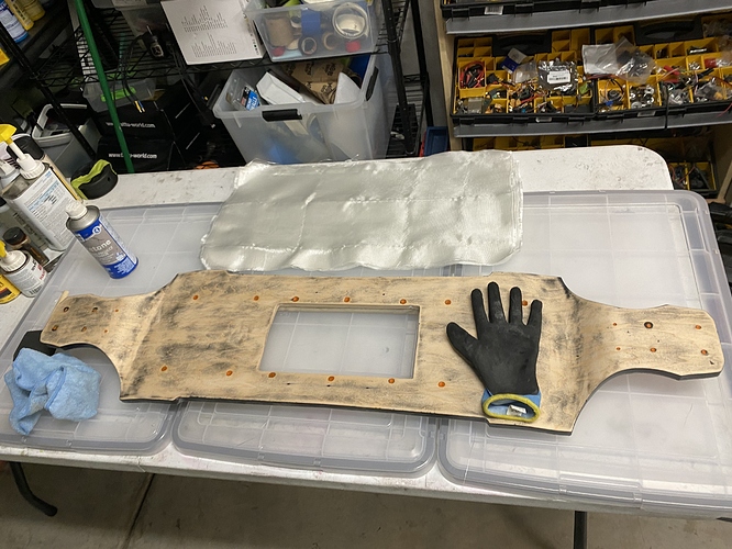

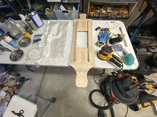

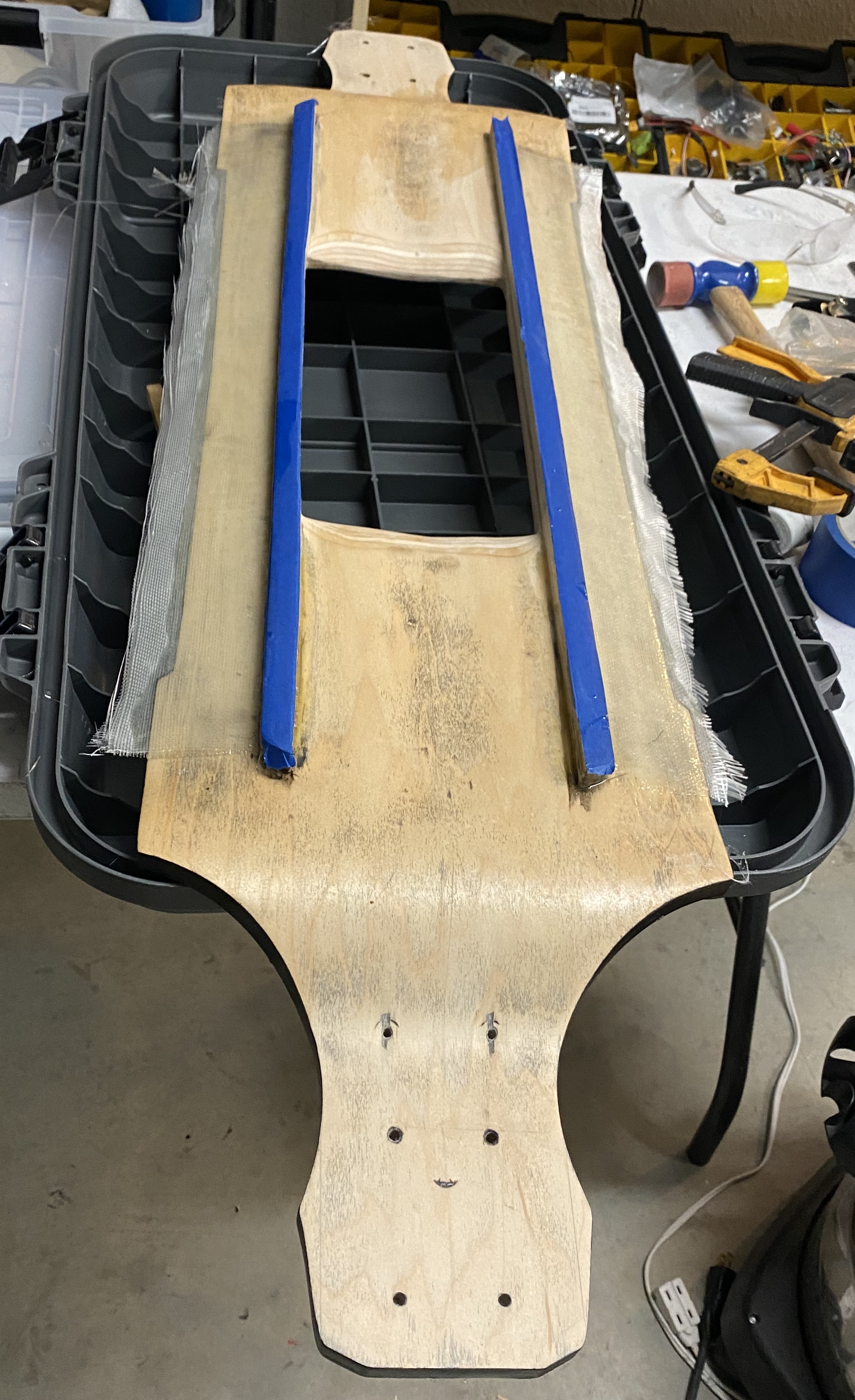

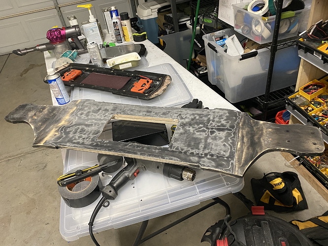

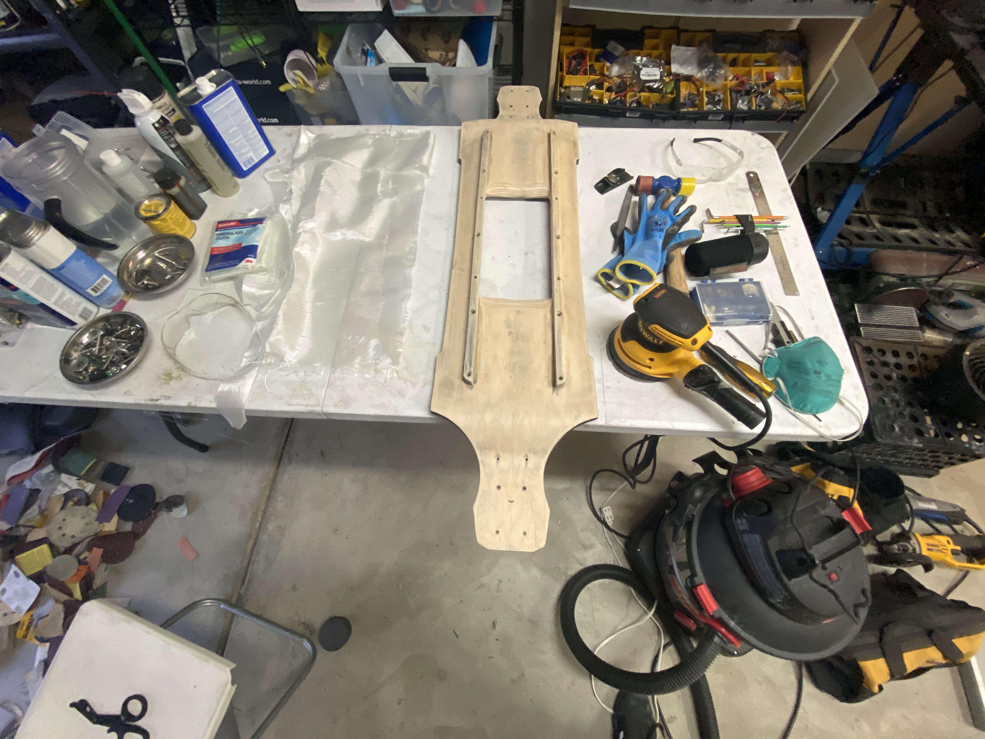

4 layers on the bottom. I’ll let cure over night and do 2-3 on the top, covering entire drop area.
Damn… Rip beautiful 44 hello RCE44… Just needs more cf then it would be perrrrfect.
RCE44 = RedEmber Carbon Edition 44 or Random Crazy Ex 44…
Nice!
I forget every time how much of a bitch this stuff is to work with. It’s like the crazy ex you keep getting back with even though she tried to cut you with a knife last time around. @Sender I don’t know how you do it.
You really massacred that deck, well done.
I welcome the communities collective doubt. I am more stubborn about making things work than anyone.

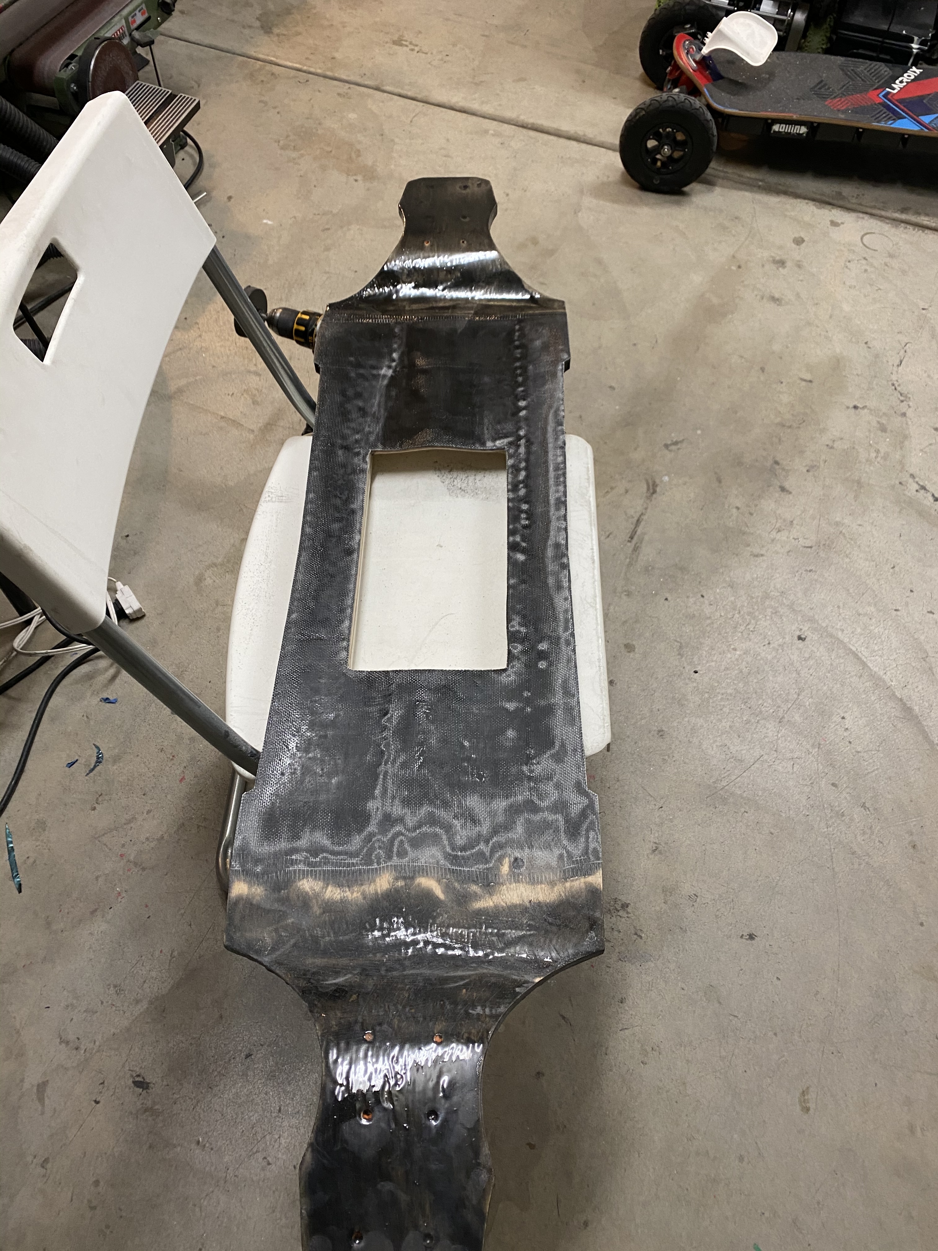

4 layers glass below, 3 up top. Using pigmented epoxy.
Its amazing that you’re like “I’m not even mad, I’m just impressed”

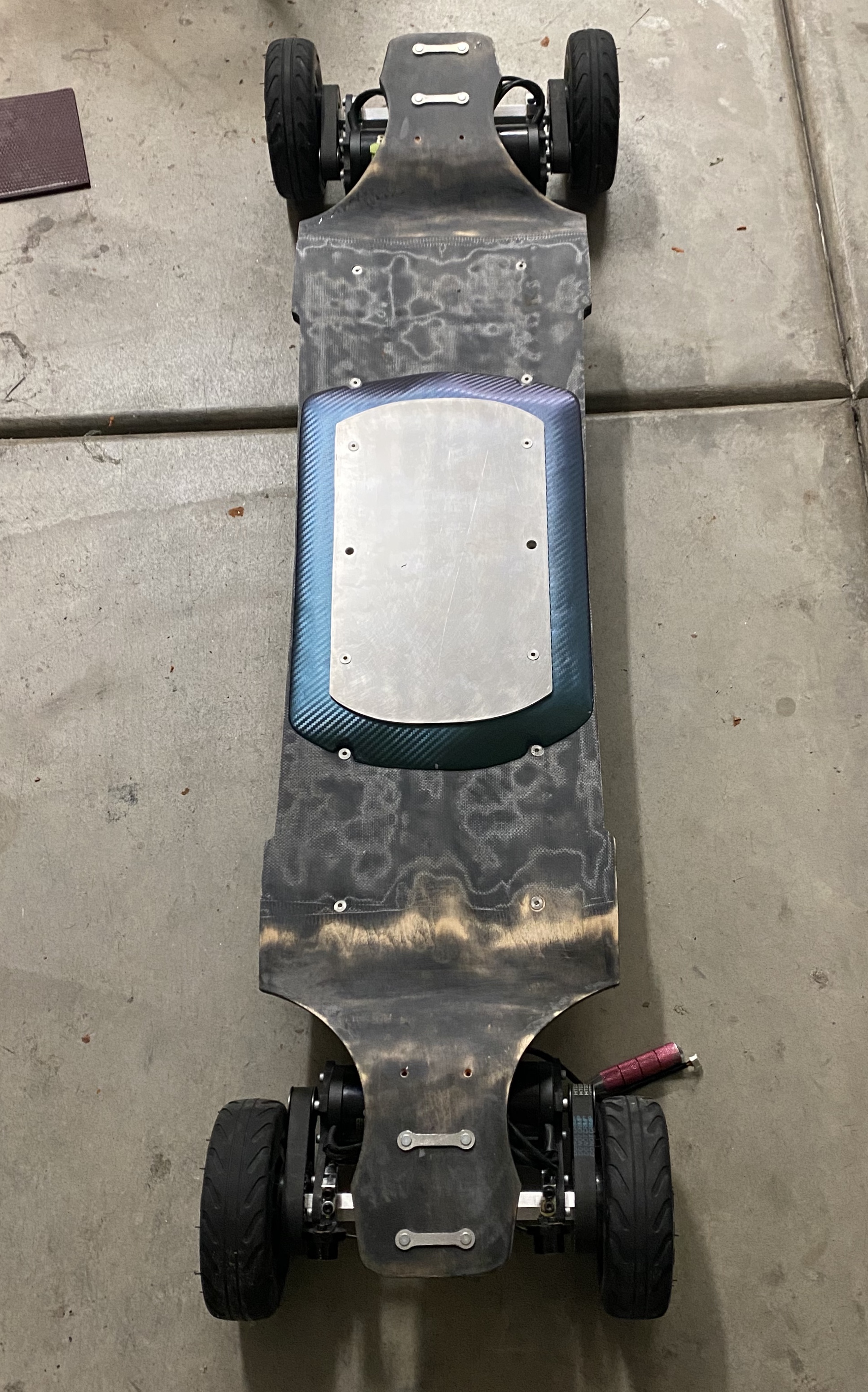

@Arzamenable Are you looking to water/dust proof this board all the time? What about making an air cooling top cover. Like a hood scoop facing forward taking in air at high speeds and vent out the back. Swap in the current cover when weatherproofing is needed.
There is already a gap in the front of the enclosure and deck that would act like a scoop.
I don’t run Esc too hot really, but I’ve considered this.

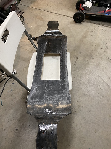

Tomorrow, sand some more and another 2-3 thin pigmented expoxy layers.
Happy to post intermediate steps that look iffy, shit will buff out.
I’m also not mad, and only impressed. This is this shit we love to see. Carry on :pray:

I’m going to finish with clear epoxy just to be a dick. Call it “rat rod” style or “nothing is sacred”, I’m purposely not putting my fucking eyeliner on for y’all.
It’s wicked stiff. No longer creaks when you bounce on it.
I have a chubby unicorn stashed in Hawaii that I should cut up to use as a spacer to clean up the enclosure mating. Maybe BJ 2021.
