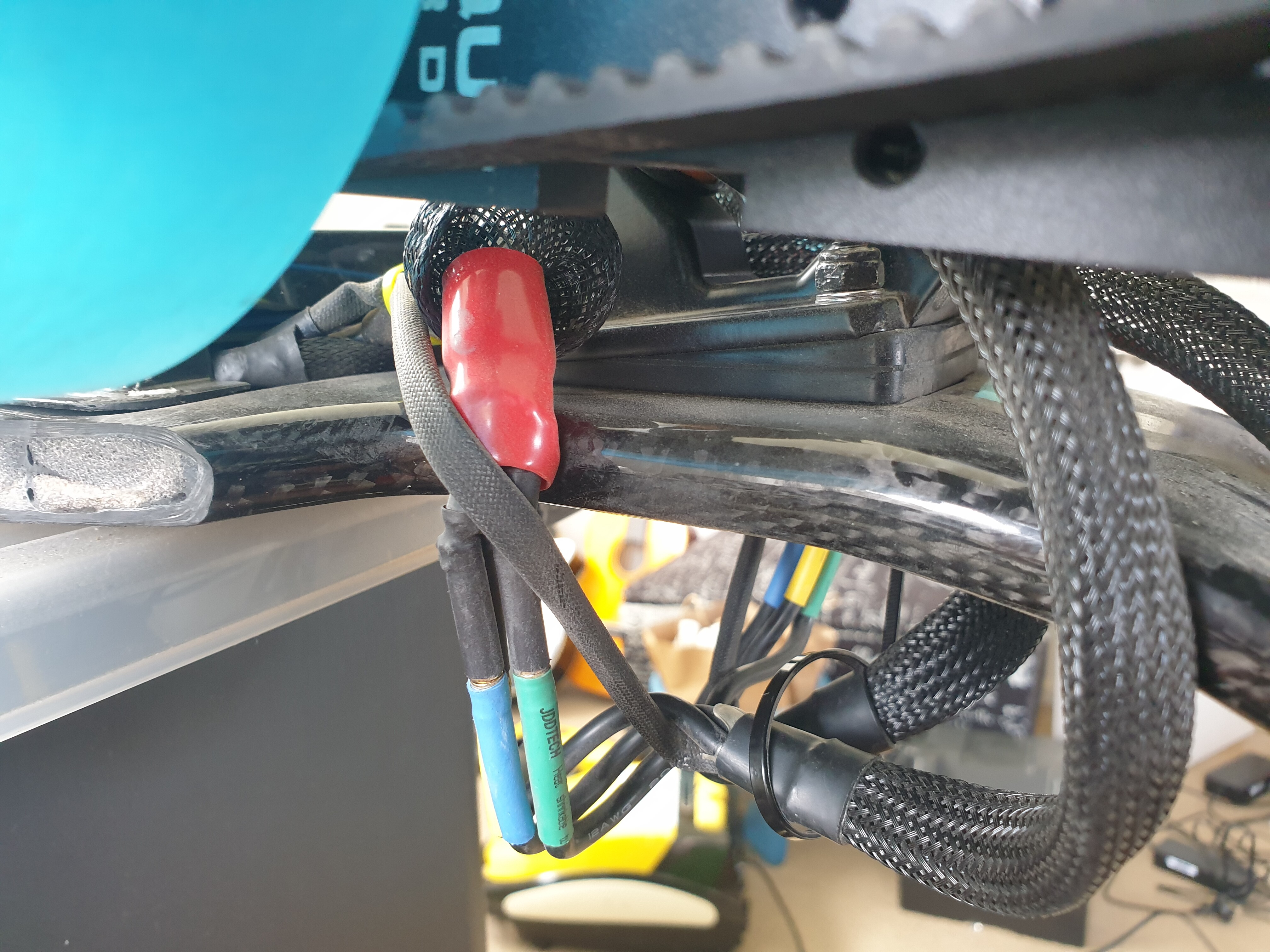

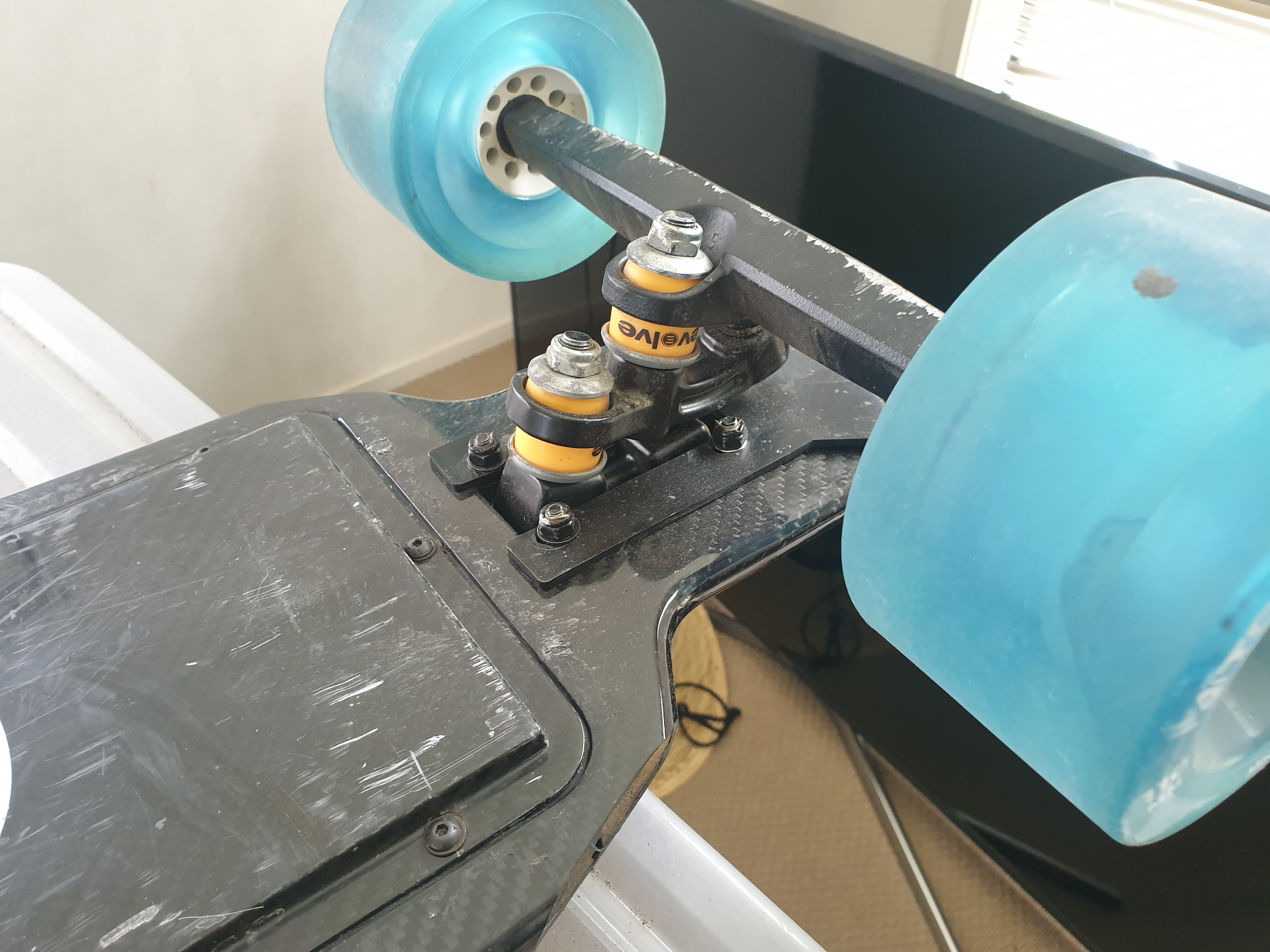

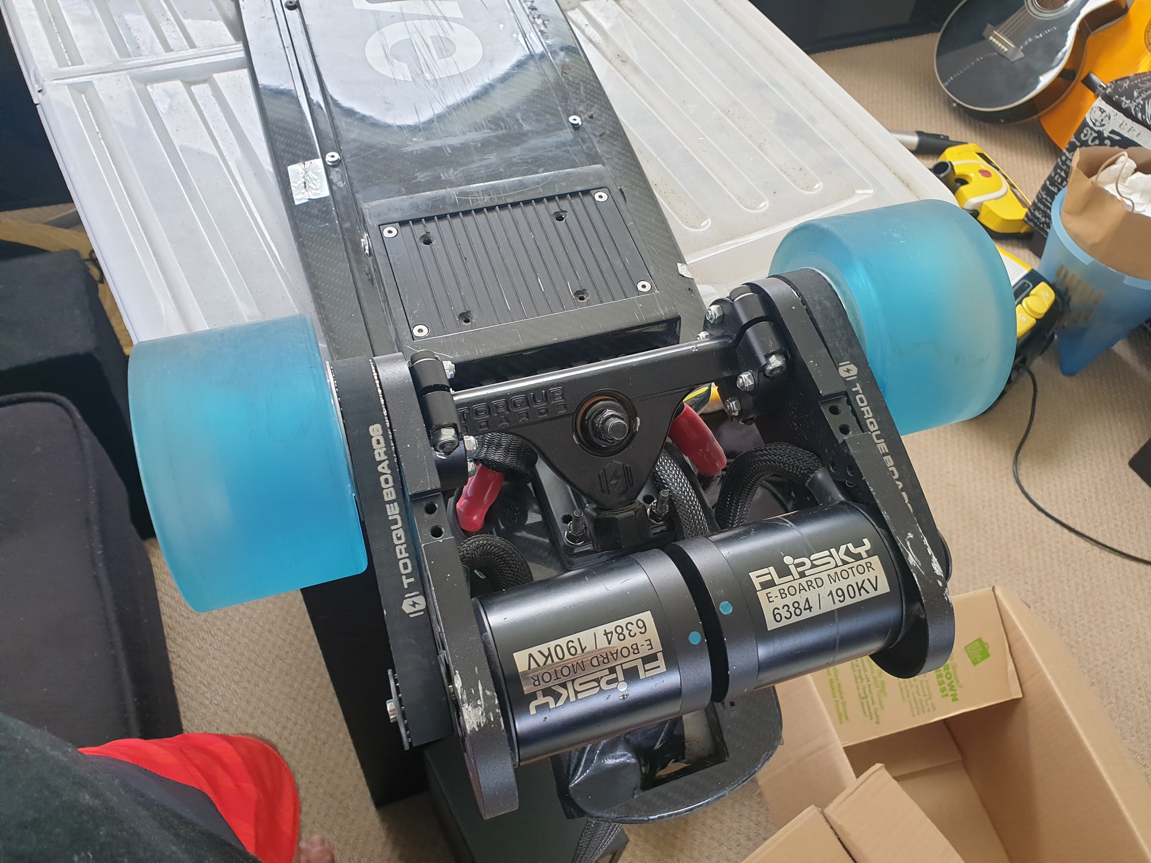

Hey guys. Have an issue with the rear truck creating some nasty odd speed wobbles. They even come on at lower speeds of 12-15mph.
The rear truck sits underneath an angled riser. Single pin TB218 truck. It is mounted below the deck.
The front is a standard evolve dkp gtr truck flush mounted with the top.
Pics may help.

Are you sure the thick part of the riser is on the same end as the pivot cup, which is the back end side? Not on the kingpin side
I didn’t do the trigonometry but just eyeballing, that looks like about ten degrees, ish.
Yes indeed it is. The thick side is at the pivot cup end. I have the pivot cup at the rear (I hope I have these around the right way…)

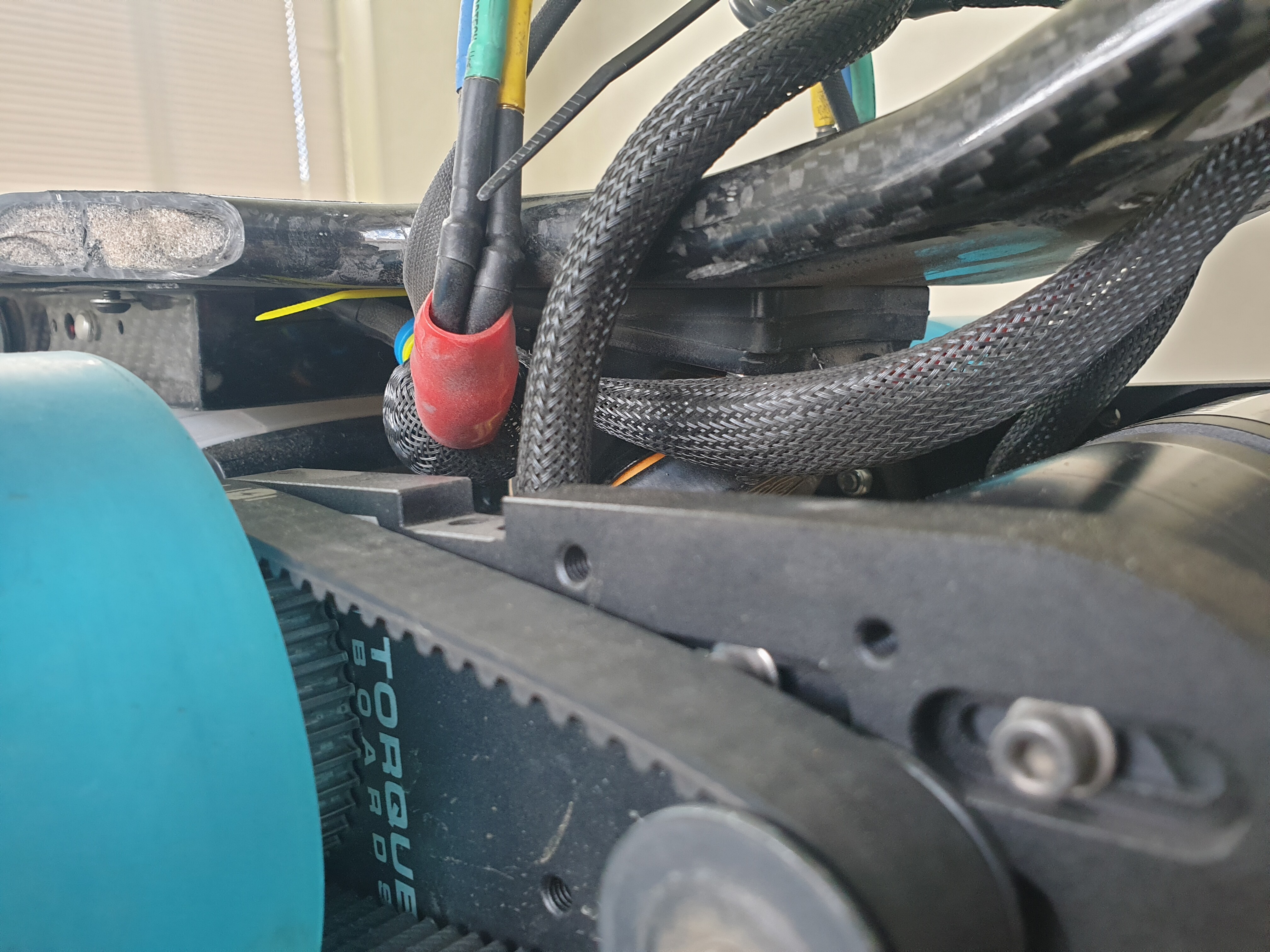

(Hard to get a camera angle on it)
Are the front wheels on the left or right side in that image?
In the OP. The board is upside down and it is the left side.

It’s really hard to tell, but what bushings are you using in the back? Either the TB truck seats are really deep, or the camera angle is playing tricks on me. Are they standard RKP longboard bushings, or DKP/traditional bushings?
I have the tb218 hangar. But it just bolts straight underneath the board. I got a mate to fabricate a mounting plate for the top. Its a piece of steel cut to fit the hole on the gen2 board where the evolve truck would usually sit flush. Not sure what a PNL 40deg baseplate is. I like the sound of it. Will google. Or do you have a pic?
They are just the standard orange evolve bush set you get from evolve for the gen2 cabon series boards in 2014. So yes DKP original orange ones. The same from the existing setup, which had DKP rear, but I just used part of it for the single king pin setup that came with the tb218 truck baseplate and hangar.
