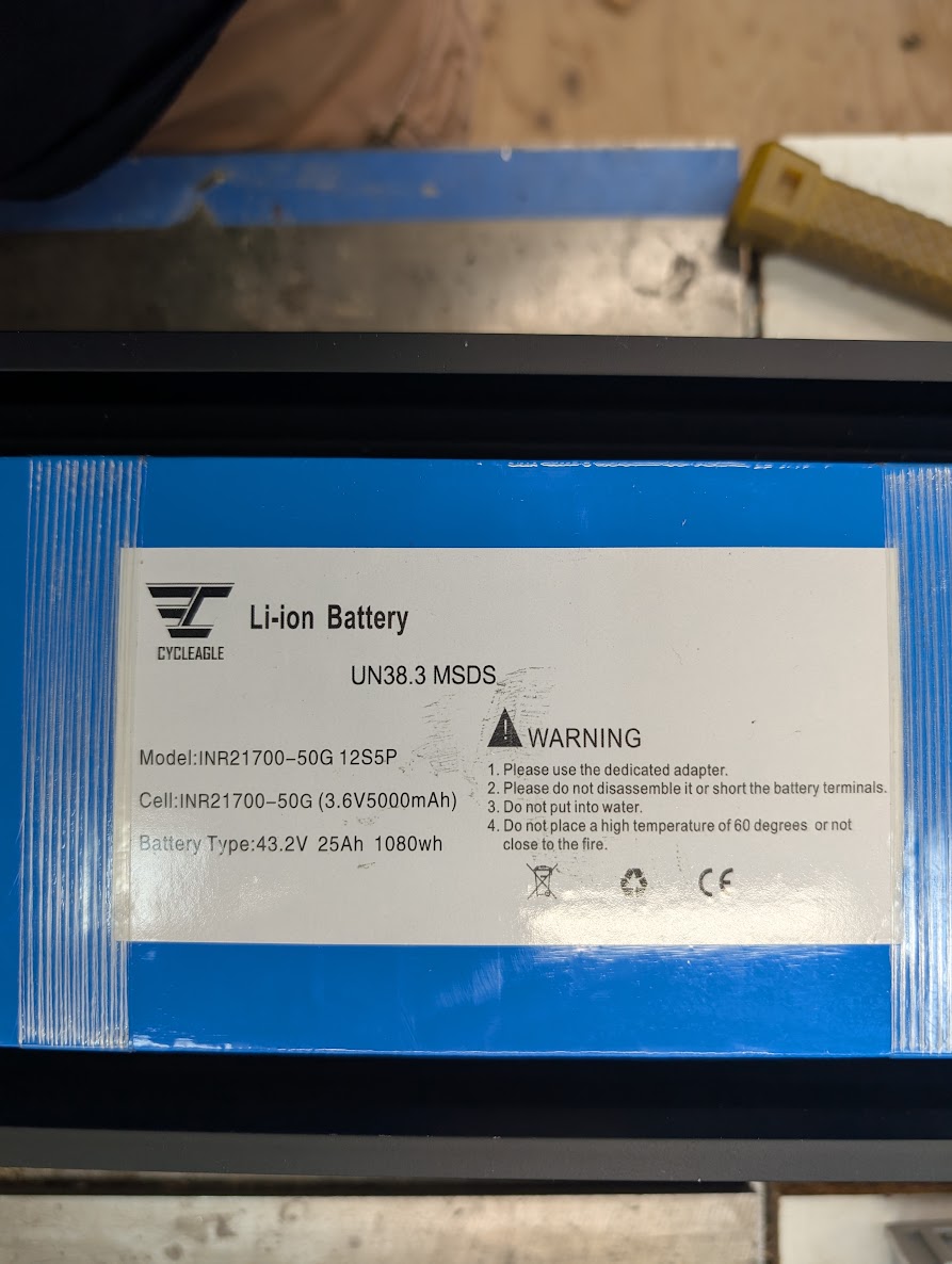

The other great thing I learned after taking it out yesterday is that this thing’s got legs! The battery is in great shape.

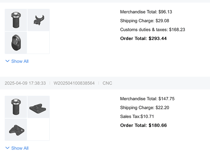

Could it be because of tariffs… I wonder.
This is how tariffs hit me at JLCCNC. 125%, Thanks US Government.
(bottom order before tariffs, top order after tariffs)
Ouch! That’s a lot of tariffs. But I saw the same thing. It actually killed one of my projects. I was within a month of going to market when the price of necessary components more than doubled. The wall warts that were $11 at Digi-Key were suddenly $30.
So for me everything is on hold until tariffs get settled out. Fortunately it’s spring, so that’s just more time to sk8.
