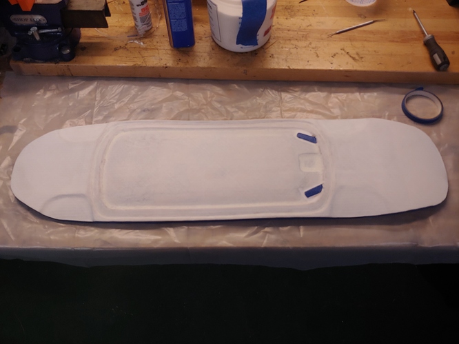

You printed on fibreglass?
No I didnt, but these guys can, and so can these guys.
I’m pretty sure there are a couple guys on the forum here already using both but you didn’t hear it from me. :zipper_mouth_face:

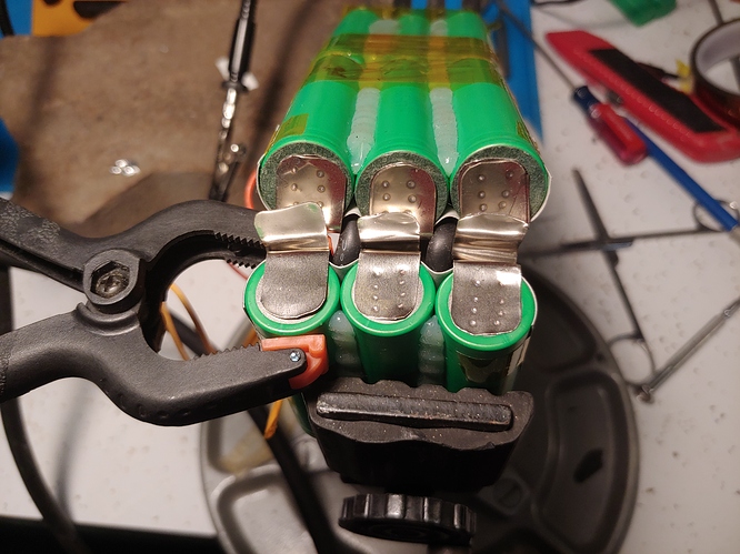

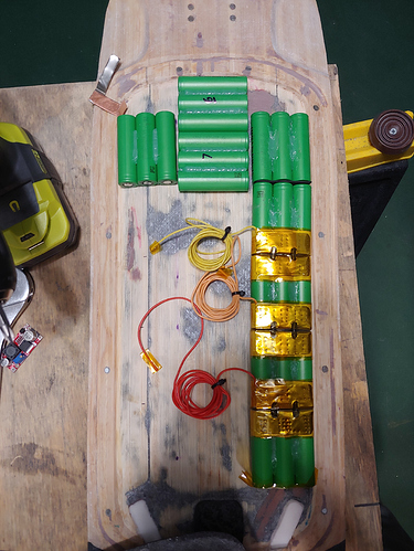

Not sure if I’m doing this wrong, and at the end of the day will have a ball of rolling fire down the street, but here’s the battery pack as it comes along.
Funny enough this is pretty much the boosted board symbol the closer I look at it.
Things are progressing, really just want this to be done at this point!
The deck graphics need wet sanded, sprayed, and sealed, then it’ll be off to the races to see if I can fit all the electronics into the small enclosure area. I might have to drop down to 3P11S ¯_(ツ)_/¯

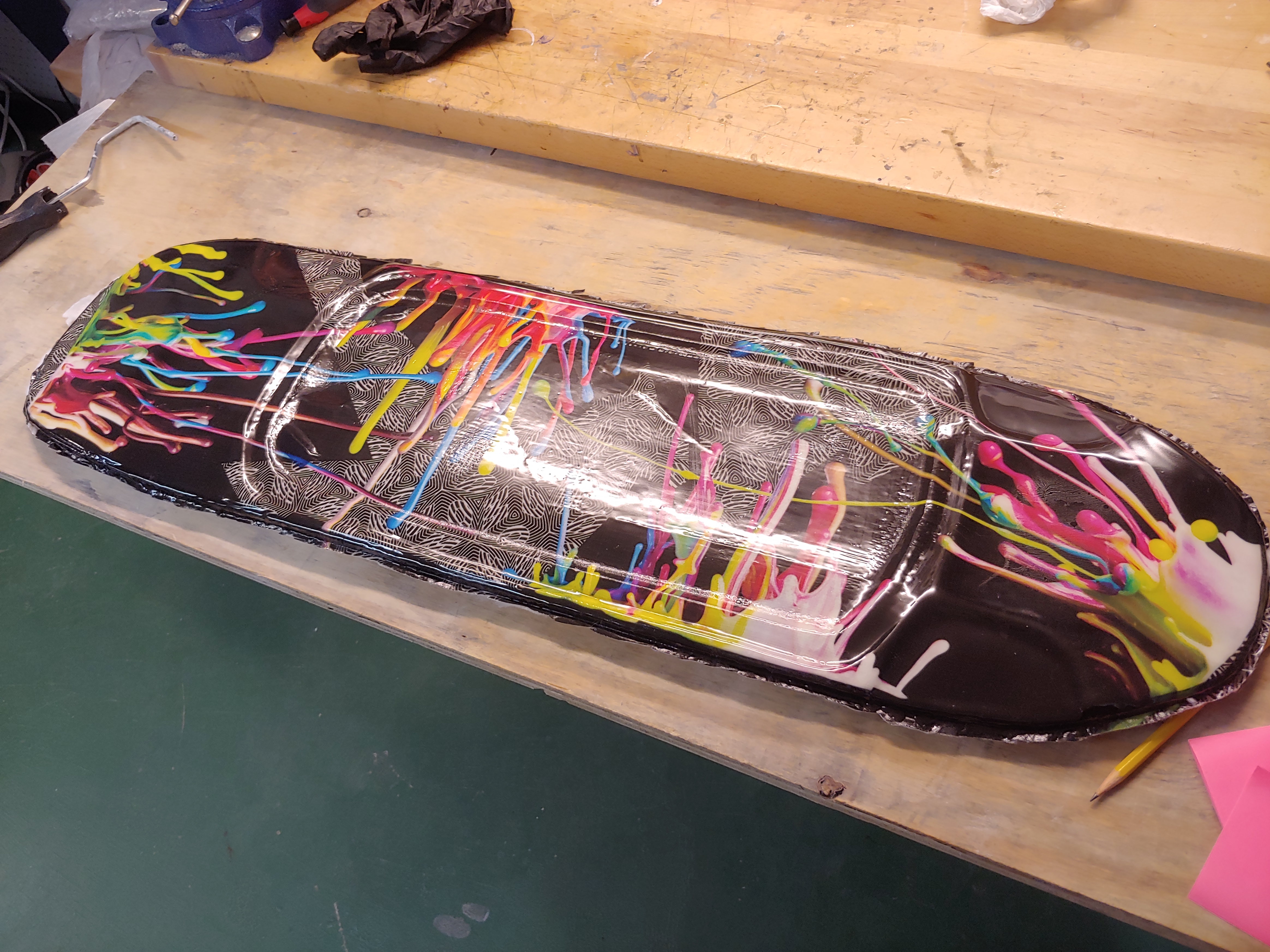

I finished sanding through the ranks up to 800 grit, and now clear coat day is tomorrow. I’m leaning towards matte clear coat but tell me what you think.

Duuuude, you gotta go gloss. It’ll be poppin!
Man, your work is awesome. Look at my Brightside (Darkside 34) builds :sweat_smile: :sweat_smile: :sweat_smile:
The darkside just looks good in all configurations, but thank you I appreciate the feedback!
It’s been a thought decision, for sure gloss will make it looks like a work of art, but then I’m worried I’ll never want to ride it cause it’s bound to get scratched up. I feel like I’ll be less let down that first time I bottom out on a speed bump if it’s already kind of dulled out on the graphics side!

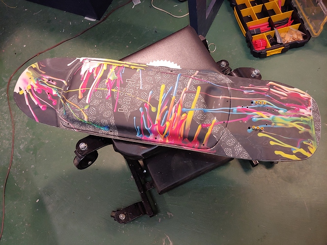

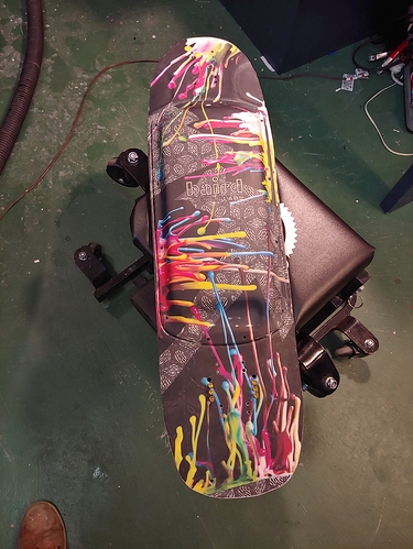

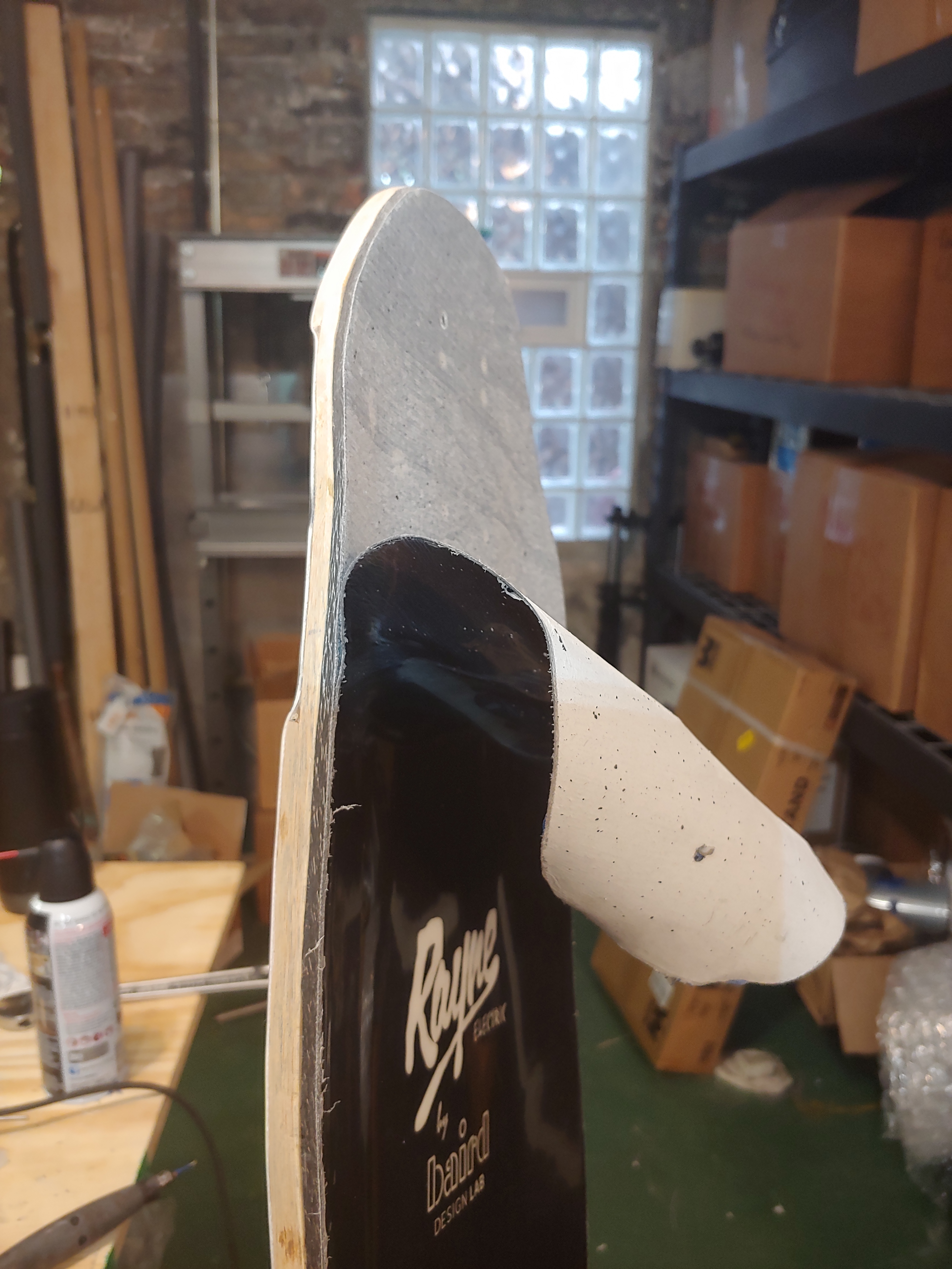

Man, this project will never end. The ricepaper I used behind the topsheet had too much ink in it and failed to adhere, while I was taping off the board for paint I noticed it was pulling up. A little prying and it zipped right off the board which totally blows.
Yet another 1 step forward 2 steps back moment… :rage: :rage: :face_with_symbols_over_mouth: :face_with_symbols_over_mouth: :sob:
I guess I’m glad I found it now, but what a flipping let down…
