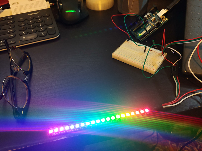

Things are progressing steadily. I’ve got my top side RGB LEDs rocking, did a fit test with some 3D printed cells, adjusted the fit of the enclosure to smooth out the transition, and got the board graphics in.
Next steps are embedding the LEDs, trying to do the same with some 12v brake lights (but worried about potting the lights in and trapping heat), then applying the graphic layer.

I also mocked up the RGBW LEDs that will live under the diffusion elements (I’ll be casting these later but wanted to see how it would look with some test chips I poured earlier).

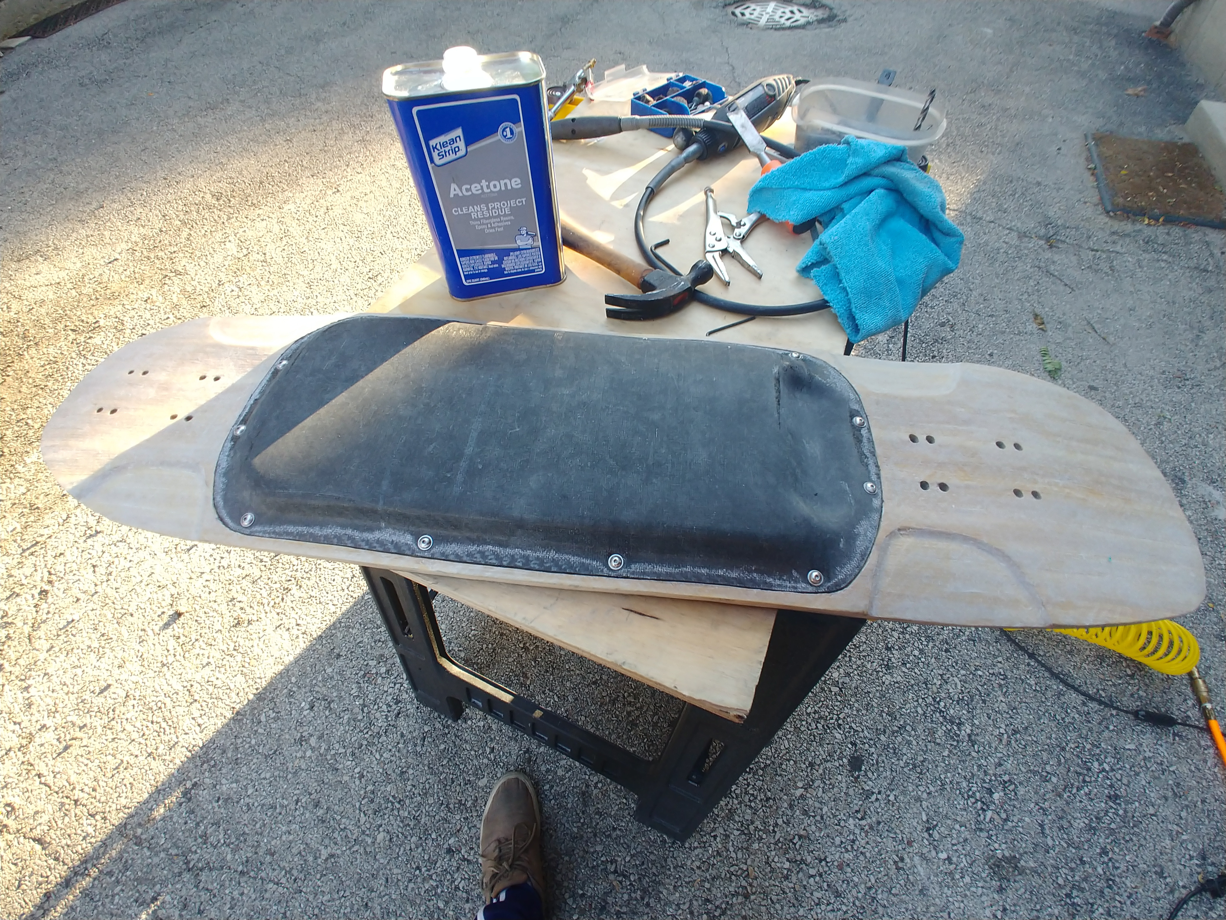

After removing all that material it quickly became apparent that I had lost a ton of stiffness in the board at the truck mount. I haven’t quite figured out if I want to lay a glass layer on the top to strengthen some of the openings. I want the LED light on the top to be as clean and diffused as it could be, so decided to add material on the underside of the board.
I made a series of several hundred holes in the deck in the area shown below here with a known depth. That way I could grind all the wood away and stop at the depth of the holes knowing the hole surface had been offset to the specified depth.
From here I layered up a bunch of 12oz carbon and ground it away flat. I lost the pictures from that bit but you’ll see more of the underside carbon later.

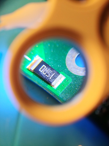

I then got to setting up the DieBieMS I’ll be using, but unfortunately fried a resistor so I’ll have to get some of those in.

Here you can see that carbon reinforcement bit at the rear truck mount on the underside of the board. It’s about 2.5-3.0mm and added a ton of stiffness back.

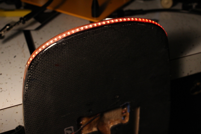

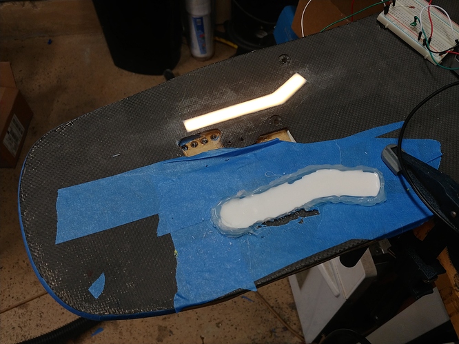

I debated for days on end whether to permanently cast the LEDs in resin, but ultimately through some R&D figured out I could make a negative or hollow space behind the cast resin, so when for that route instead so I can replace the LEDs if any burn out.
That involved some silicone, a light adhesive, wax, some clear hose, hot glue, and a whole lot of anxiety that ultimately paid off.
Once the silicone was removed, I was able to shimmy my LED strip into the space, solder it, and test it out. I’ll close up the hole with some easily removable silicone. I figure the LED should at least last a year or more with the heavy heat sink there helping it out.
I was super happy with the results. All the photos below were shot with 6v on the LEDs. They’re almost blinding when 12v is on but it’ll be a great way to be seen on the road.

That looks so clean! Really great resin pour
I have to say that the idea of using the clear tube as a mold is genius
When I did my rear 3D printed light, it had a curved cavity that needed to be filled, my best solution was to use electrical tape, if failed tremendously, the heat of the resin curing softened the tape and it looked bad
Just let me know if I got it right, I liked the idea so much I may try on the rest of my board
You wax both the tube and the silicone rectangle strip, seal everything with hot glue leaving one side open to pour the resin, once cured you just remove the tube and you can pull the silicone easily out leaving the cavity?
here here! It only came to me days after stewing over what not to do. I did go back and forth over using a 3D printed mold, then foam core & hot glue, it really wasn’t until the last minute that I thought I could even make the lights removable.
You’re damn close. You’re definitely right about heat. The heatsink I actually think helped pull heat out of the curing resin (+1 for that!) You’ll need a vinyl tube, no wax needed, it’s basically a mirror finish inside so doesn’t need any mold release or anything. The trick for me was putting wax (almost grease maybe? basically I used Burt’s Bees lip balm) and slathered it on the silicone strip. One it acts as a lubricate to extract the thing, but two and actually the game changer for me was that if you load it on heavy enough it actually causes it to stick to the substrate (copper in my case) and can support its own weight upside-down.
I did try to plug one side and pour the other, but ended up pulling the plug and pouring both. A low viscocity resin works best too. I used total boat’s clear cause it’s thin enough to wet glass but also uv resistant.
I messed with like 3 different attempts to do this and the best one was silicone + grease. Here’s a picture of the test run I did in a full tube. The Burt’s Bees didn’t heat up enough even with a full tube to release from the aluminum rod, it even cured fully upside down like the board.
You should try it again with the tube, hot glue and everything.

Made some more headway with the deck lighting. I potted both channels and rough sanded the flash area leaving about 0.50mm of height on the epoxy for a later final sand and gloss. I’m really stoked about how it turned out.
