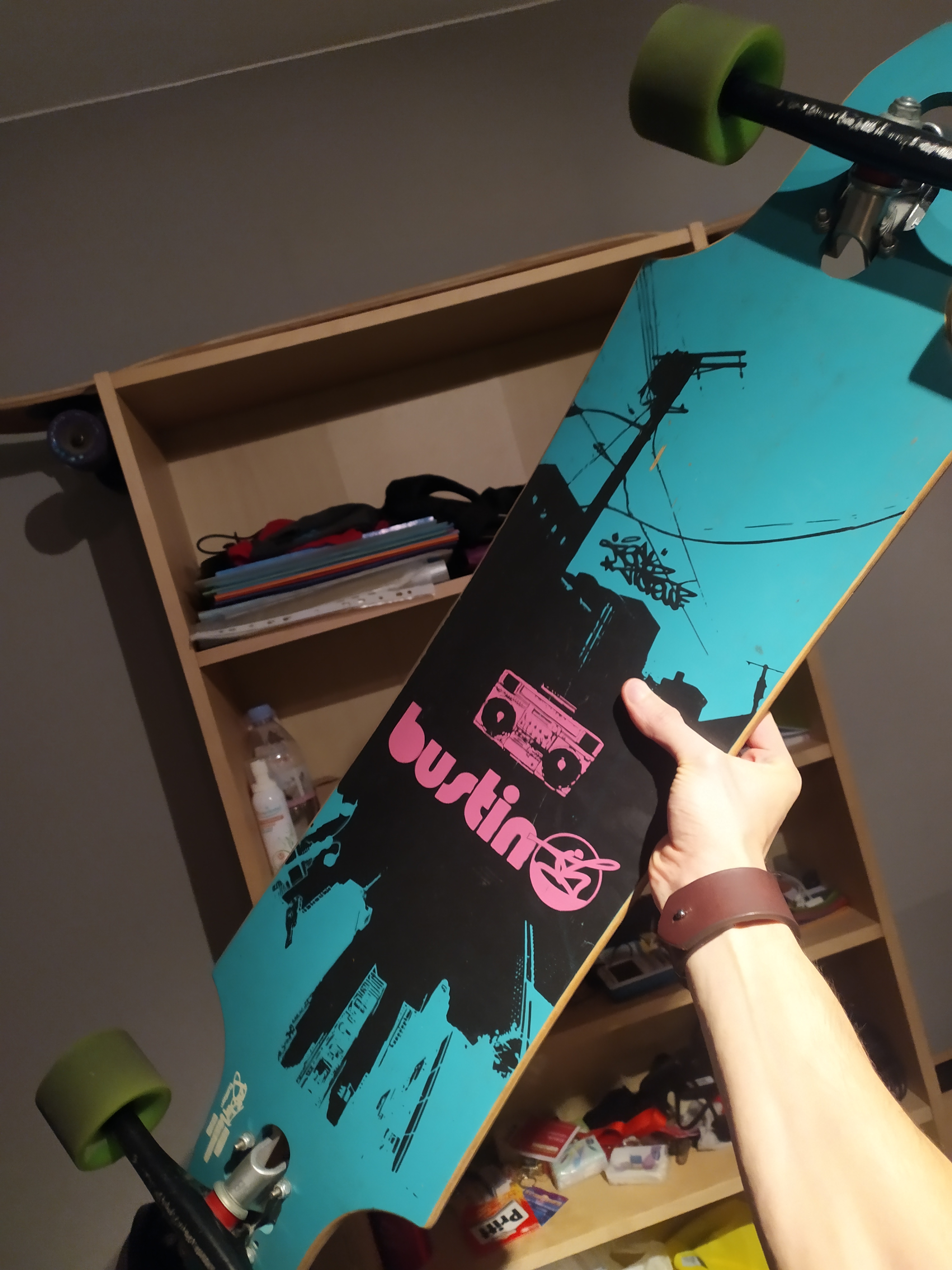

I put a Bustin EQ36 on my Craptor. It’s worlds above the original deck.
I understand the need for a stiff deck on a board built for speed, but I’ve ridden a lot of decks and the original raptor deck really didn’t do it for me. Everything about it just lacked.

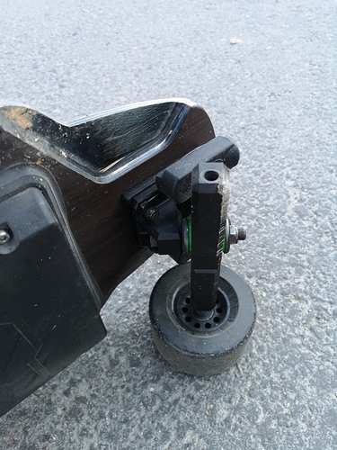

But after 5 month bms/battery started to fail so it did power off random when I was 50‰ or lower…
Then this happend when I rided in 25mph, not so fun anymore with this board:

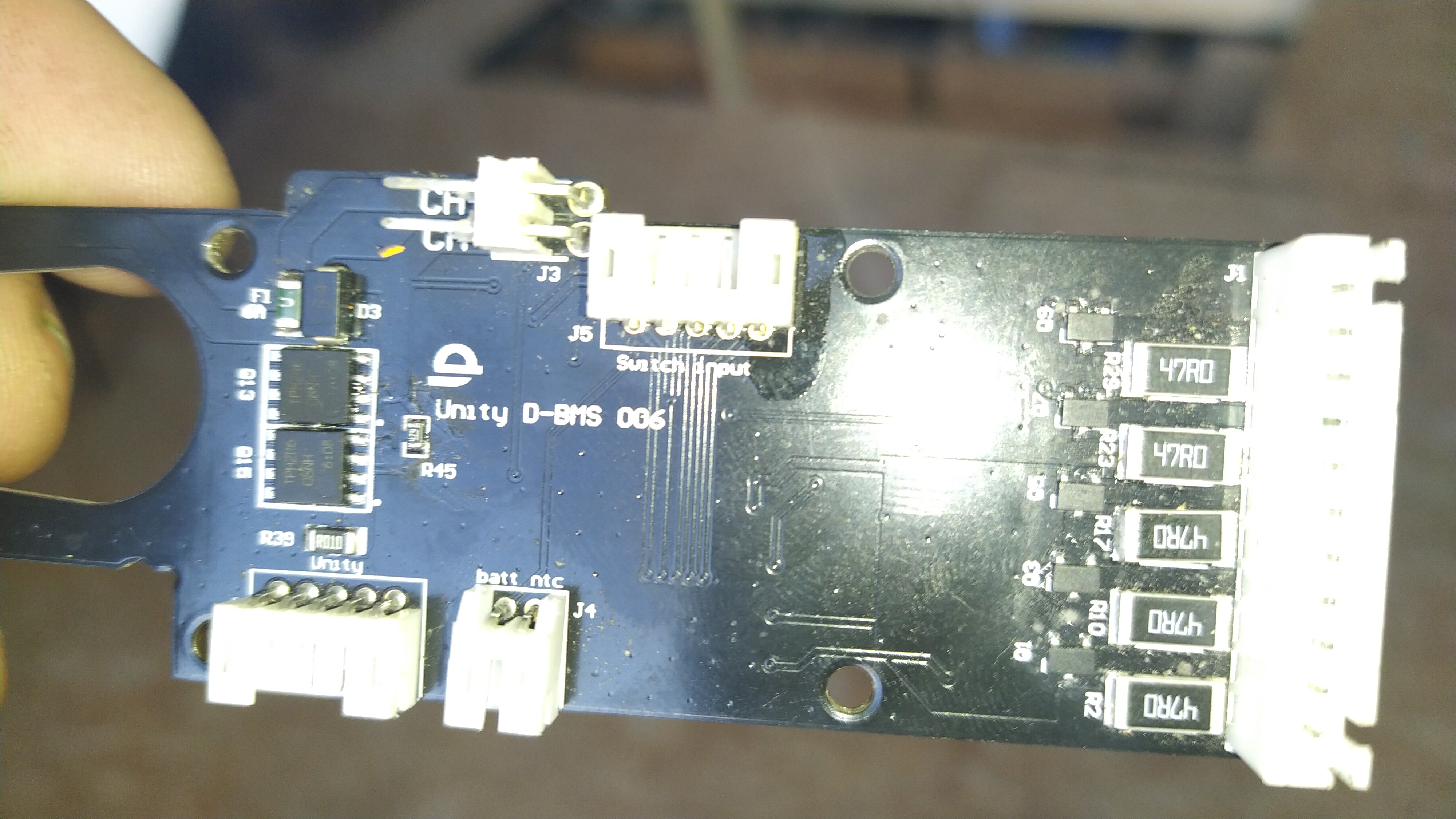

Looks like they don’t go trough the BMS. It’s 15A max. Look at those wire diameters. It means it does not cutoff the battery if heating. The BMS is just here to keep all cells at the same voltage right? Why didn’t they put a 60A BMS instead of a cheap 15A? It does not cost that much…on a 1600$ board
If I understand correctly, @RobNO and I have a ‘charge only’ bms. Even though mine is different. The fuse on the side is just not integrated in the bms.
Please anyone do correct me if I’m wrong. We need a full blown wiki :sweat_smile:
I’m really not a pro in this. I hate electronics.
What controller do you have? I guess CH- and CH+ are for the charger. Switch input are logic signals so that the BMS knows if you’ve plugged the charger and it has to switch to charging state. Unity goes to your controller (do you have a focbox unity? I don’t know if it can switch while ridding to use regenerative braking…?) NTC is for monitoring the battery temperature and on the right you have all the cells potentials
I wasn’t being clear, that thing is already dead, I was just surprised that we both have a different one, in the same board. I’m trying to get my head around the different types of bms’s. Internet can has too many infowz
