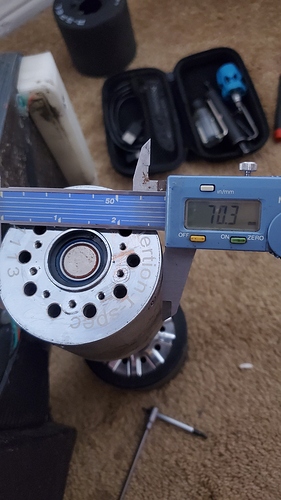

Do friend have dimension of motor?
I can get you exact dimensions if you wish.
It should be in those step files i posted above?
No is only insert piece for wheel.
If have for now can start verify design.
Can diameter 70.25mm +/- 0.05
Bolt circle diameter 38.5mm, 10 total, M3 thread, do not exceed 5mm depth or possible collision with stator.
Total can length about 64mm
Misc measurements.
Thank you friend. This very help until motor arriving.
Ignore the larger round holes on my motor, they were added by me, they do not exist normally, only the 10 threaded holes.
