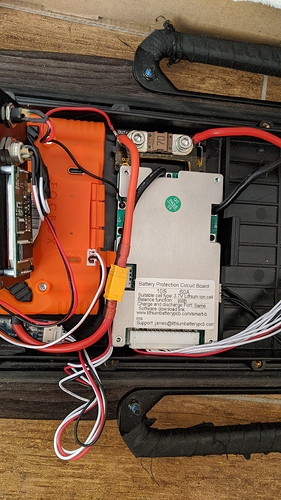

Well, I plugged everything to charge it. Good news, nothing exploded. Bad news, my battery still won’t charge over 55%. I checked each pack of cells and I have different voltage between 3.6V to 4.8 V. So I don’t understand why it doesn’t balance…!

10S4P : Voltage mesured: 42V
Pack 1 : 3,62V
Pack 2 : 3,63v
Pack 3 : 3,65
Pack 4 : 3,66
Pack 5 : 3,85
Pack 6 : 4,79
Pack 7 : 4,83
Pack 8 : 4,81
Pack 9 : 4,78
Pack 10 :4,8
So pack 6 to 10 are over charged…

Is the wireing correct going into the bms. Some of the wider plugs skip a few pins
@Kram720 yeah, that’s perfectly normal. They do that so the same BMS PCB can work for multiple series count batteries. Since yours is only a 10s the other wires aren’t needed and if you look at the under side of the board the unused pins are bridged over with solder

Batt through the fuse as standard,
From the fuse or link the b- to the b on the bms
I desoldered the charge plug from the original bms and attached wires to it.
+to main + on esc side of the fuse.
Charge- to the c on the bms.
Then plug in the old charge port.
Pull the blue/white switch wires from the unity and plug the switch in direct.
You now have the advantage of knowing what’s going where so can apply better cable managment than I did😁
@Kram720 If this is not to much to ask, can you supply a drawing of the wiring pretty please? I assume this config is charge only? I was planing on charge/discharge config. Just no clue how to wire it up.

All the 11 Pin Balance wires I get where they go…
The issue I am having is the connection between battery, BMS to the FocBox Unity and the barrel charging socket.(neg to C- I guess and the positive??)
Again I want to set it up in charge/discharge config

replace P- with C- since you’ve got a smart bms
also if your pack is out of balance
So not like this?
Bms is huge…
nope, i see your bms P- is going to the esc (load), right?
that bms is rated at 20A, it’ll choke your esc. that bms is meant to be bypassed, as it’s shown in my diagram.
It’s rated 60A
Due to the fact that is 60A rated I mentioned earlier that I want to use the charge discharge feature
Kram got the 20A BMS. Same manufacture but a bigger unit
oh ok, the ones i get are 20a
