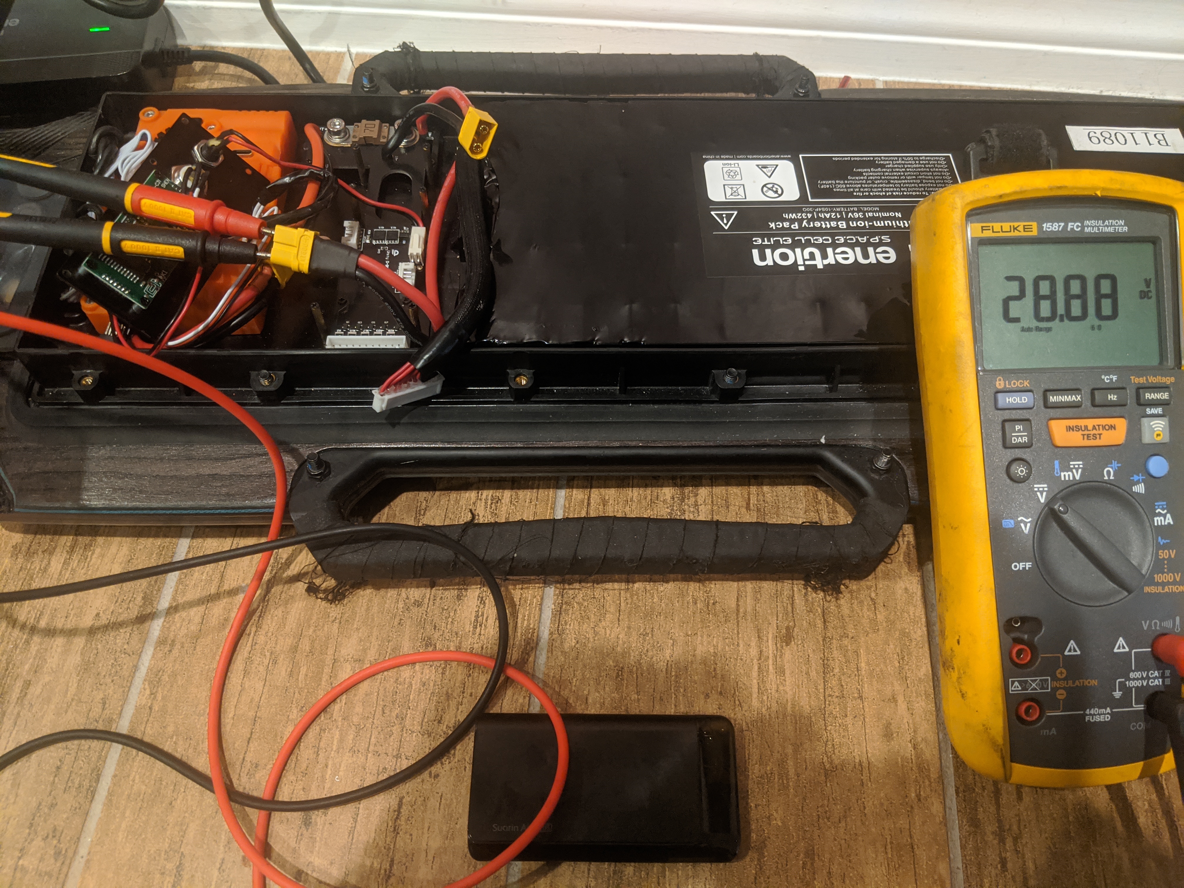

Ok. After my Raptor 2.1 died mid rite (at approx 22 mph) and I gracefully came to a stop, I knew there was something wrong.
I know it’s a Enertion Product and people hate the company but it’s my only board atm. After inspection I found burn marks on the BMS bottom side. The board doesn’t take any charge. (Charger LED stayed green ).
I got my hands on a new BMS, also enertion my old BMS was PCB No 004, the new one is 006. Post pictures below of the 2 different BMS for reference. The battery was last at 77% as per display readings. That was 1 ½ month ago. Now the volt meter reads 29V and the app sees 10%. I installed the new BMS and the charger led turned red. So it was charging for 20 min… Up to 15% than the led turned to green…

My question now is. Does the Space Cell Battery Pack I guess it’s a S10 x2P is still alive? I try to read up on the BMS functions and found that it’s charges groupings of 18650 cells evenly. I don’t know if the bad BMS had a consequential impact on the battery pack… I live in South Florida so it’s always a bit warmer here and this board doesn’t have any venting. Just try to get to the bottom of this. I am aware that Enertion is Belly Up so I can’t make use of my extended Warranty I guess. !

Do you have a volt meter of any sort? A bad BMS can knock cells out of balance, but without jumping to conclusions, we need to check the spacecell pack by itself. Individual group voltages and total system voltage

:joy: :joy: :joy: Probe every adjacent wire pair on the balancing plug, 11 wires gives 10 pairs, each pair goes to 1 P group. all should read similar voltages.
Write them all down

I hope the Bullet connection measures the hole battery. Ok I broke out my pinout set and attached the flat cable to all 11 pins. How do I messure the cells individual? Positive to pin and negative to ground plug from bullet connector?
Ok here the results of above mentioned method.
Oh no, that’s not good. The previous BMS killed groups 1-4, the new BMS shut off charge when group 10 exceeded 4.25. That pack unfortunately is likely unrecoverable. Potentially half those cells can be reused and rebuilt into a new one but I doubt the 16 cells from 1-4 is usable anymore. Where abouts are you located?

It won’t help. The fact that it was charging for 15 minutes with 0V still, group 4 may be recoverable, 1-3 already sustained unrecoverable damage, even if you forced a charge, the BMS is going to struggle keeping that pack in balance for long.
Never try charging cells that went under the 2,5v again without extra safety. When you want to recover cells you have to charge them on a very low current. Let them lay for some weeks and check out if they hold capacity.
