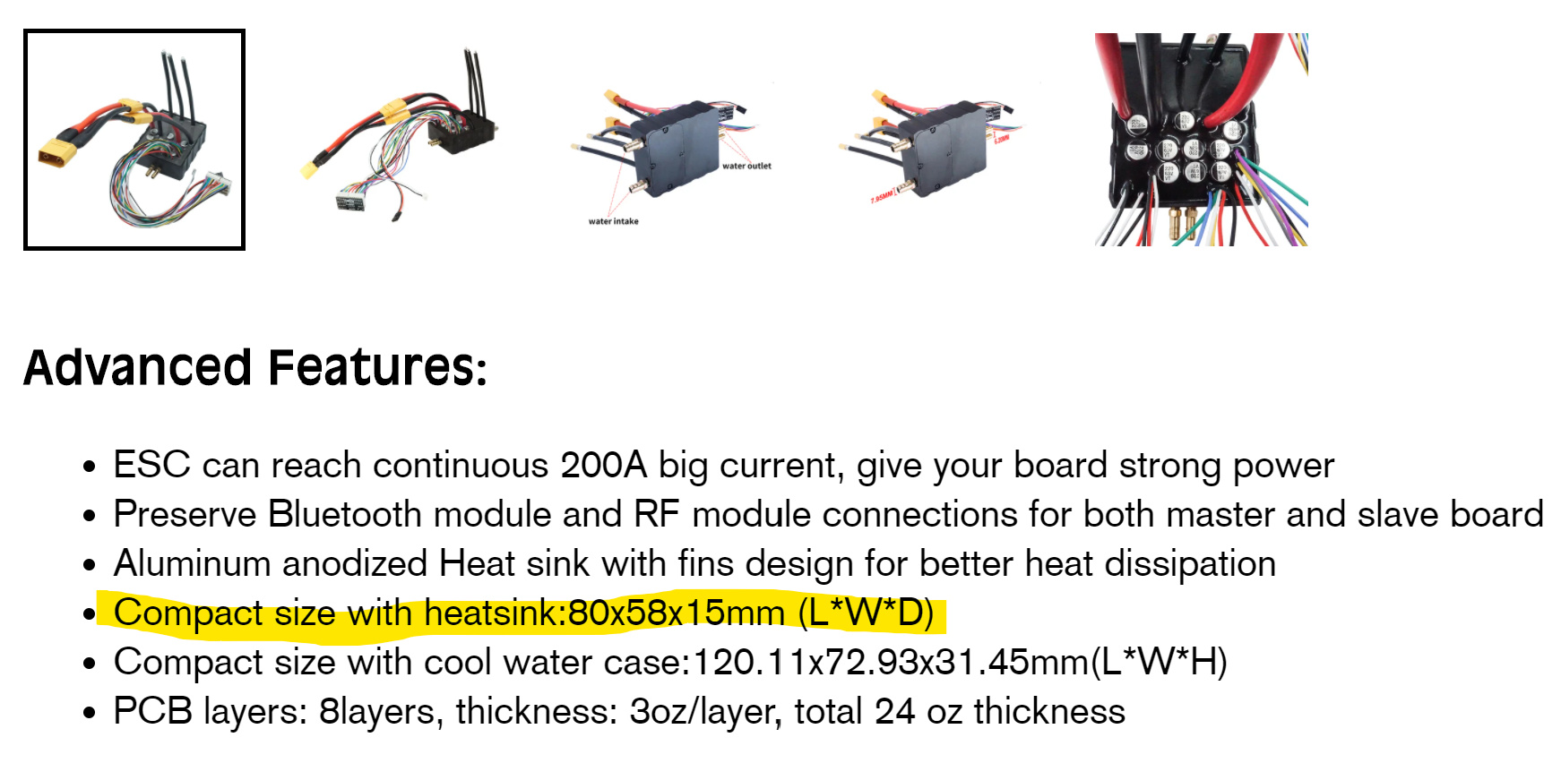

We are in a bit of a hurry, so I used a mill to make a box for it while waiting for the ESC to ship. I knew the dimensions of the box because it says on the FS website:
Today I get the ESC and it is 67mm, not 58mm wide. Now I need to re-do my boxes, which is a big PITA and a lot of work. This is my question:

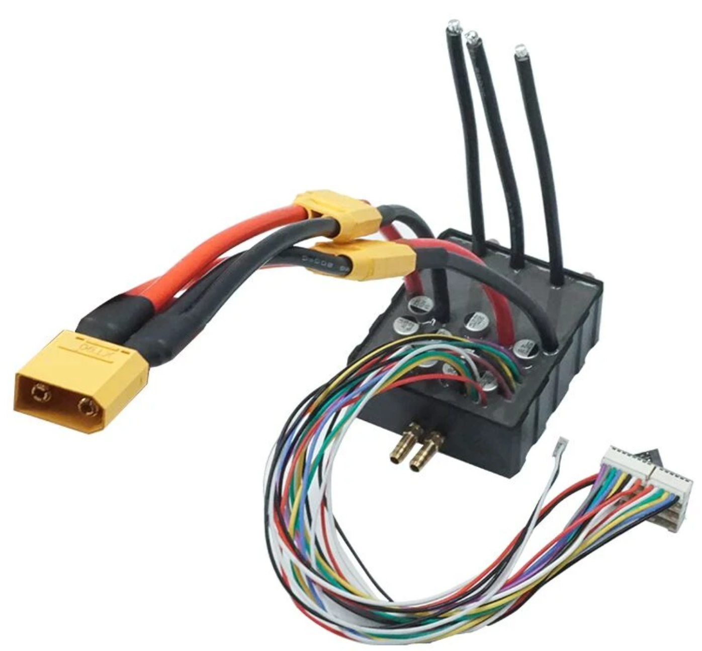

On another note, if they have some engineers in-house, are they children or robots? Look at this design:
The ESC is bricked in epoxy so it is clearly waterproof and intended to be submerged. But the connectors, XT-90’s and SH’s, are clearly not waterproof, and are intended to be located in a dry place. But a grownup human would know that XT-90’s aren’t water proof, and so they wouldn’t have bothered with the epoxy, or they would have used a waterproof connector! But minimal pull testing would show that silicone jacket wire doesn’t bond to epoxy potting compound, thus invalidating the use of the epoxy in the first place, so I can clearly not choose the design in front of me!

I’m sorry, coming from an ME over here as well, I can’t believe you did this sight unseen - I never trust factory dimensions on something as ambiguous as a heatsink like this. Especially to mill a part before the actual product shows up, idk man
Unfortunate but could have been avoided. There is still a point to be made but you aren’t backing up what dimension you are talking about either.

I mean I guess I get your point, it is disappointing. What dimension are you talking about anyway, is there any chance they like listed the wrong one or something?
Its the width. I think what happened is they made a 80x58x15mm pcb esc that was advertised @ 200A, and they made a heatsink for it that was that size. It probably sucked and did barely 100A, (you can’t buy it anymore) so they re-did the board to a slightly larger config that was closer to the 200A. But they still had all these heat-sinks sitting around so they kept using them. They say the dimensions of the heat-sink, but its done in such as way as to look like its the PCB dims.
I just assumed that the “epoxy cased” version was bigger because of the case. I asked them to hold a ruler to the board, but I didn’t insist. It’s a case of hope overpowering my own inner knowledge that they are just gonna make whatever.

Hope you’re planning to actually watercool them. They perform worse thermally than the 6.6 singles in the aluminum case without it. Otherwise, they’ve been without issue. I definitely wouldn’t submerge them (lol) but I am planning on running them exposed w/ a rock cage.

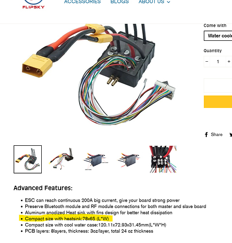

They updated the numbers on the website
I guess its something.
