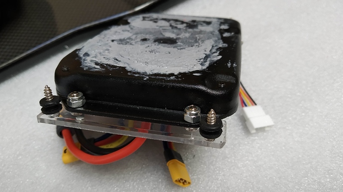

The ESC is a standard current generation low end Hobbywing 9005. It is uber reliable and totally unconfigurable.

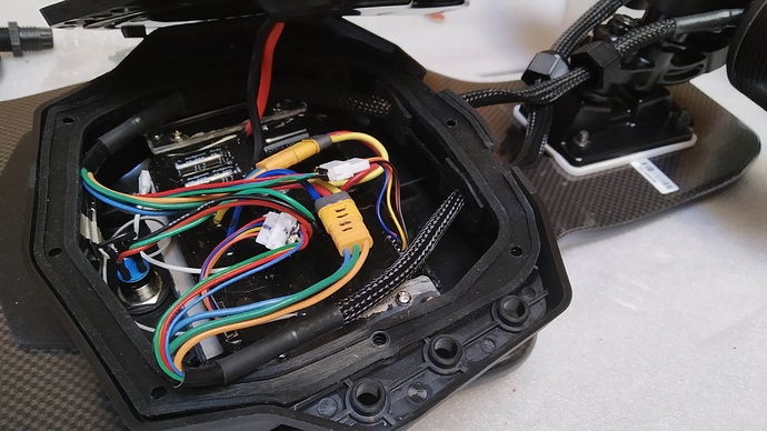

The ESC enclosure is the newest two holer. It features a full top cover, rubber seals, rubber grommets to seal the motor and power wires.
The ESC enclosure is a work of art. It also has pretty much the dumbest power switch location that favours aesthetics over function. I had to counter sink it with a dremel and use the Backfire stock switch in order to prevent future disappointments, i.e. inevitable impacts with road hazards.
The motor wires were way way too long. I noodled long and hard about cutting them down, but my laziness prevailed so I went with the “stuff it in and close the hatch” option.
The most difficult thing to do was mounting the ESC onto the enclosure. The ears were just a little too short. So I fabricated extensions from polycarbonate packaging and bolted them onto the ESC, then screwed the ESC onto the mounts with grommets from RC servos I had lying around.
Next thread the wiring carefully thru the grommets, one connector at a time. Be patient, it’s frustrating but can be done without damaging anything.
Neatly squeeze the wiring into the ESC enclosure and bolt it all closed.
I added a power extension to be able to add an outboard battery pack in parallel and or charge using the XT60.
I left the threaded connectors on, in case I needed them in the future. Again I was too lazy to cut them off. I also feared an accidental wire cut.

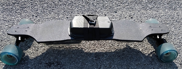

All finished ready to ride!
In its current form with two Ranger X1 batteries in parallel I have gotten 90km range at eco speeds and 70km range at group ride speeds:
