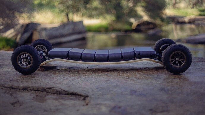

After many many iterations of this deck/enclosure (about 9, :grimacing:). we have finally developed a model that we can produce. The enclosure has been extremely difficult to develop due to the curvature of the deck.
Most enclosures are relatively simple(ish) tray style designs with no acute angles. This is for good reason, as any angle less than 90deg makes releasing the carbon/fiberglass composite from the mold a painful and mostly fruitless effort.
As you can hopefully see from the images, due to the curve and the battery segments, we have numerous overhangs in the enclosure. These overhangs caused us a lot of issues, so much so, we considered making a more simplistic design for ease of manufacture, but then it just would look the same as all the others. The curved chamber style compartments of the enclosure is a feature that makes this deck stand out. (in my biased opinion)
So we instead redesigned the mold. A mold that splits into six sections, allowing us to create the enclosure you see in the images. This mold sits inside another mold during the layup process. It may just look like a simple segmented tray, but compare it to similar offerings from Lacroix and Flux. You will notice their enclosures have vertical or >90deg angles on the sections. Anyway, I just wanted to try and explain the effort that has gone into producing this thing.
Other specs, notes…
  • Capacity = max 18s7p 21700 (all but rear compartment used for battery). I would however recommend a 16s7p setup, so you have space in both the front and rear compartment.
  • Enclosure Materials = Carbon fiber composite exterior, fiberglass interior, so non conductive, (but please still insulate everything). Hand laid. (we only have the one mold, so production is slow).
  • Each of the 5 center sections is designed to hold 3s7p battery config.
  • Deck is 9ply + 3ply fiberglass. We intentionally didn’t put any carbon in the deck, so not to interfere with the remote/receiver signal.
  • We recommend using at least a 3mm rubber/foam gasket between the deck and enclosure. (edit: now shipping with a 2mm thick custom made rubber gasket, to ensure good seal between deck and enclosure)

Fuck yes dude!!! I am so stoked that this is finally a reality!
Wow. That is a beauty, especially the enclosure. That curvature is pretty serious though, I wonder if it will cause the same kind of foot pain that trampa curvature can cause
The foot wells are modelled after the switchblade, a favourite deck of mine.
It just looks more aggressive as the the mounting tabs are at 30deg

Ah okay, maybe it’s because of the perfect side view. What’s the weight of the deck?
So is this deck the same as the MTB R1 or did the deck shape need to change at all due to the enclosure?
Where can I get this version where the standing area puts me up even higher than the hangers are? :rofl:
Weird preferences aside, that enclosure looks so damn pretty :ok_hand: I just hate everything else because too short I also love that you thought ahead about the remote signal as there is nothing more annoying than getting a new case for your electronics only to have them work worse in it.
