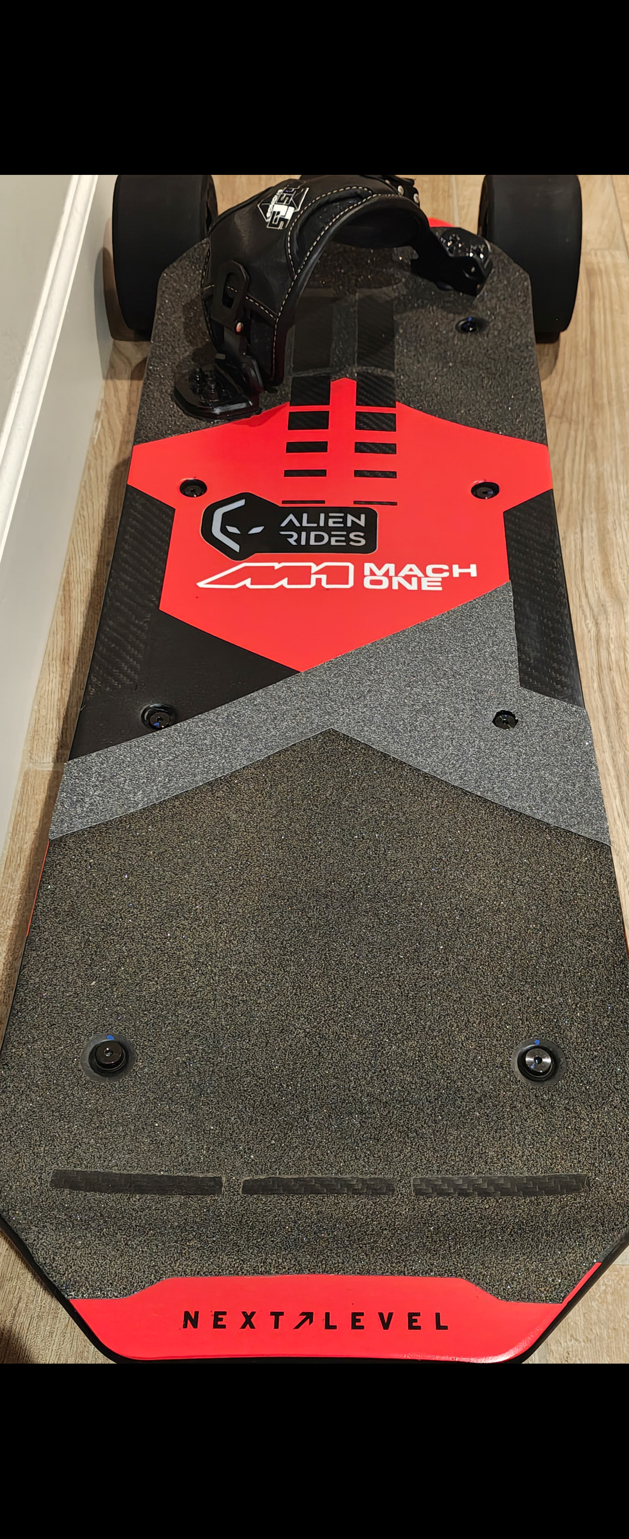

gray grip tape enhancement
Hell yeah, custom grip is about the only thing i’ll do to the m1s.
And a parallel battery port :laughing:

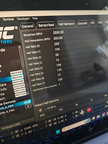

This whole time with the new motors I’ve been running sensorless without knowing it. I wondered why the stumbling on deadstop takeoff. Now I turned them on and saved the reading in settings and it start like butter​:smirking_face::hugs:. Hall is your friend, and it works. Got the wife to hop on this tonight ( no skateboard experience at all) it’s so smooth.
Liam thanks for tactfully​:face_with_hand_over_mouth::face_with_hand_over_mouth:getting me to upskill into motor controls. I just have to keep curiosity from killing me :hugs:. I got this dialed up to the 100motor amps per. Now it is near that advertised HP with headroom left on the esc and the battery. I just have to watch the temps.
