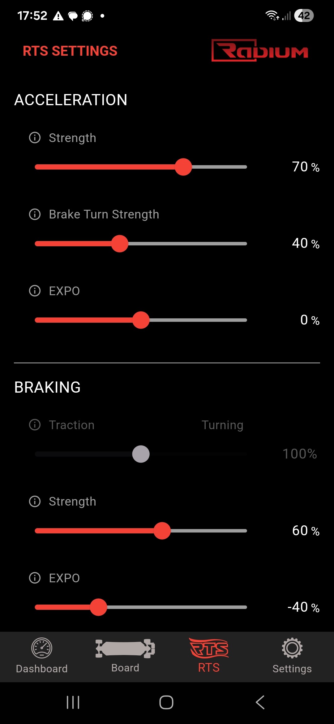

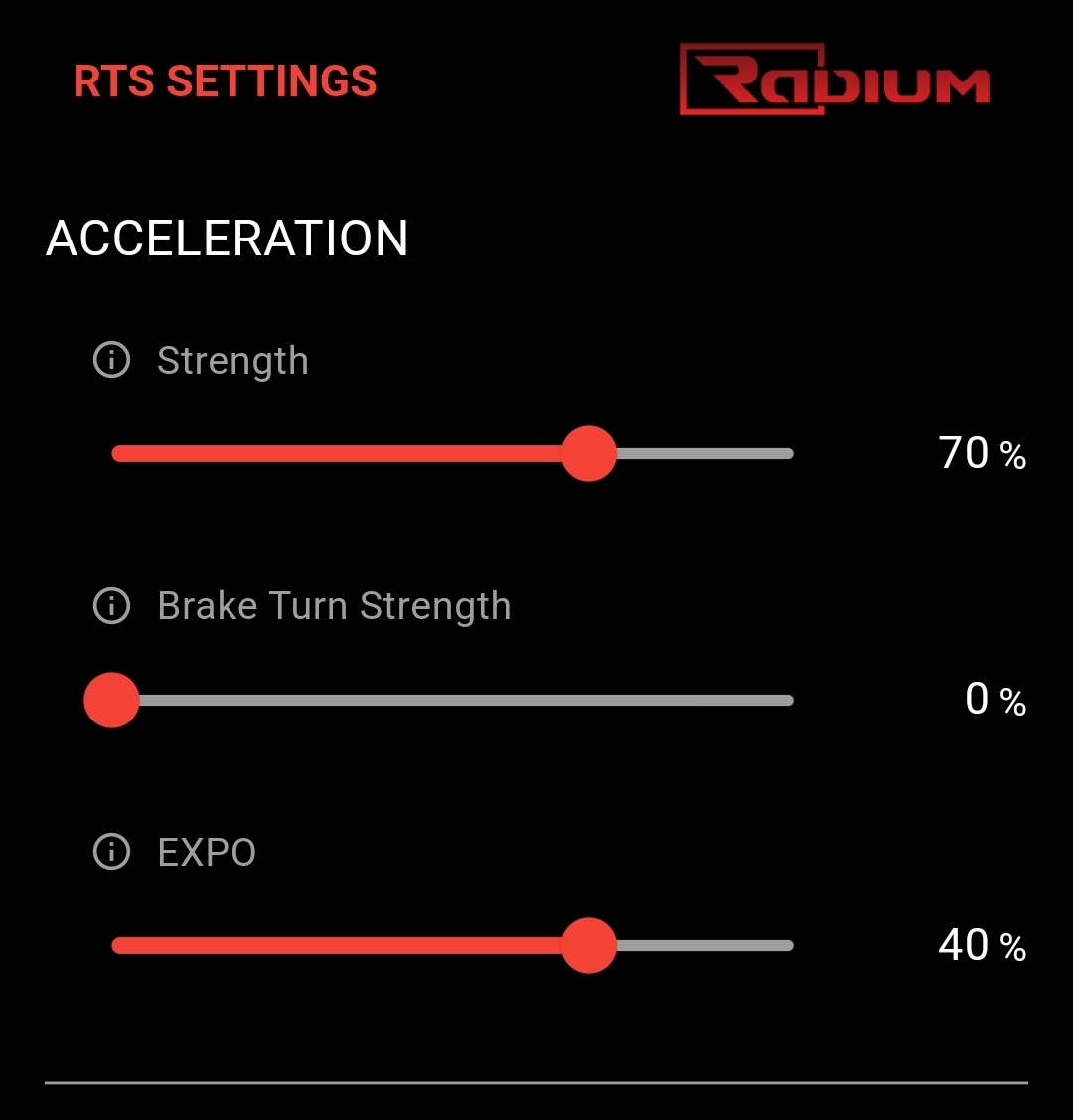

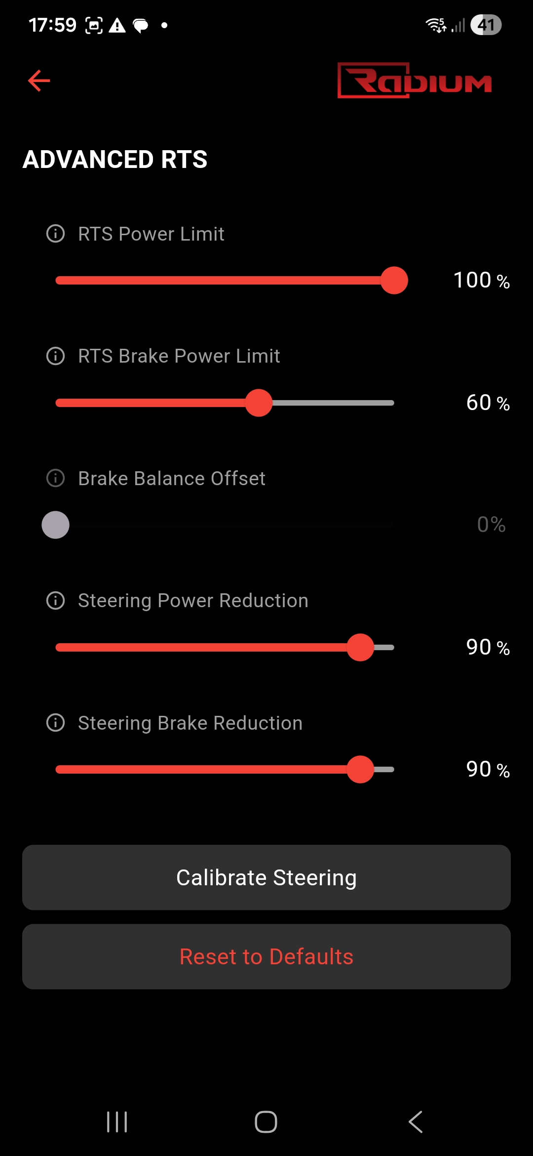

Indeed, resetting to default produced the following faulty settings:
So I set the parameters as you told me:

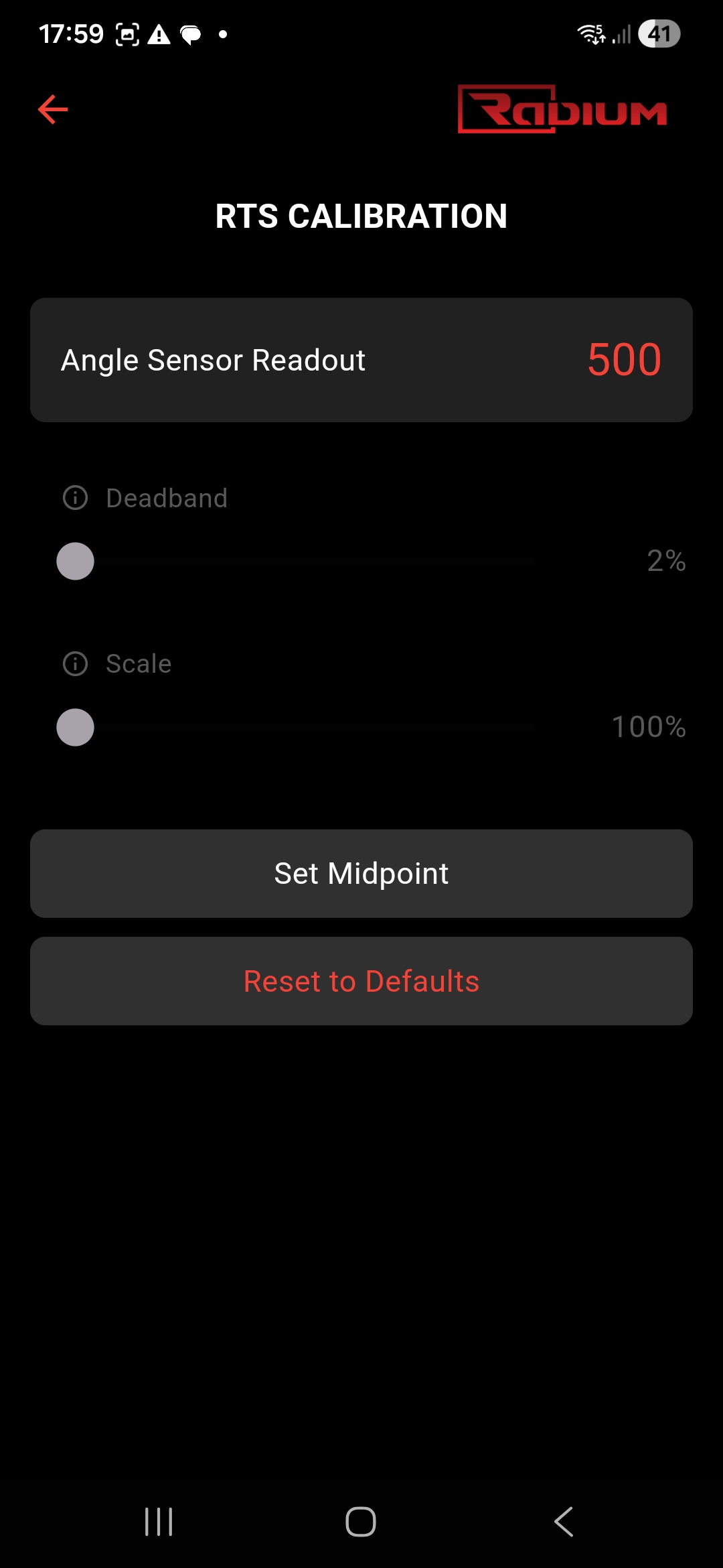

I readjusted the Midpoint. In its resting position, it shows an Angle Sensor Readout of 500 :
And here’s how RTS behaves :
I tested RTS ON and then RTS OFF several times on very tight figure-eight turns.
You can really feel that in tight turns, with RTS ON, the RTS system transforms the Mach One into a one-wheel-drive skateboard.
It doesn’t make turning easier and it creates a feeling of power loss since only one wheel is turning to transfer the torque.
On my board, I don’t feel like RTS makes carving easier. The carving is excellent thanks to the quality of the trucks and the overall mechanical design (especially the width and curves of the deck). I ended up disabling it while I figure out how to do better with it.
Is that how it’s supposed to work? When I see all the videos on YouTube saying that RTS is a game changer, I feel like I’m missing out on something, and I’d like to enjoy it as much as they do.
I’ll say it again: the rest of the board is great, and I’m completely satisfied with my purchase. I’m using it every day now. I’ve finally gotten used to the Puck. It’s well-calibrated and the braking is perfectly modulated. The battery life is amazing. I ordered the handle because carrying it is rather a hassle, but that’s the case with all boards around 20 kg with the battery under the deck.
Looks like RTS is operational on ur vid. Torque goes towards lean thus putting more power to the wheel with the most traction / weight. Helps power through turns and thus pivoting the board towards the direction of turn. It effectively pushes the board’s nose into the turn so to say in my experience so riding style and feel is not as you would with RTS off- it’s a more aggressive turning in general and as a result for more seasoned riders JMO. U can always turn it off . I have it on all the time, love the way it feels and gives me more options in spirited riding. The Mach 1 is boundless in capability on the street. I think the S version uses narrower track width in front to achieve more turn response giving that new board excellent response- thinking about it in deductive manner.

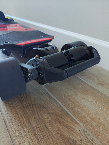

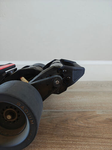

This OEM handle is perfectly integral :hugs:
Nice! I’ve ordered one for mach09 and the new mach1s
keen to compare my handle to this bad boy!
interested to see some side by side pics. Been having dreams of putting a footstop and torque block on my other Mach 1 :sweat_smile:
Will this handle design work with Mach1s?
The mounting points are the same between the Genesis, 2024 Mach One and Mach One S.
