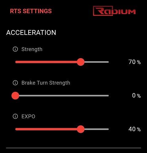

There’s a known bug in the app where reset to defaults writes the wrong settings and it causes that on/off feeling you described which isn’t how it should feel.
These are the actual defaults for acceleration:
You can also set steering power reduction to 100% in advanced settings which some people prefer.
I suggest you try those changes and if it still feels strange we should double check the steering sensor is outputting correctly across the full lean.
