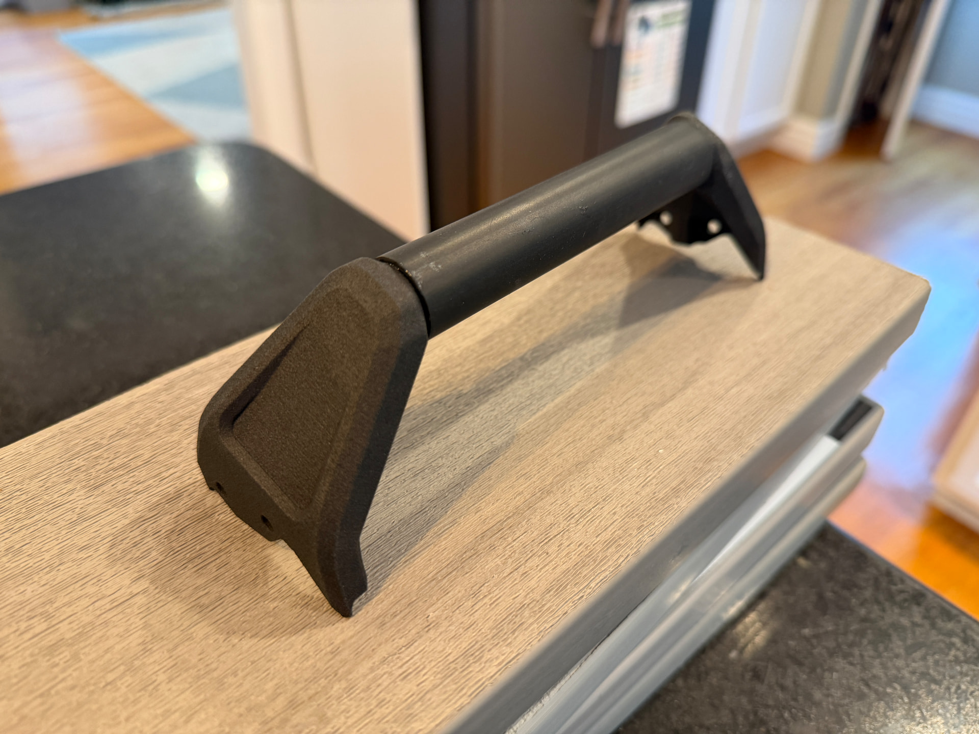

How long did you wait for your Mach One Tow Handle?
I’m waiting for mine until April the 26th…
I ordered mine April 18th and it delivered June 7th to the US. Takes quite a while
Mine isn’t that bad. I ordered a handle and some belts on June 6, they are out for delivery today (June 15).
Edit. Ta da
I’ve just received mine! What’s the purpose of the M5 washers?
The 8 mm screws are M4 and I can’t see why washers would be needed.
I assumed they were to spread the load from the shoulder of the cap head screw a little bit more
That’s what I would have thought of M4 large washers for M4 screws. But the M5 washers are strange in this case, although you must be right.
Socket cap screws with socket cap washers or countersunk head screws with countersunk cup washers will make a better job.
Not a big deal. The handle is great!
Yeah i agree, when i installed mine I had to take care to try and keep the washers centered on the screw while tightening. Might look for some m4 shc fender washers to replace them!
