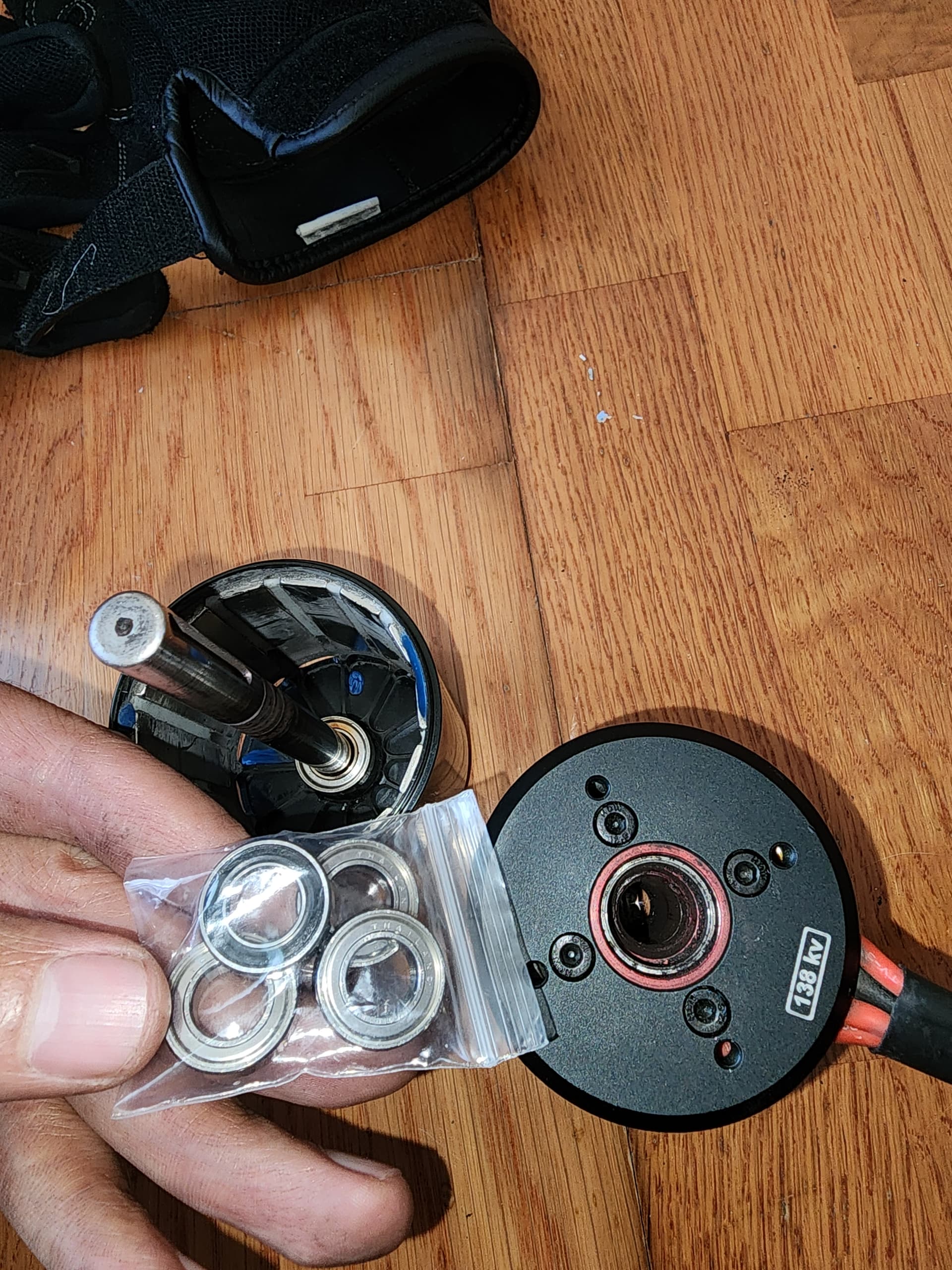

Hello! I was hoping to receive some guidance about one of my Radium motors that started squeaking recently.
I’m planning on taking the board apart this weekend to maybe apply some lubrication to the bearings, but after tonight I came to a stop fairly hard and the squeaking became way more pronounced. I initially thought my belt slipped during braking which I had never felt before since riding one of my older boards. Luckily I wasn’t far from home so I just walked it home a few blocks
Just hoping if there is any feedback or anything I should order ahead of the weekend which I’m fairly certain my walk of shame had me convince that the bearings or kaput.
One of the things that attracted me to these motors that the bearings were swappable?

G’day Patrick.
As soon as you said “squeak” bearing was my first thought too.
Here’s a video I just uploaded to show how to change bearings its pretty straight forward:
And link to replacement bearings:
I’m interested to know how you go. The only bearing I ever busted was a hybrid ceramic bearing that somehow got mixed in with the normal steel ones from the bearing supplier.
So if you find a seized bearing and pry the cover off, and notice that it has black balls that would explain the short lifespan, assuming it is a bearing failure.

Thanks a lot! Appreciate the expedite! Bearings just came in today, although I’m pretty spent trying to get the motor can off without taking the enclosure apart and disconnecting the motors entirely from the board.
Taking a break and will try again later when feeling returns to my hands before I disassemble the board :weary:
I managed to get the motor can off but not without difficulty. The two inner bearings including the black one failed and the white adhesive stuff appear to be worn down maybe from heat over time?
Just sharing my observations before I swap out the bearings. I cleaned out the debris and buildup with Isopropyl and Q-Tips so far.
I think the loose balls from the bearings was what was giving me such a hard time getting the motor can off.

Shaft looks chewed
Literally what I told @BillGordon last night :face_with_monocle:
I tried revisiting this this weekend sliding the new bearing over the shaft and there is no give. Tried using one of the good old ones to avoid damaging the new bearing using decent force but still same thing.
Probably find some lubrication and maybe apply some heat but seems excessive to replace bearings.
May explain why there so much resistance sliding the motor CAN off which was no way as easily as you demonstrated in the video you shared
Did you hammer the end of the shaft trying to get it out?
If so, file down the edges, steel tends to mushroom instantly when smacked on the top.
I managed to get it off and sand the shaft down a bit until the replacement bearings could slide in the shaft with ease

Yeah without the shim washer the circlip will rub on the bearing face and melt the shield. The motor will also rattle a lot.
Do you have any old motors you could steal a shim washer from?
I looked at my old Lacroix motors just now actually and the ring is kinda built-in deep dish design that kinda offset the c-clip if that makes sense
