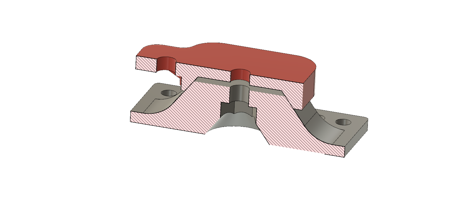

For the first time in my life I wanted to mount a camera on my board, but instead of making something dedicated for the one I have, I designed something modular which is a neat solution for all kinds of stuff.
I just love modularity.
I wanted to solve the opening/closing of the same 4 bolts for different stuff that you want to mount. Now putting new things on your board is trivial, and secured.
So, what are we talking about?
One piece that is mounted on your board, with the standard truck bolts pattern. This one has an inclined surfaces, it the shape of pyramid (with 1 centered locknut).
The second one is mounted on top. All is required is one 1/4" bolt , to secure it in place. Because of the inclined surfaces, the connection is sturdy, prestressed and centered. Very neat.
To unmount, just open the same bolt, as simple as that.
From the stress/contact surface pov it’s really neat what goes inside there, I will do a post about it in a week. For now know that this works, and nicely.
Now, for the best part, just design something for your purposes and secure it with the same bolt, as simple as that.
I’m adding some pictures, and will put it on thingiverse in the next couple of days.
But for now, just collected opinions and remarks, so what do you think?

I can do M8 version, not a big deal.

What is the diameter of the base? Right above the bolt. And the length of the bolt?
this looks like a lot of fun :slight_smile:
Thanks @dani, the diameter of the base is oversized, to provide support on a typical foam/fibreglass windsurf board, and it doesn’t really matter if it spills over the sides of the mount, provided there is still a decent contact patch. The efforts when windskating are much smaller. I really don’t want you to alter your great design for that, apart from the M8 nut thingy. Length of the bolt is about 30mm, and I can shorten it to suit if I don’t have the luxury of a truck baseplate cavity to cater for the excess.

I’m not home this week, will do it over the weekend. Meanwhile if you can find the dimensions of M8 nut it will help.
Thanks, and looking forward for you to use it!
here are the dimensions for the M8 nut, in mm
The diameter of the plate is 125mm, and the protruding bolt is 20mm long (or 24mm without the hard foam padding on the plate)

That’s everything I need.
The pyramid mount is on Thingiverse
