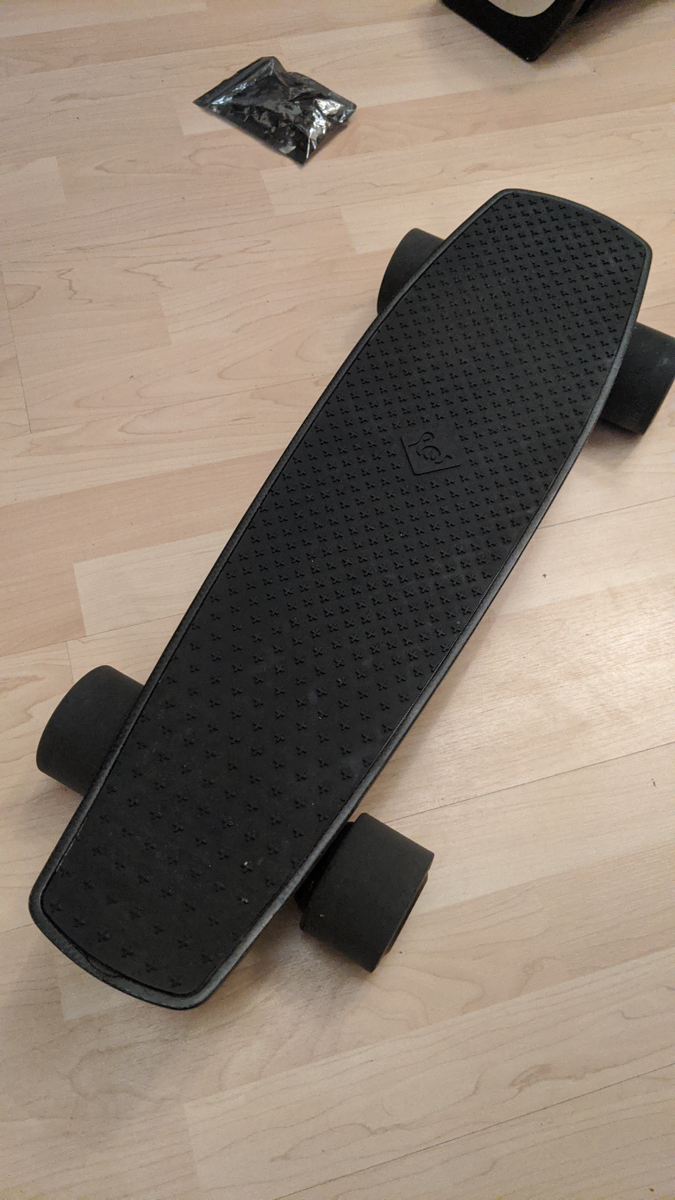

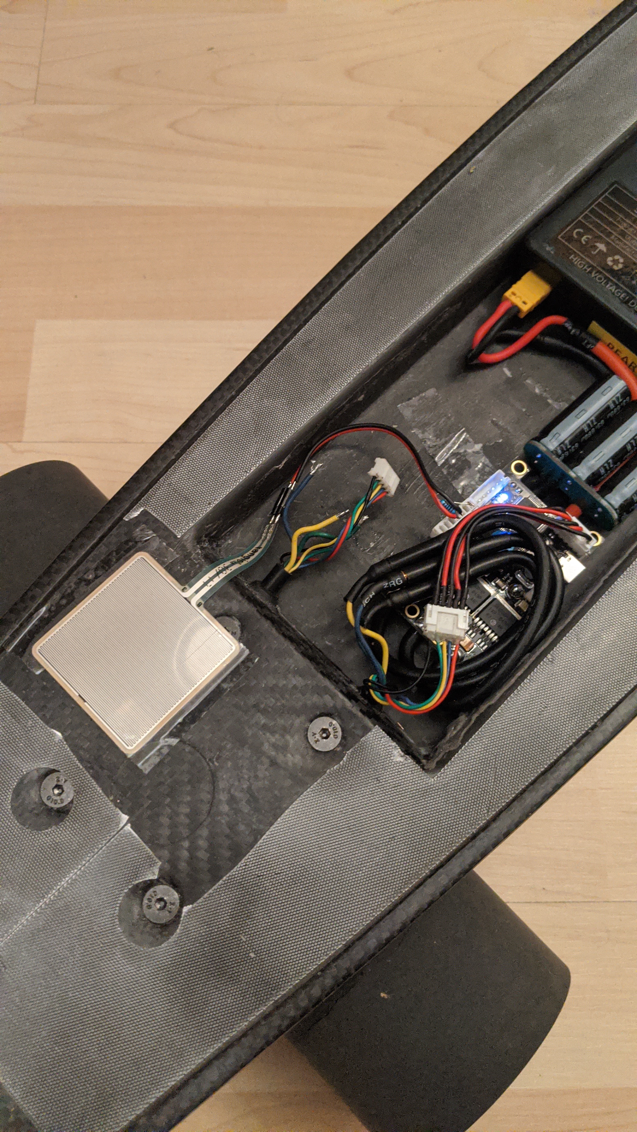

Aight, got some progress to report:
Here are pictures from the board and the setup, including a simple pressure sensor.

I am thinking about adding a symmetrical second sensor to avoid issues while balancing in turns.
After spending a few hours trying to connect an arduino I ended up programming the VESC itself, here’ s the code on github: /dakhnod/bldc/blob/master/applications/app_kickassist.c.
