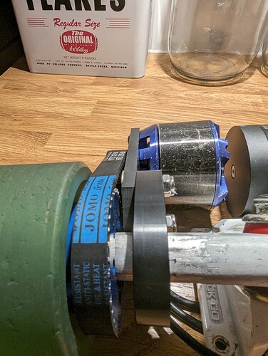

Anyone know where to get good pulleys of this size for those wheels?
I have one old from the enertion motor mount kit from 2016 and need another to match… But it seems pretty much impossible to find a decent one.
Needs to fit Caliber ii truck. Preferably metal.
Anyone know a good source or have one to spare? Thanks

I don’t know. I guess a non bolt on plastic one could work too as long as the size is about the same. I’m just a bit skeptical of plastic pulleys braking 90kg of mass traveling in 40 km/h.

u will run out of axle length if u don’t use bolt on pulley and push the motor mount further towards the middle
honestly a set of BN184 hanger and motor mount run u about 130bucks, the extra axle length allow u to run pressfit bearing pulley which is way better than bolt on imo
If you go this route I highly recommend getting the BN pulleys as well. They make aligning the belt and keeping it aligned so much easier compared to bolt on pulleys. On his hangers there is just enough axle to fit everything on so no need to mess with spacers either.

Really need it to match dimensions of the enertion one as you can see :joy::joy:

Have this one, can lathe down to specified thickness for you for free. Just pay shipping.
Also have one thats 9mm here cannot add more material for ya. If you can measure pulley thickness for me that would be cool!
Nexusboards has metal abec pulleys, but 16 mm wide
That first one is interesting. Here are some measurements from the one I have (just took all I could think of :joy:)
