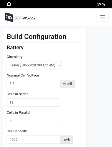

I’m getting pretty substantial differences between the 3ds and esk8 news calculator.
With 8" tires
18wh/km average
12s6p p42a
15t/72t
I get 28.8km range on 3ds and 57.6km on esk8.news.
how? wtf?
I have the same issues, not only with range but I’ve had up to 30km/h speed differences between the two as well.
Methinks one of the two calculators is broken somewhere.
I’d like to know as well
Speed is also weird on 3ds. It has speed average which is almost correct (i get a real world max speed of 52/53km/h
But then it lists the other speed tab. Which 67km/h max and 61 loaded
Whoa it doubles range exactly
I only ever look at the average speed (loaded) and it’s always been pretty damn accurate for me.
Range also seems to be real world accurate for me.
I’ve never used the esk8news calc cos it looks gross and hard to read
I think the news calculator might be more accurate range wise.
I was getting 20-25ish km with a 12s1p 12Ah lipo setup that has 550ish Wh.
The p42a pack would have roughly double the Wh
I believe the min speed is what you can get at your lowest voltage, and max speed is spinning wheels up at full voltage.
Dunno what those other ones are tho
Just like me
Is there an option for wh/km on esk8news? Or does it default to 9wh/km? That would explain the double value
Edit: just noticed in the screenshots. Esk8news doesnt specify if wh/km is for one motor or the whole board… i assume its for the whole board
