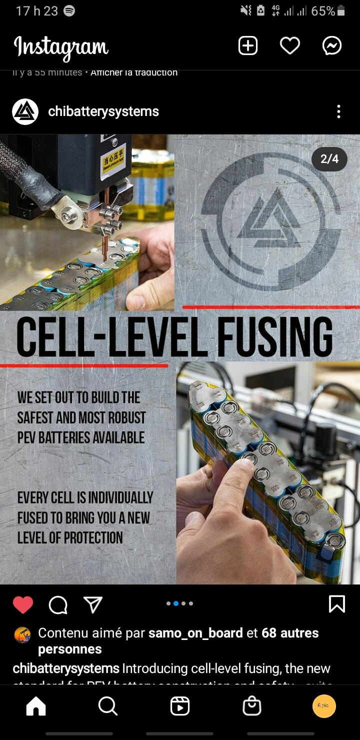

Little tiny wires welded to the cells that act like fuses if a cell goes rogue
I just checked their Instagram for the first time in a while and it seems like they made some advancements. Still not up to date with the build standards here but definitely better than a few months ago.
I still don’t really like the cell level fusing. I guess it will probably be fine with the onewheel packs since they draw relatively little current.
Batteryhookup has the same sort of nickel that’s ā€œfusedā€ for sell
But like @JoeyZ5 said it could cascade and be very dangerous if you end up with no braking
I’m torn when it comes to esk8 cell-level fusing.
If a cell shorts internally and there is no fusing then it will take out the all of the cells in the p-group. I’m ignoring any possibility of thermal runaway for now.
If there is fusing (and it blows) then the remaining cells will be stressed harder but not nearly as hard as they would be without fusing. Yes, this p-group will drop its voltage faster than the other p-groups but not as quickly as feeding a shorted cell.
Both scenarios result in a dead p-group but the fused p-group will not be feeding a shorted cell (increasing the possibility of thermal runaway) and will probably drop its voltage slower than a shorted p-group without fusing would.
If you notice the issue and stop then the blown fuse will prevent any further problems. But without fusing the internally shorted cell will still be fed the energy from the entire p-group and that’s a real good way to force it into thermal runaway.
But I have a concern with the Chi method of fusing…
The fusing elements are free to bounce and vibrate. I’m wondering if metal fatigue could become an issue?
I’m curious, does cell level fusing make any significant increase to pack resistance or voltage sag?
