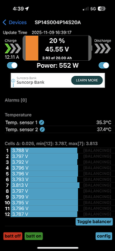

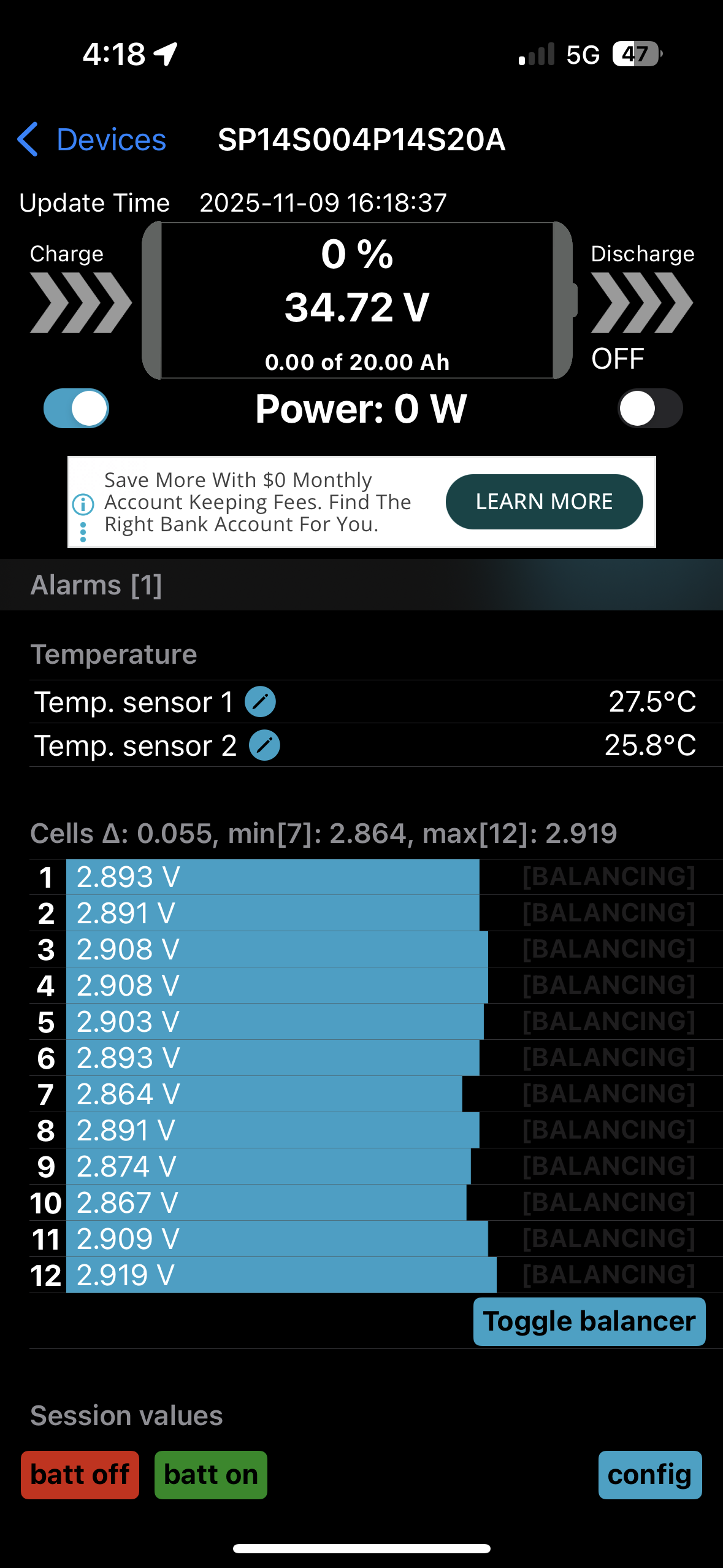

So how big is the battery in there and if it doesn’t to 40v how long will this top it off?

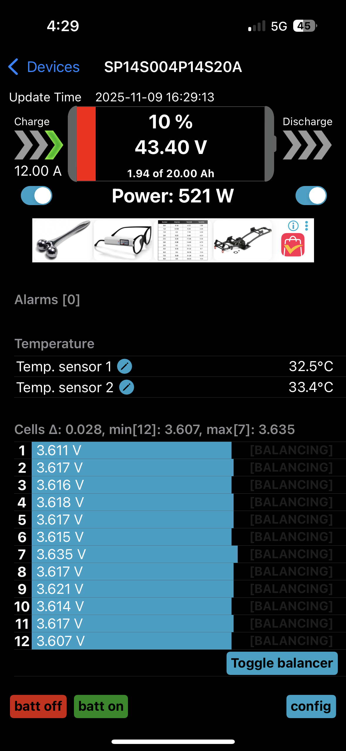

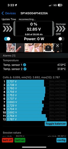

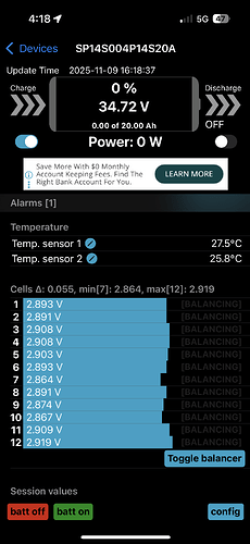

I built a little scooter off of a Razor Pocket Mod because of @monsterbuilder
Battery is 12s6p p42a
Currently getting it as low as i can so that i can science a 0-100% turbo charge
Less resistance for the charger bypassing the BMS.
I like lowering my target voltage to about 4.15vpc when charging at high rates.

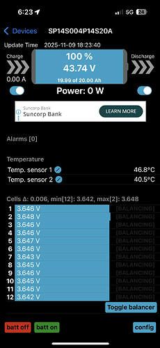

We’re fully milked. Gonna let the pack cool down a bit, then it’s time for turbo juice science.

the chargers will cut off when the current from them slows down to some threshold. (typically)
so the two chargers together could:
A. stop together, a little bit earlier than full charge. (probably negligible)
B. one stops because it’s low current threshold is hit first which gives more headroom for the other one to keep going til done.
I think B is the weirdness you’re asking about. and I suspect it’s more likely.
details:
  • The chargers limit current and voltage all the time. it results in cc/cv but you can think of them as just limits.
  • while the current flows it pushes the voltage up relative to the amount of current. more current more voltage rise.
  • total voltage with the charger attached is the SOC voltage of the cells + the voltage rise from the charger current .
  • when total voltage is < 4.2v/cell the charger puts out it’s max current. (CC mode)
  • when total voltage is > 4.2v/cell the charger’s voltage limit kicks in (CV mode) in and current is ramped down as the cells SOC rises. note, it slowly ramps down current keeping the total voltage close to 4.2v/cell lowering charge voltage rise as the SOC voltage increases.
  • typically chargers stop when this current drops below some minimal level. importantly not based on voltage, which is hovering around 4.2v/cell ever since it hit “CV mode”.

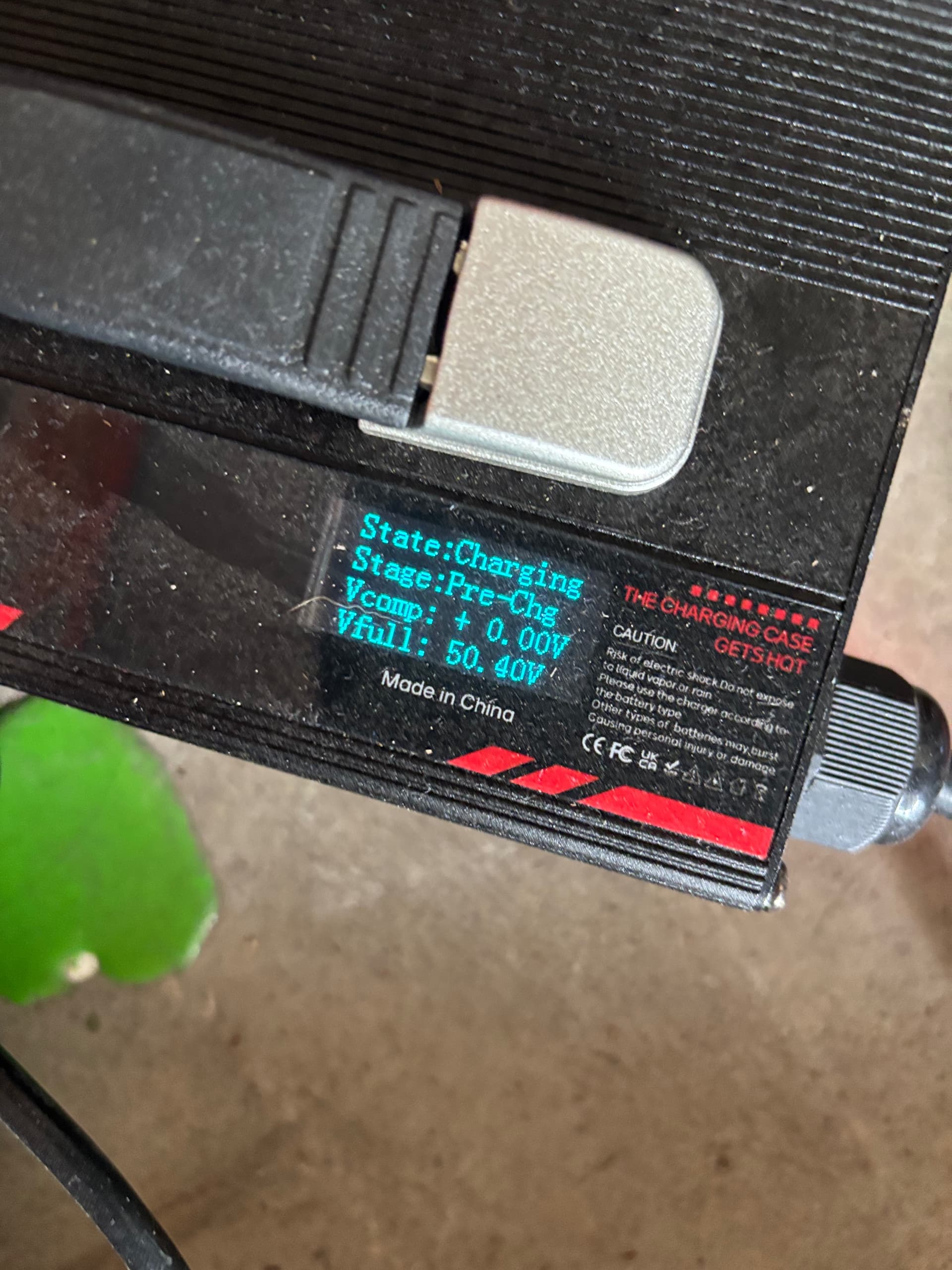

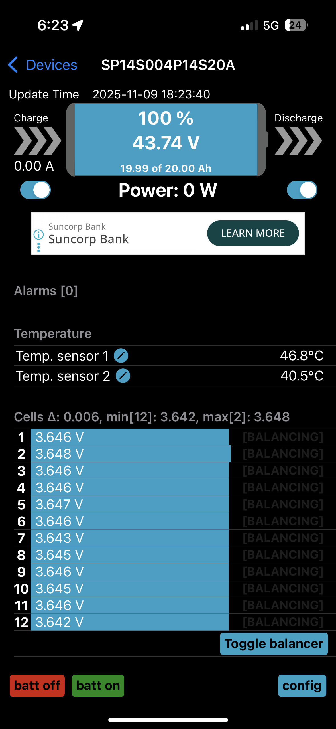

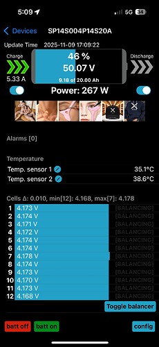

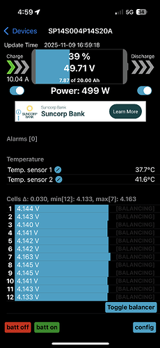

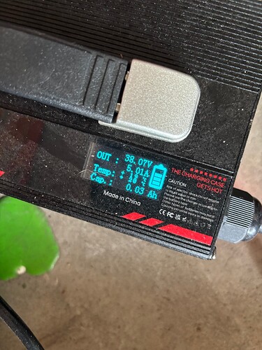

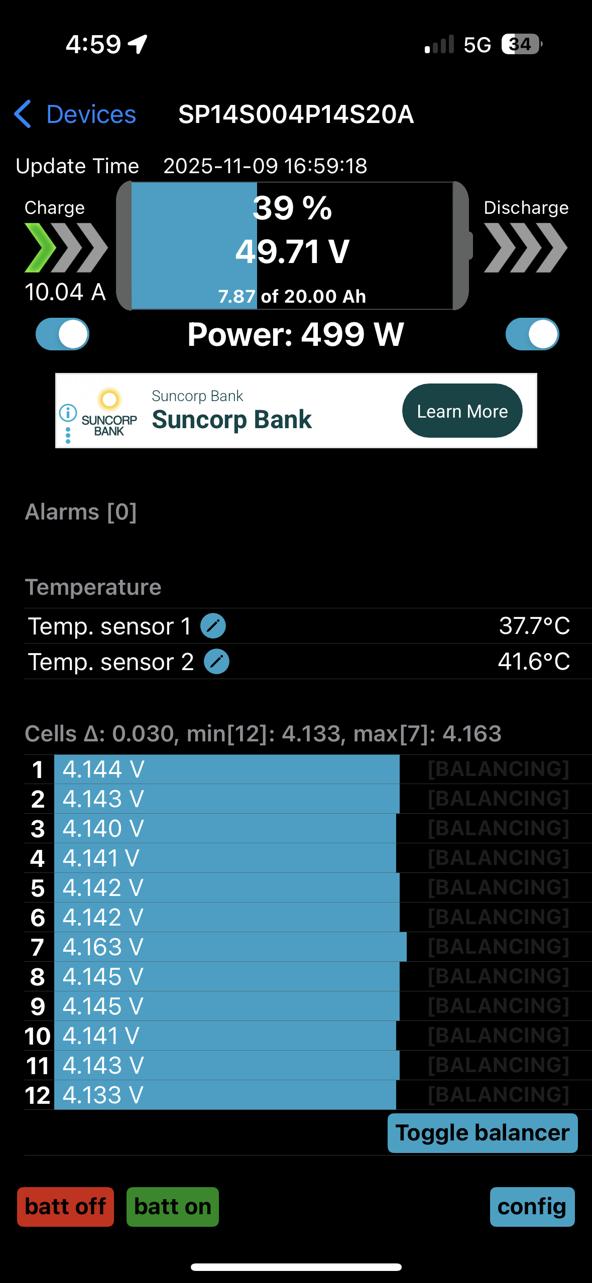

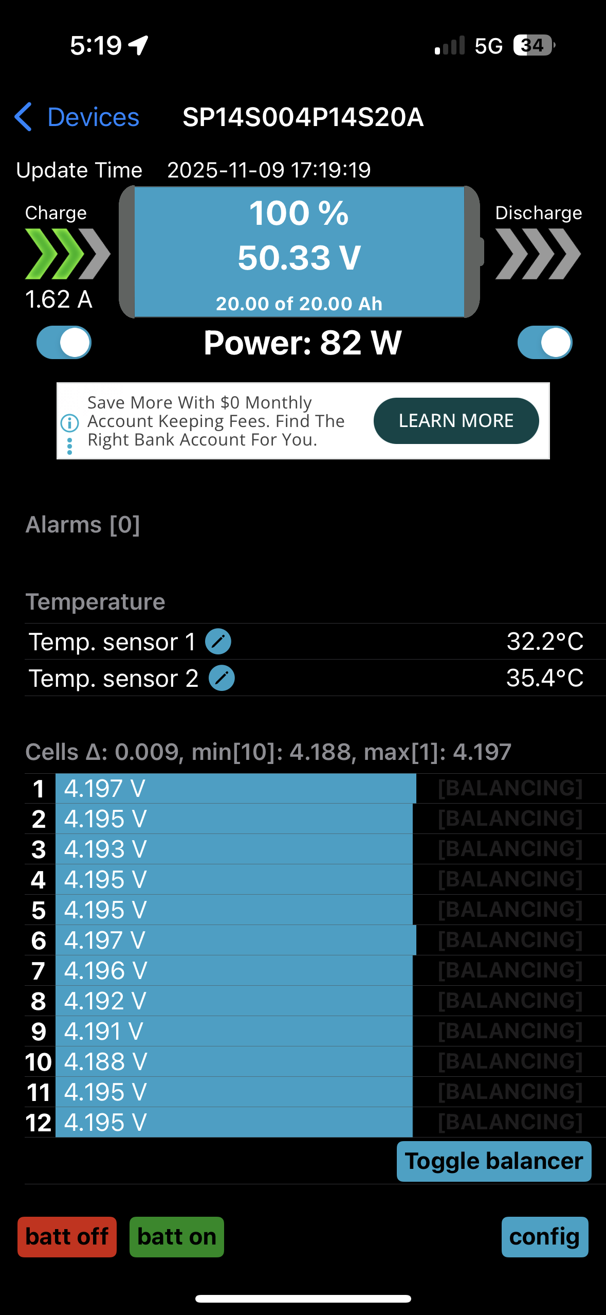

This 20a charger is kinda cool and respectful of the battery. It ran in ‘pre-charge’ mode at 5a until battery hit 40v and then it ramped up to the full 20a.
A whisker over 1hr from 0-100% :partying_face:

Just took the mach for a somewhat spirited ride and battery temps look higher after the ride than they were after the turbo charge, so i’m feeling pretty good about that.

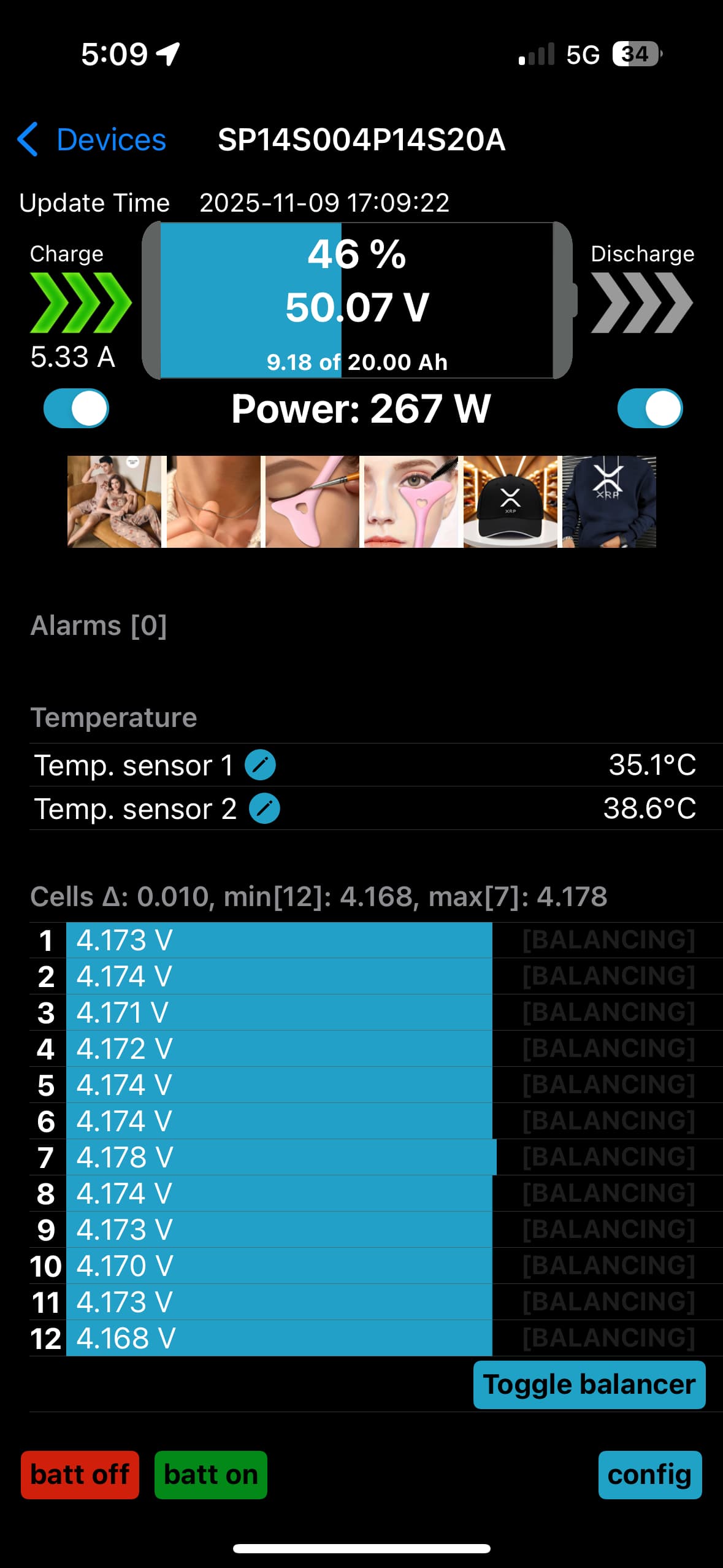

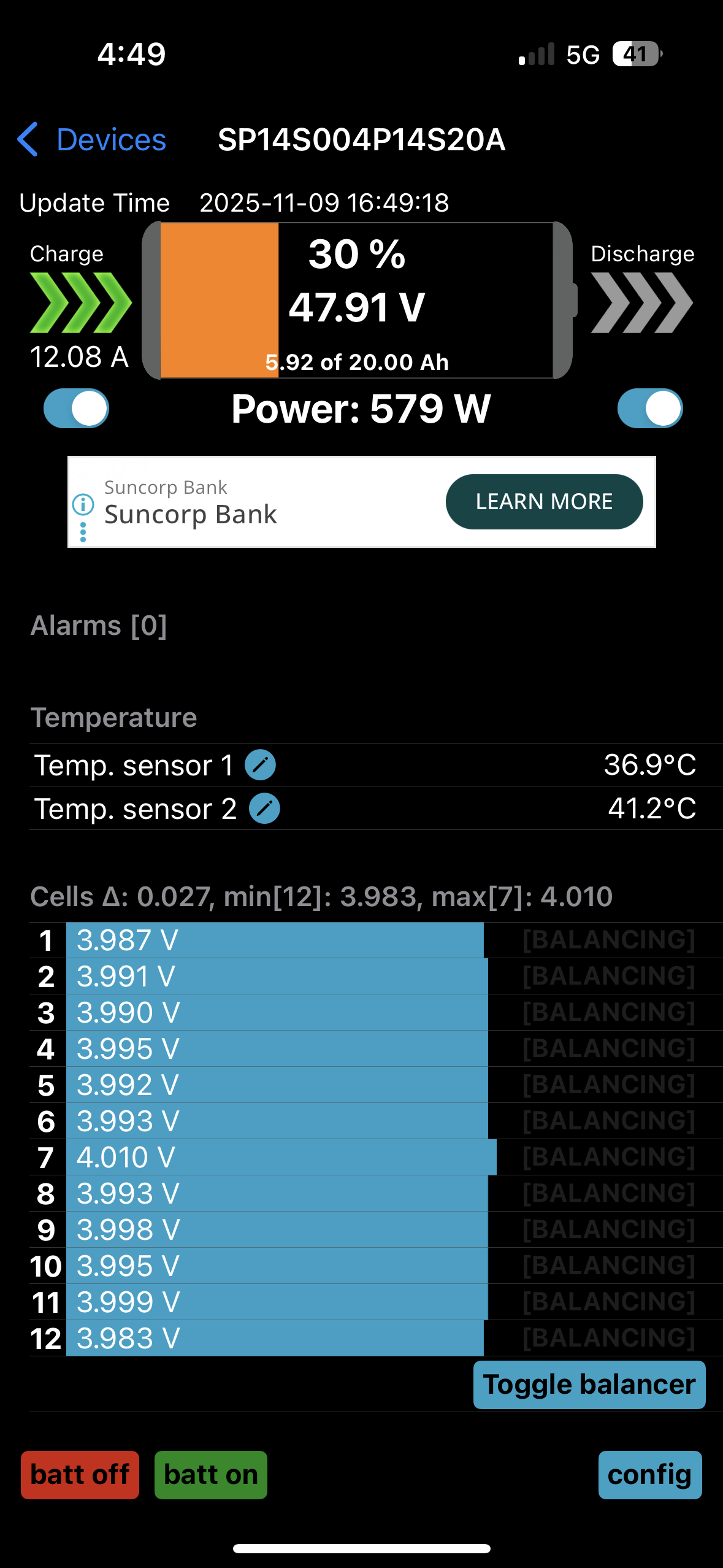

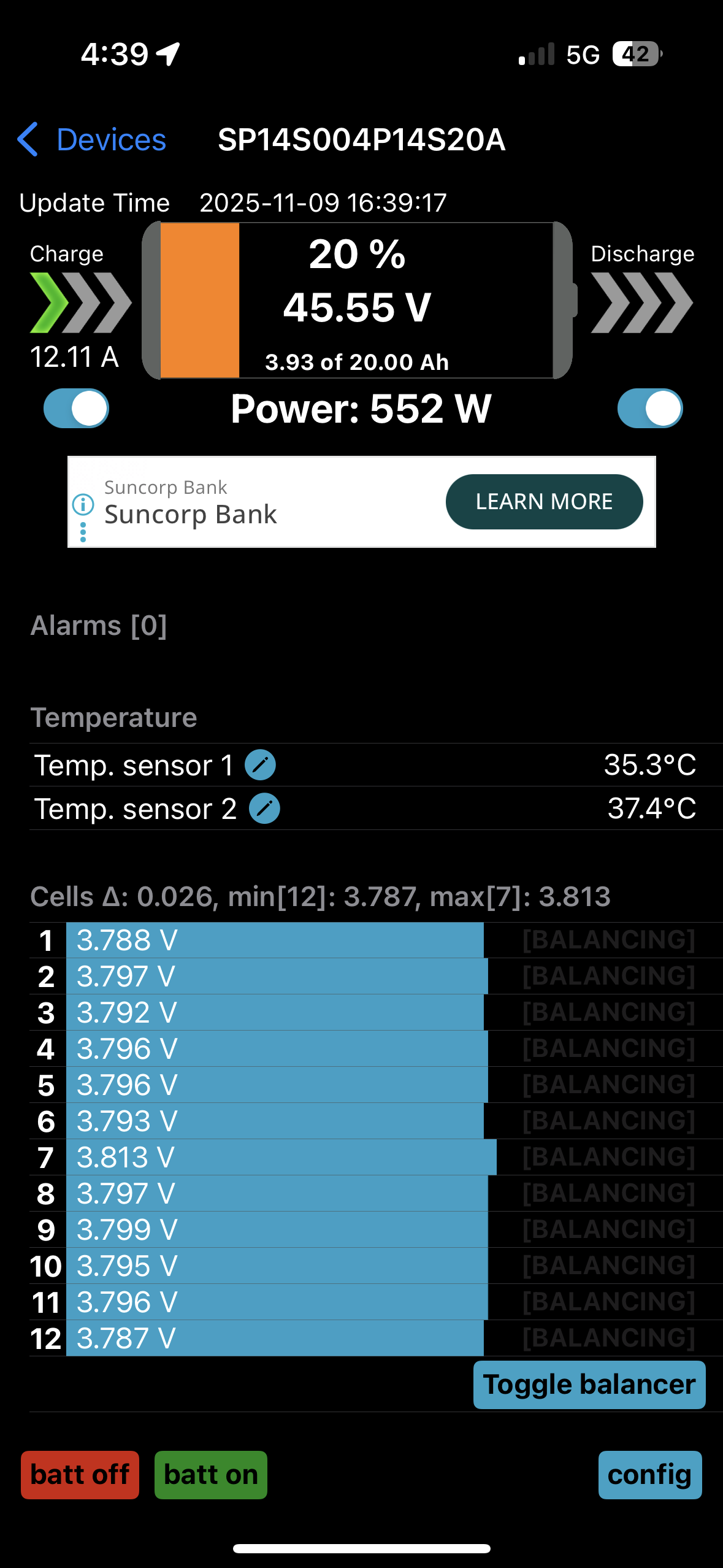

I didn’t heed my own caution when i did the turbo charge and rather just observed VERY closely what was happening at the top of the charge.
Interestingly, the 20a charger went into CV mode well before the 12a charger did and also lowered itself to a more conservative current than the 12a.
The 20a charger was the first to switch itself off, at around 50.2v (at the bms). As soon as it turned off, i disconnected it, but there was no sign of anything fucky happening.
