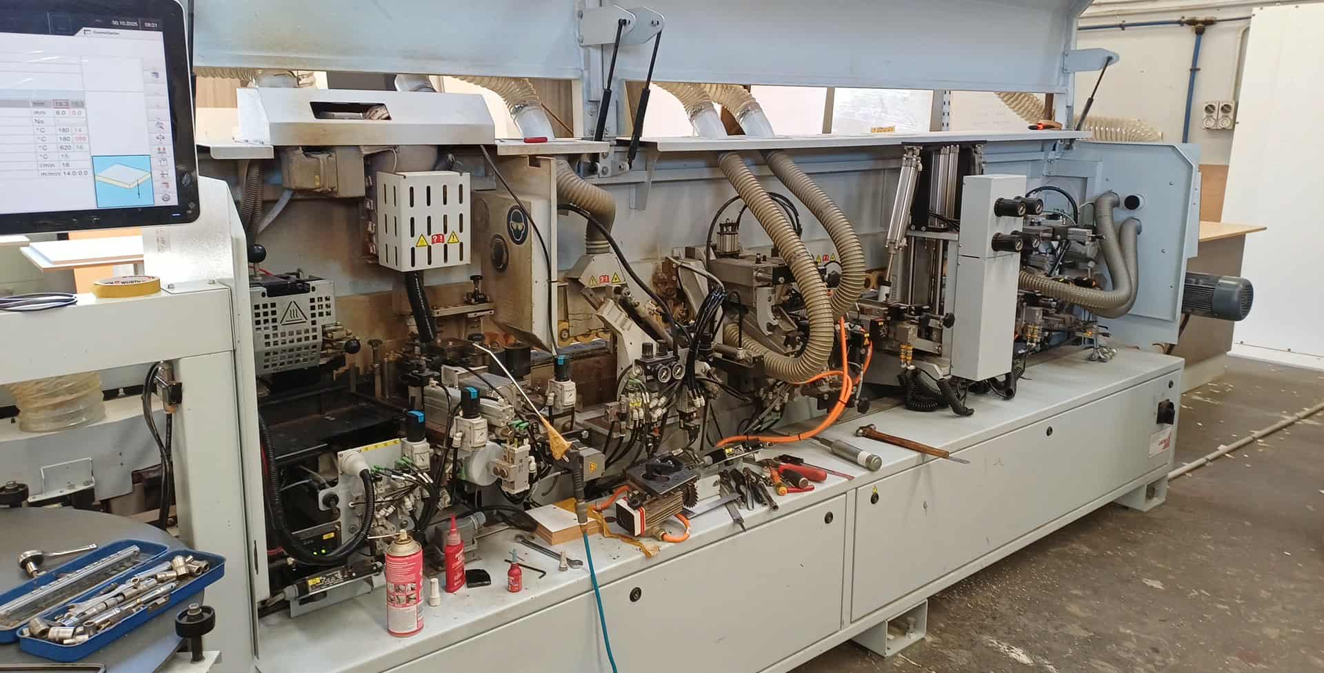

Nah, read switches and /or proximity sensors on pneumatic rams etc to feedback that they have got to their position. Easiest example is on the dust hood of a CNC router. In this case, the machine needs to see the dust hood is open before doing a tool change to prevent collision. It doesn’t take much for read switches (magnetic, on the rams) to fail or need adjustment.
I spend literally my entire life servicing and fixing machinery, mostly CNC routers and edgebanders in joinery shops but also classical machinery like planers, setting up table saws and the likes. Past life was industrial electrical with a lot of machinery alterations to bakery equipment and breakdowns but also many other industries.
Most electrical faults I just leave the meter on AC volts and if the contracts are closed the induced voltage fluctuating on the screen drops to zero. Don’t even need to take the time to understand the circuit or applicable voltage. If that doesn’t work, I apply more effort.
This is an edgebander, I spend half my life servicing these now:
