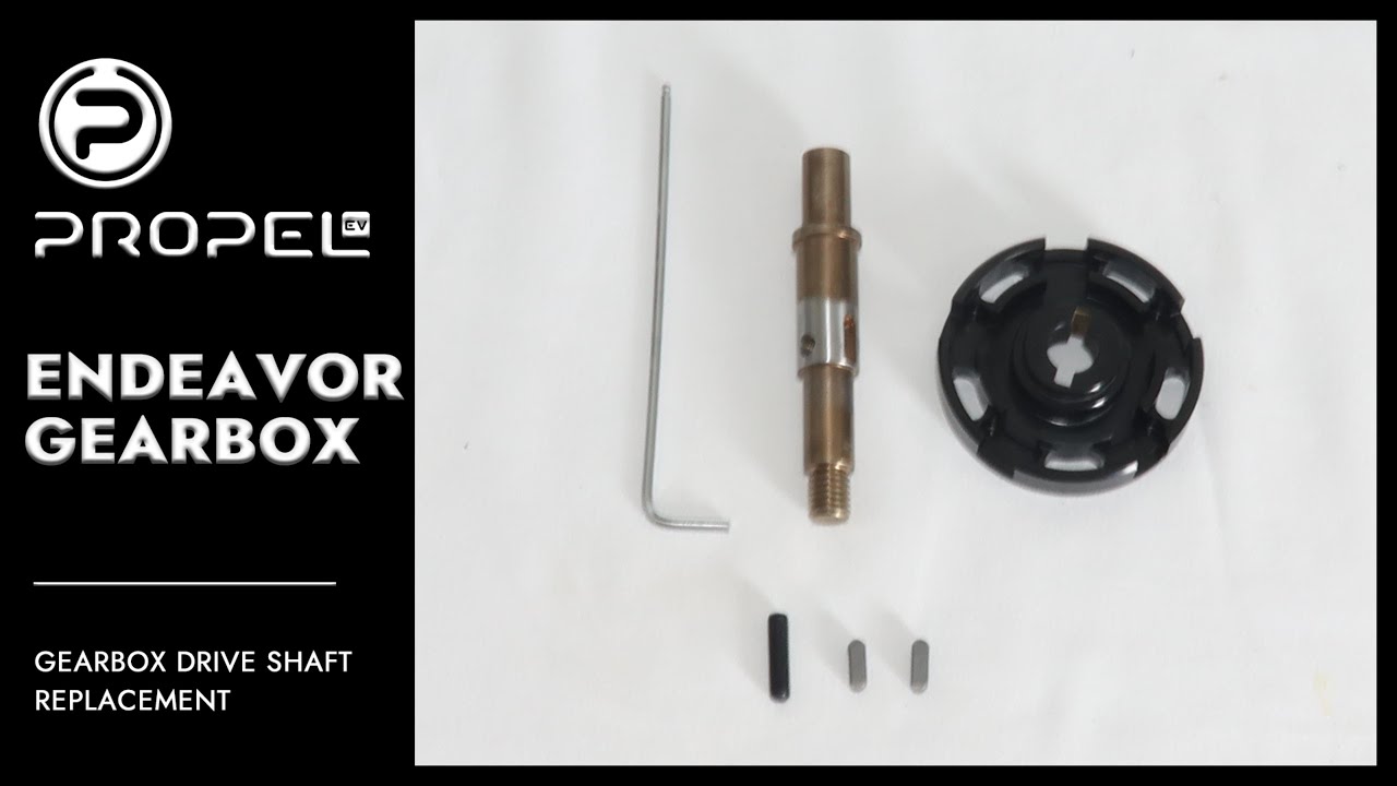

I still haven’t taken them apart, but here is a little bit of Gear drive ASMR for you guys. Keep in mind I’ve drained the oil out of these.
Ohhh good they have a teardown video on their YT channel.
I wonder if your wheel gear has some damaged teeth
One or more of the gears surely has to…
I noticed it happens about every 5-ish turns, and it’s a 5.33 gear ratio, so makes sense. The binding (grinding?) happens twice in the span of 10 turns, the first bind is not too bad, and the second is really bad. I thing 2 gears are messed up and the messed up parts from both gears lines up every few turns…
You can hear it in the video.
