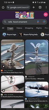

I am super curious if anyone has taken after car culture with hood ornaments? A la hick town trucks or rolls? :rofl::sweat_smile::rofl::sweat_smile:
I figure a mountainboard could use some horns and say a skp mag, could use a rolls ornament on the anti sink :rofl:
Or some kind of duck creature :rofl::sweat_smile::rofl:
Something like this ?
I am very jealous of the dickless duck handles :sweat_smile::rofl::sweat_smile: but im more so thinking if you took the centre cutout from that and stood it on your anti sink like that hung duck is riding with you?

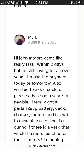

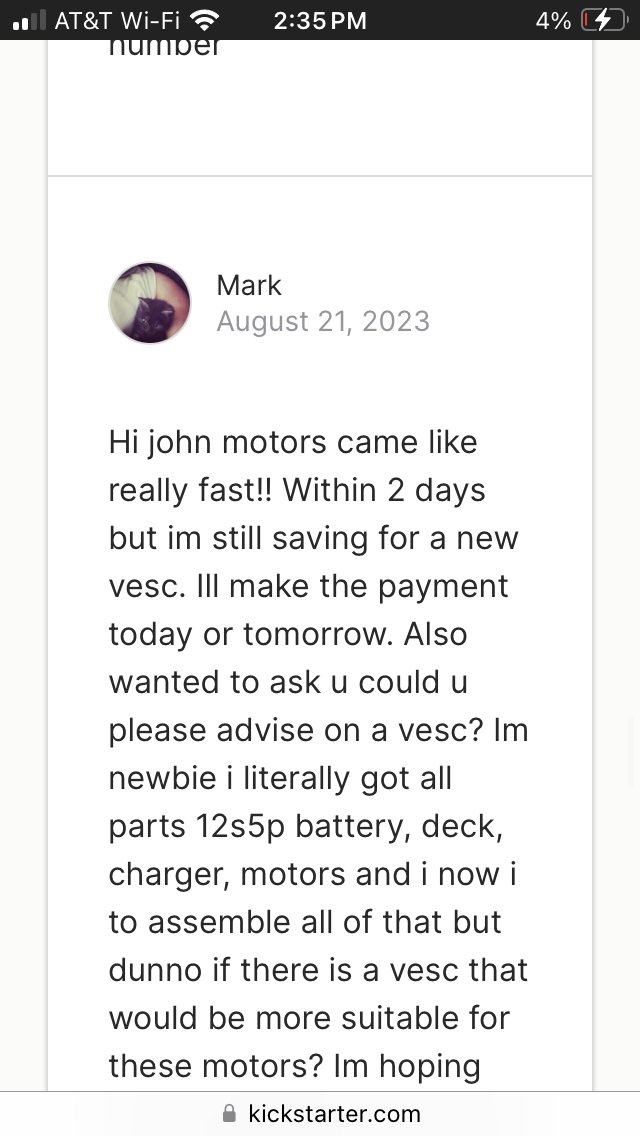

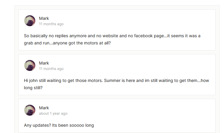

@hummieee
did mark ever receive his hubs?
