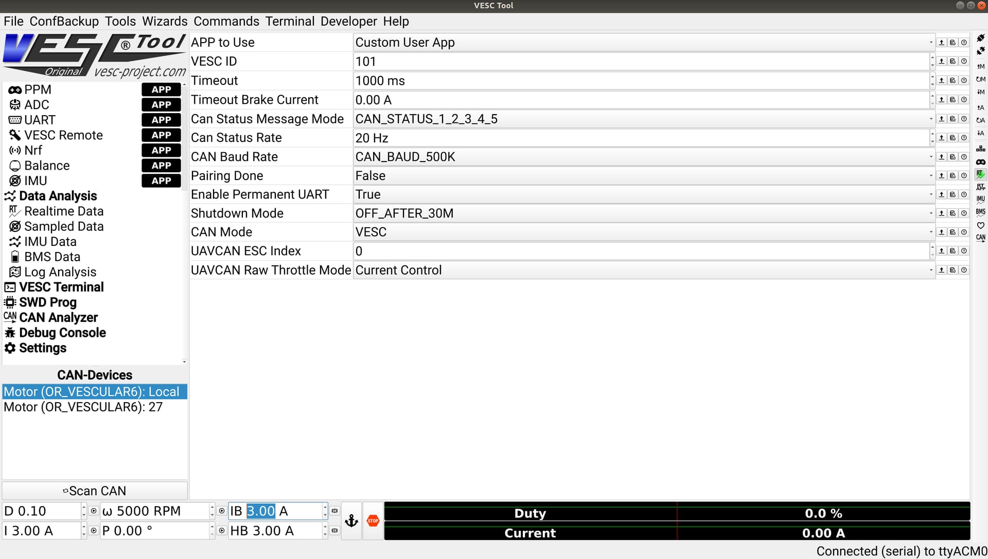

Say im riding, and my internal hoyt reciever somehow gets unplugged/disconnected - what would happen to the board? would the wheels lock up or continue coasting with just no remote control?
Trying to better understand what occurred that left my friend unconscious after the board tossed him off; its what the witness said - but im thinking more of a wobble/slip that toss him off, he doesn’t remember anything of the crash.
althought today I inspect the board and first noticed the hoyt puck wasn’t even pairing to the board…weird maybe its damaged from the fall - i try another remote and same issue …ok so receiver problem. I open up the enclosure and do it all again - still no pairing.
I hot glued and strapped down all connections very well… I pressed my finger against the hoyt puck receiver that plugs into the stormcore, and got it to pair with both remotes… Examined the cable and everything looks great, just how I last left it. pretty frustrated that this happened…

Depends on how the VESC is programmed. I think the default is to apply a -1A braking current if it loses connection after a second which isn’t much, but the unexpected jerk going from acceleration to braking or even coasting can feel sudden and throw someone off.
Where would i check for this setting?
So it sounds like it probably did chuck him off. He told me the board also wasn’t very far at all from where he landed.

Should be on this page or thereabouts, the Timeout settings, assuming VESC tool doesn’t look any different today. I haven’t gone back in there in a year and I pulled this screenshot off Google
Almost always coasting
