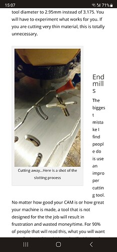

Im looking at building an MPCNC and was trying to see how capable it is of cutting aluminium so i can make some motor mounts and other custom bits later down the line. Look at what i found! @Boardnamics
@BillGordon is this a can of worms that is not supposed to be opened? I thought it was a very promising company :thinking:
Yup, he got his start on an MPCNC!
I built one, and used his guide for cutting aluminum. Overall it’s pretty good in wood, but slow in aluminum

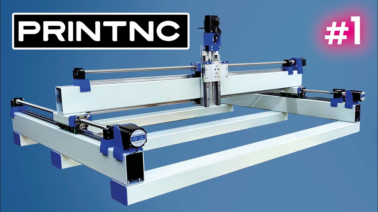

Check out the PrintNC. It’s in a league way above the MPCNC in terms of speed and tolerances, and can still be built for around $1-2k.
It is a Voron level build project though
Ooh I’ll definitely look into that, looks like a solid machine
