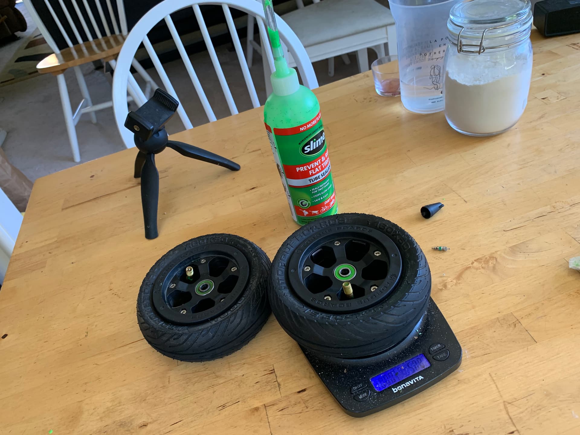

I filled my Torque boards Pneumatic wheels up with 50g slime today. It did NOT balance the vibrating rear wheel at all. And now i have a tire filled with slime that is impossible to balance. :expressionless:
Nice. :smiley: Also I doubt slime will help with a puncture in such small tires.
My approach to balancing:
  1. buy extra tires, some will be oval
  2. mount on rims, bin out the oval ones, they will never balance (some sideways wobble is acceptable)
  3. gravity-balance with weights, use bearings with seals removed and light oil for best results, doesn’t need to be absolutely perfect, just 80% there
  4. sticking velcro/dualock on the rims and weights helps moving them around and finding the right place
  5. fill each tube with 40-50 grams of slime, easy to measure on kitchen scales
Slime work great for the goatheads thorns we have in california.
Slime makes me able to ride near the unholy amount of blackberry bushes around here. Pre-slime it was a guaranteed flat or two.
