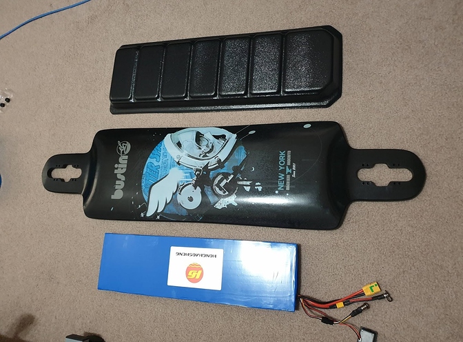

Deck and Truck/Wheel Assembly (and Checking Out Battery)
Looking at this, my first impression was how big (and heavy) the freakin’ battery was. These are the Samsung 40T 21700 cells. Although this is a good battery, I am not a fan of this all-in-one design especially having the power switch hard wired to the battery. (The guys at Propulsion Boards were awesome for switching out this battery for me. The first one that I received was a nightmare of a defect. Despite the battery/BMS being off, it was outputting full voltage at all times.)
I love all things battery-powered. And along with the battery is a generous sized enclosure to house this thing. At first glance, I thought it was a “generous” size until I quickly learned, it was barely able to fit everything inside. Ya can’t have it all - biggest battery, biggest VESC, and everything else in a slim enclosure. This is about as good as it gets without routing out a layer of wood from the deck (and I wanted the stiffest deck possible for my fat butt to stand on).
These Torqueboards 110mm blue wheels are huge. And they stand out from the black board. I thought about getting everything black and stealthy, but the blue wheels at least at the time of this purchase were “softer” than the black wheels. Black wheels were rated at 78A whereas the blue ones were 74A. Torqueboards, at the time of this writing, just released their new sets of wheels that are 72A. The bearings that I installed in them were Sector 9 Black Ball Ceramics Race Bearings.
The wheel pulleys are made by Evolve. These are the 36T kegel pulleys. Propulsion Boards advertises that these had to be used on the trucks/wheels. Not sure why. Maybe because the trucks are Evolve clones? I might have to experiment with a few other pulleys to see what’s up. If someone do know the answer to that, please let me know.
Just for a comparison, I pulled out my old Caliber II trucks to put it up against the double kingpin trucks and my goodness, I got almost an inch and a quarter more height between the two. And if it isn’t apparent, the Ownboard trucks are wider than the Caliber II trucks.

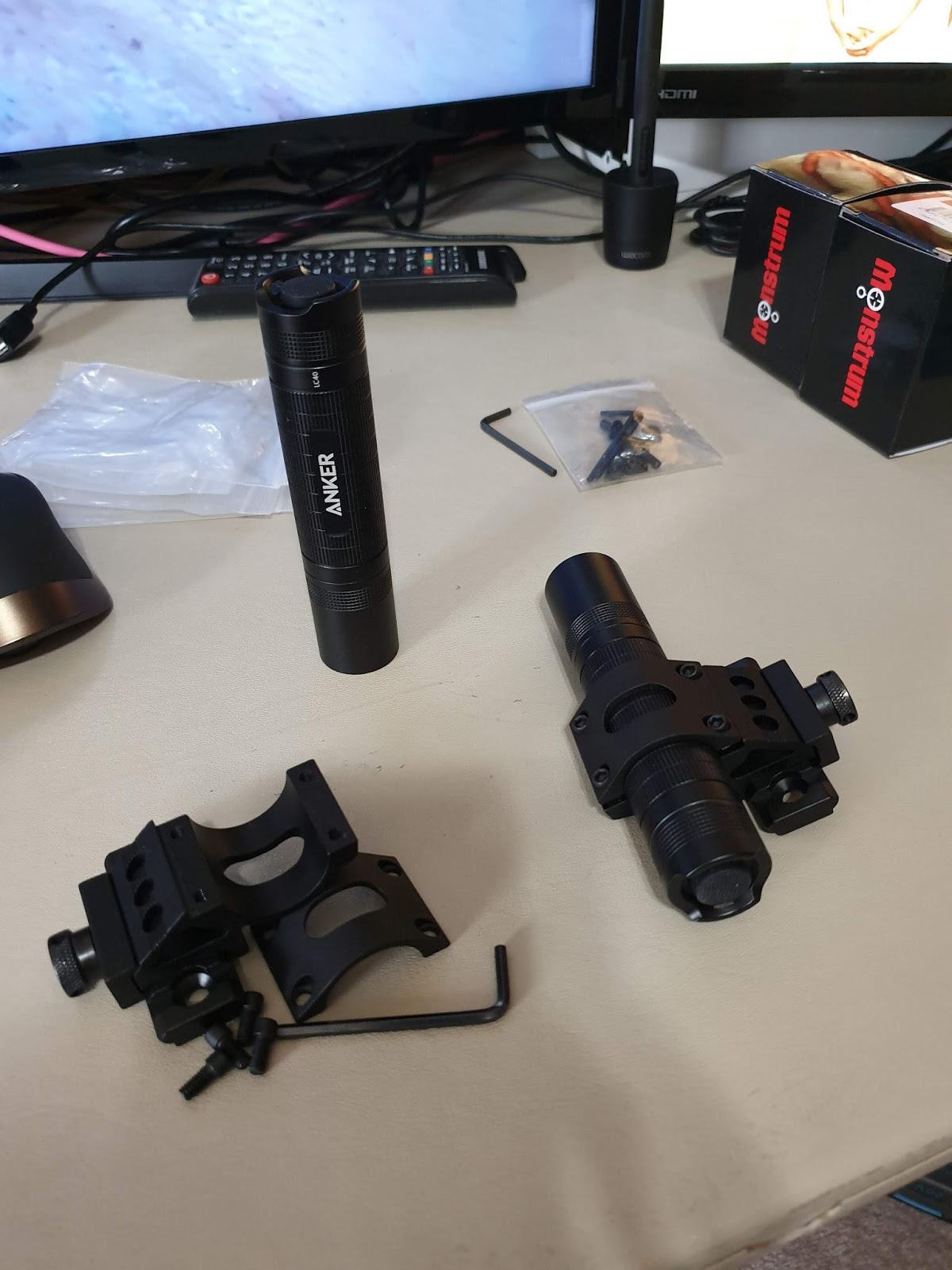

“Anker”Lights
This is my version of ShredLights. I liked the idea of the ShredLights but wanted more power. I do happen to have a couple of picatinny rails, flashlight mounts for an AR15 build, and two Anker flashlights.
These Anker flashlights are 1” in diameter as with most flashlights of this size so they fit well with the 1” mounts.
sighs I encountered my first problem with the install. The rails aren’t tall enough. The adjustment screws hit the top of the truck’s baseplate. My 3D printer came to the rescue again! Taller pic rails printed at 100% infill using PETG for rigidity.
Works beautifully!
Looks nice until I encountered problem number two: when I lean about 85% into the trucks, I get wheel bite at the edge of the mounts. After playing around with different heights, angles, etc. I gave it up. I wanted something that was wide and low profile. I can have one or the other but not both. (Yes, yes, I know, I could potentially 3D model a rail that turns the flashlight outward, but I was too lazy. It’s a project for another day.)
I ended up settling for this instead: I took my 1” scope mounts and used it on my flashlights. My brother’s description of the lights was that they were “unnecessarily bright.” Mission accomplished! [for now, until I can make some angled rails so I can have a wide beam, maybe high beam too). Note the fact that the word “OWNBOARD” in the top photo have been sharpied out in the bottom photo - so much cleaner!
