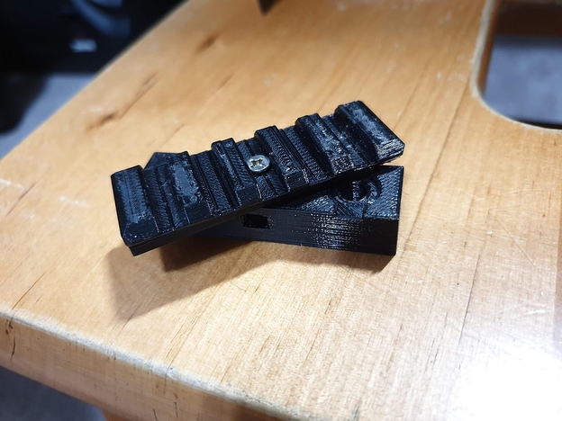

At the time, I was too lazy to 3D model a proper rail so I just jerry-rigged something to work. Operational? Sure. To my liking? Not a chance! So the previous design (pictured below) had one major flaw and that was the beams were too narrow, because of the obvious that they were too close together. I might as well just have mounted one light. Between the two flashlights from LED-to-LED, it had a distance of 3 inches. With this new adjustable design, I got the lights to separate 5-½ inches; the outer beams barely overlapping each other in the center.

Design
I lost some sleep and grew some brain cells during this process. I wanted something simple and accessible (at least to me). So I sat around with Blender for a couple of hours and came up with a two piece rotating rail. The rail would interface with a base via a M3x10mm screw. The base has an internal M3 nut that would “clamp” the rails to itself once attached.
The original design had the beams kinda directed towards the ground. I wanted “hi-beams” so I angled the picatinny rails a bit. I didn’t measure the angles… too lazy. I am not interested in blinding people. I am interested in seeing what’s on the ground, what’s in front of me, what’s to my peripheral, and to intentionally let people know, “Hey, there’s someone on a freakin’ something going down the road, don’t hit him.”
Assembly
Assembly is pretty straight-foward. TL;DR: This is what I want to get to:
Once the rails and bases were printed, I inserted the nut into the slot of the base. Now, I was dumb and made the slot to be exactly as tall as the nut without much consideration into the tolerances of the 3D printed so I had to hammer in the nut with a punch (no pun intended). Not much of a headache though. It actually worked out in my favor, because I don’t want a loose nut if I ever have to take the rail off.

Iterations of the design from right to left:
  • Rails that were too short and the flashlight mounts couldn’t be fixed on it.
  • Rails worked but didn’t have an adjustability.
  • This third one, I was just going to screw directly into the base with a half inch screw but did the extra work to model the nut slot and holes for the screw.
  • Final design for now until something doesn’t work, and my OCD kicks in again.
