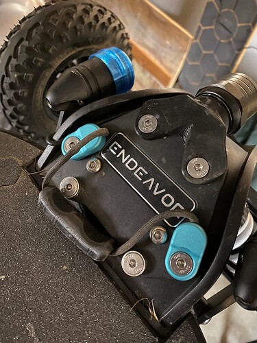

In this picture: 3rd Headlight & top mount, Stock Headlight covers, Handles & Handle Clips.

I think it would be cool to have a handle on the front of the board. This board is chonky!
Yeah, I added 2. One on front and rear.
I designed a clasp, of sorts, that replaces 2 of the washers on the top plates.
There clasps have a recess into which I inserted paracord with a knot at the end.
When screwed down the recess captures the paracord knot, and on that paracord, I added a TPU handle.
I recently had them CNCed out of aluminum and anodized blue.
I also had my controller design SLS printed out of Nylon and the trigger also CNCed from aluminum.
The handles help a bit, but the board is still a pain to pick up or carry…
