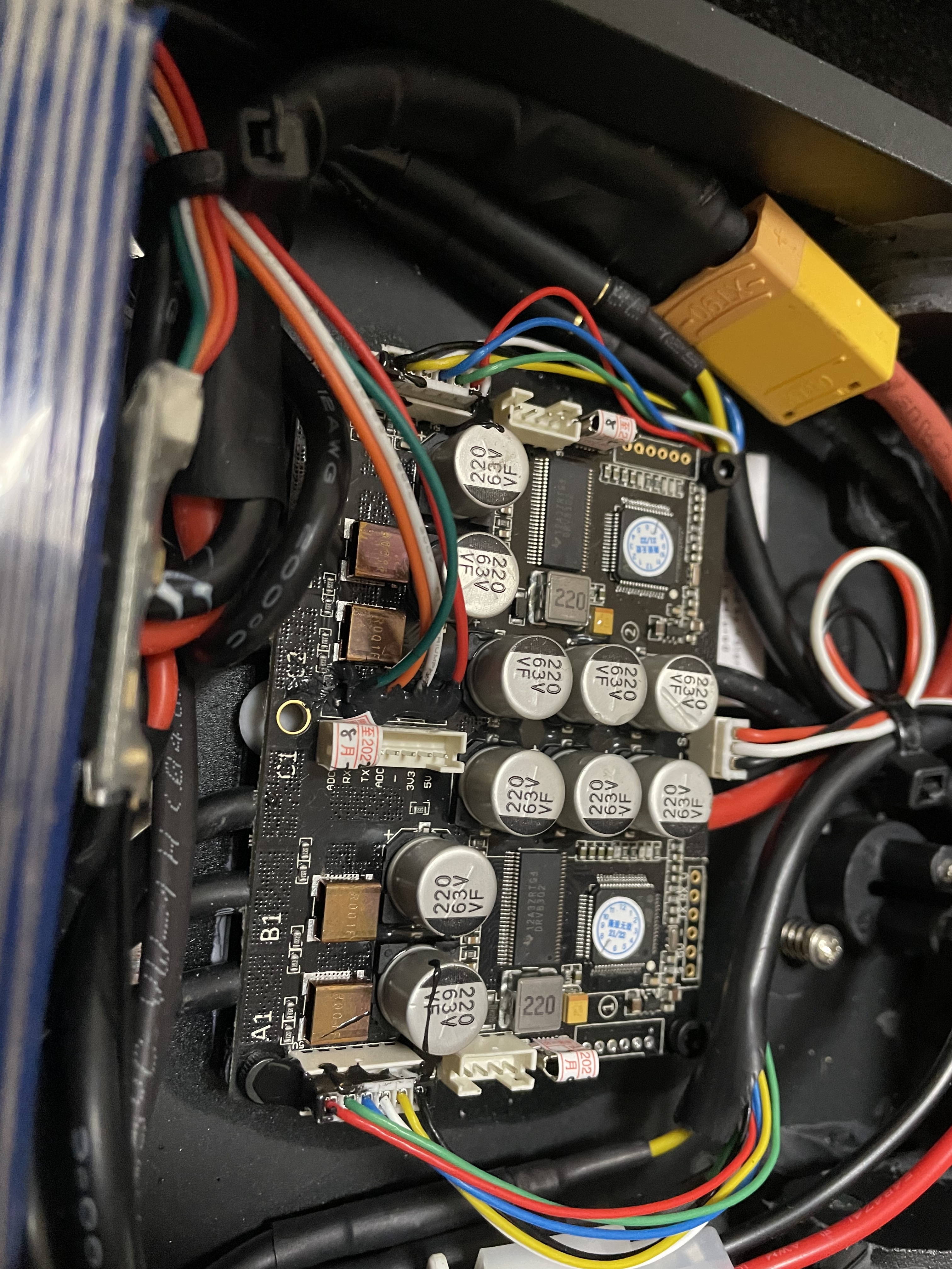

ESC is Flipsky FSESC4.20Plus, FW5.2.
So far it’s working fine.
The gear ratio is 72:14 and there is torque. It goes well with this board.
I recommend installing metr, but the warranty is void. There was a seal on the UART and I peeled it off.

could you also post more pix of the insides? I’d like to see the layout and how everything fits.

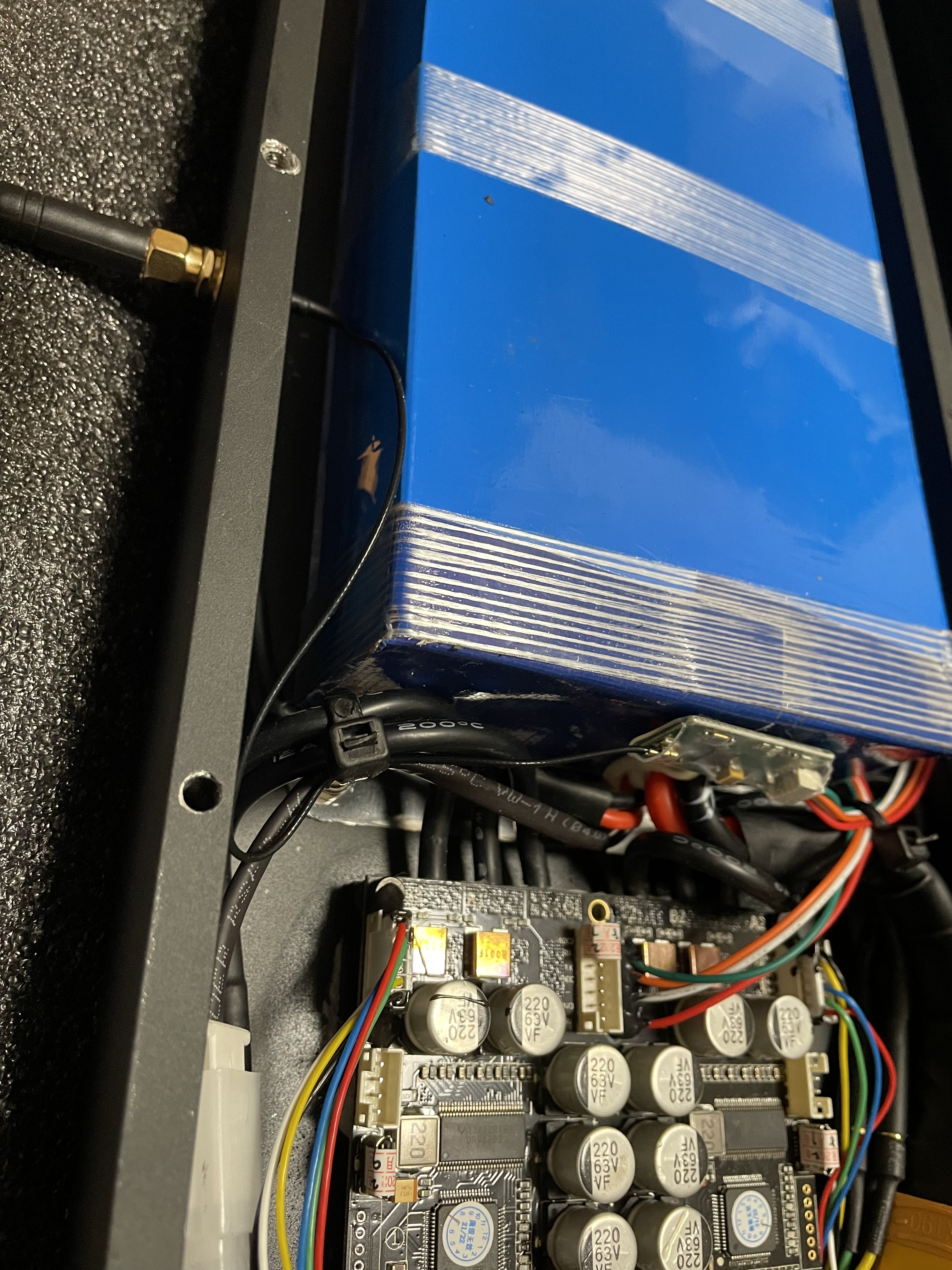

This is the only image I can publish right now. Removing the deck is a hassle.
The remote control antenna is very important, and without it the communication will be very poor.

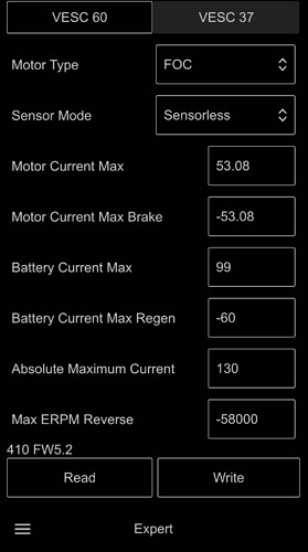

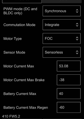

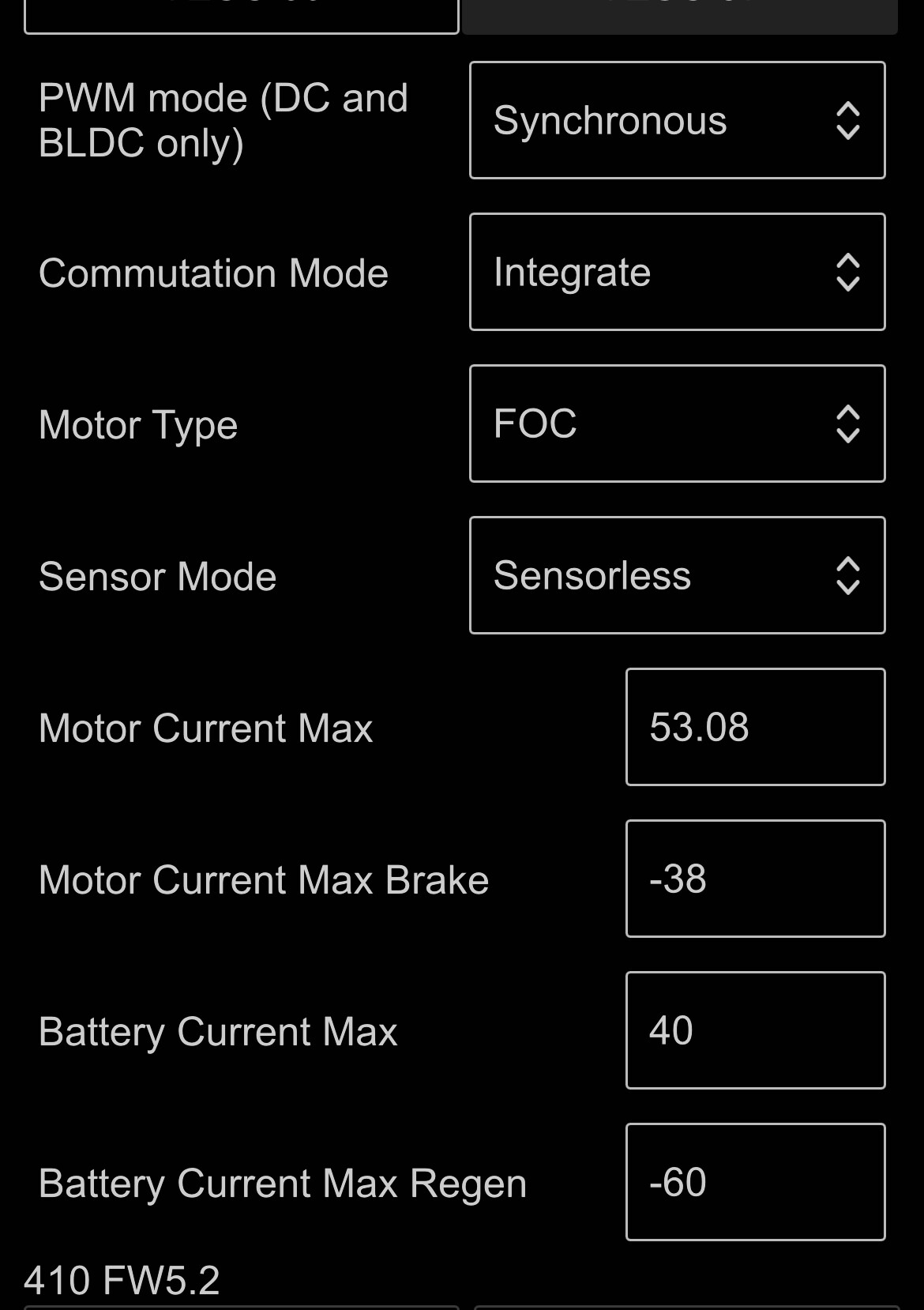

The first image is the factory setting, and the second image is the modified setting.
Depending on the rider’s taste and weight, 40A is enough acceleration for me.
The brakes are also a little too strong at -53A. It’s too strong and the tires lock.
If you do not change the VESC value, it is recommended to ride in M ​​mode of the remote.
My OCD hates that .08 lol
