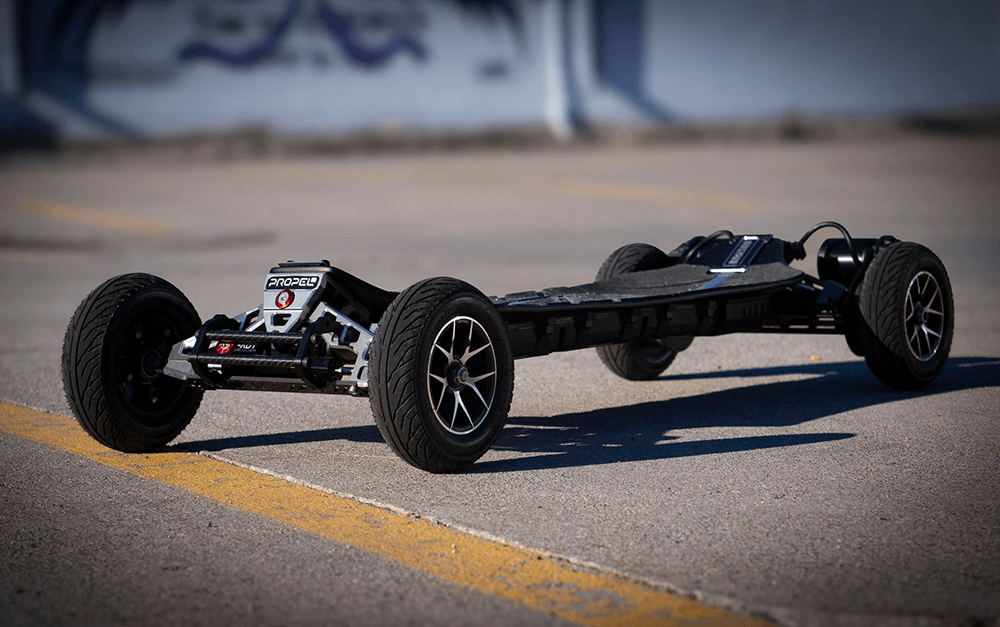

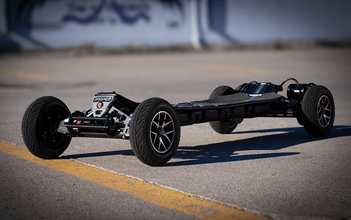

PROPEL All-Terrain Off-Road Electric Skateboards
thoughts on these?
The Propel Ruckus pre-sale went live today.
it is really cool!!Do you have any suggestion about how can i replace 8 inchs tires to 10 inchs tires? Or do you have any link where i can buy that? thank you!!
Anyone know what the width and length of the new Ruckus deck is?
Under specifications there’s some dimensions but I think it’s for the whole board. Not sure if it helps or not.
