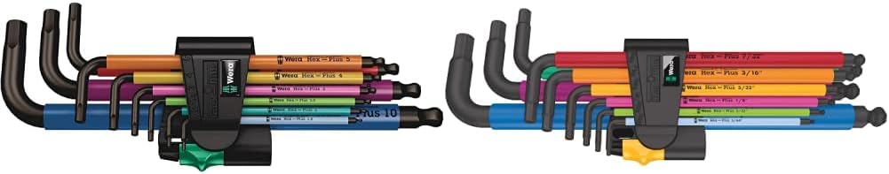

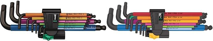

Get a good set of tools for your raceboard; crappy tools or using the wrong tools are why shit falls apart or gets stripped. A few of the basics:
(Some of these are not the best of the best I know, but will be better than the 2$ Amazon special. If you have better cost-effective tool suggestions, please message me. I am happy to include them!)

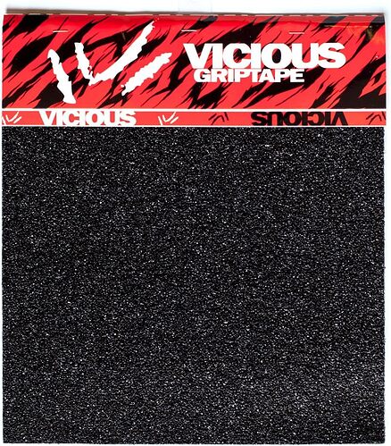

Grip Tape - I use the big vicious squares as I find those easiest to cut out.

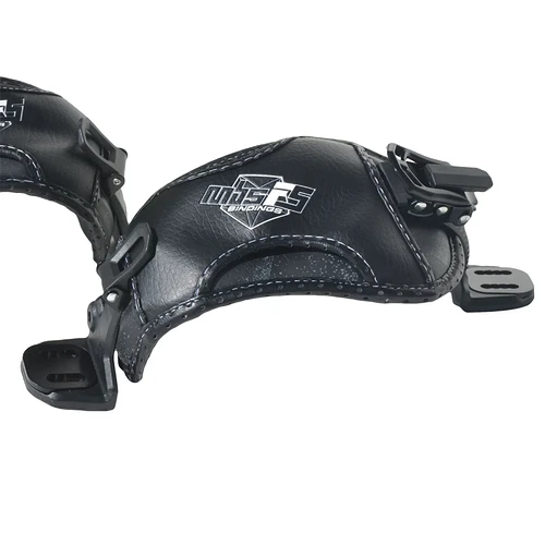

Binding - Can’t go wrong with @MBS F5 Binding. One thing, I use the opposite side for my foot (Regular for goofy stance and vice versa), it feels better for me on this deck. I also mount the nose side of the binding to the truck pattern as seen in the assembly section.

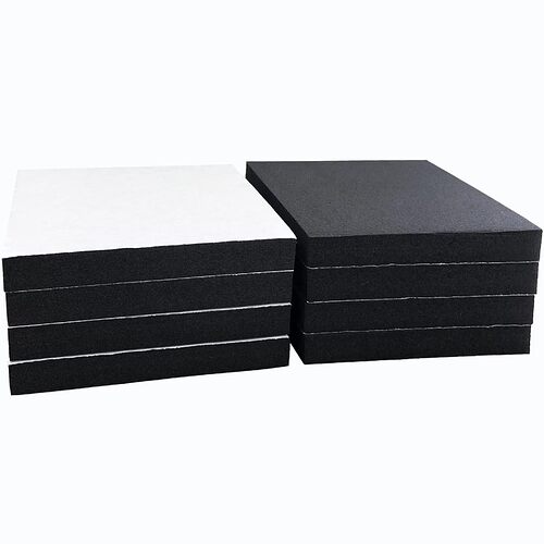

Foam - For battery box. The pre-installed foam isn’t rigid enough for my liking.

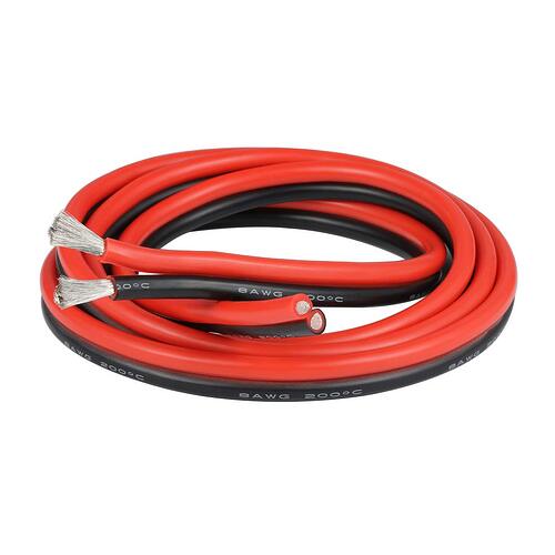

Wiring - 8 awg silicone wire. The good stuff. Highly recommend using a 70 to 80-watt iron.

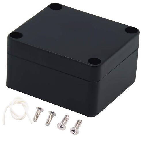

Junction Box - for the esc. I like this sizing, fits MakerX 2G300 with some dremmeling to the top, you can make your own solution too if you’d like.
The sizing is being wack on the link, choose the 7.9" x 4.7" x 2.95"in one.

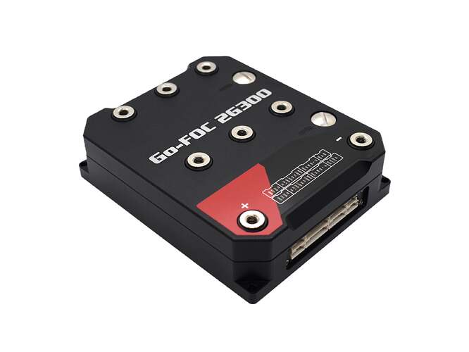

VESC - Makerx 2G300, honestly, the standard now for high-power boards with a price that’s unbeatable.

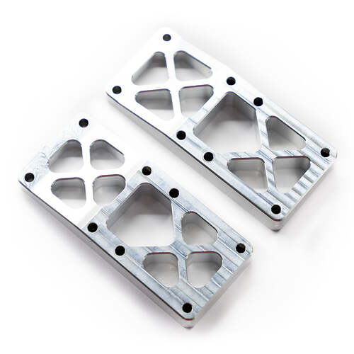

3-Link Extensions - By MBoards

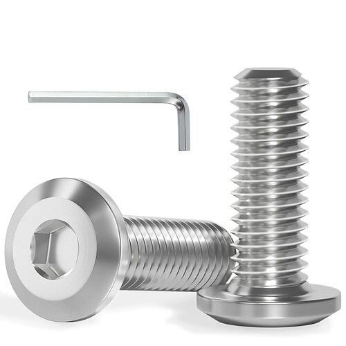

8x M5x25mm Cap Head Bolts for mounting 3-Link Trucks to Extensions

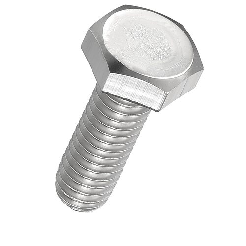

M5x35mm Hex Bolts for Truck Assembly to Deck

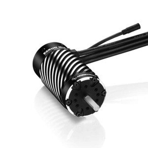

Motors - Hobbywing 56118 650kv X2

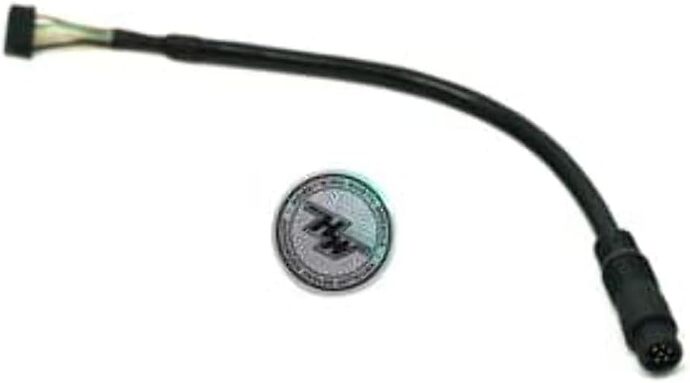

Sensor Adapter for Motor X2 - NEED TO CRIMP OR SOLDER JST-PH 2mm CONNECTOR TO WORK WITH G300
JST-PH Crimp Kit - I bought this exact one. Wish I had done this sooner.

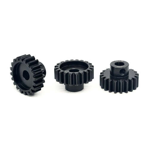

11t Mod 1.5 8mm Bore Pinion - For motors, recommend this gearing 11/78.

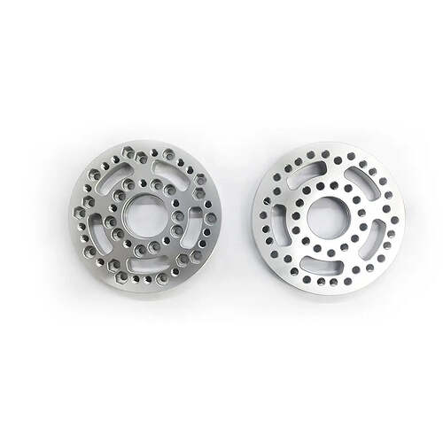

Spur Gears 78t Mod 1.5 - Can be mounted to standard esk8 hubs with Linn adapter or to BRP hubs for BRP Tires.

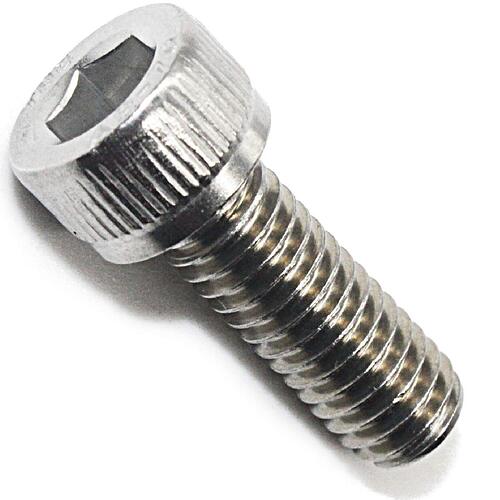

Edit 2: Any reason why you chose stainless steel hardware vs alloy steel?
I use the eskonne one and it works well. Don’t know if there is a major difference between that and the genuine but happy to change if there is!
And as for the stainless hardware I was debating between that and the stainless and to avoid corrosion / rust I chose stainless. Personally I don’t think the load requirements are that high to warrant the alloy steel. Once again though if I’m wrong please let me know! Happy to learn!

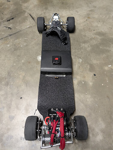

Got pictures of the boards?!
Yes yes I am alive! Usually a lurker lol, and yes board photos coming soon!

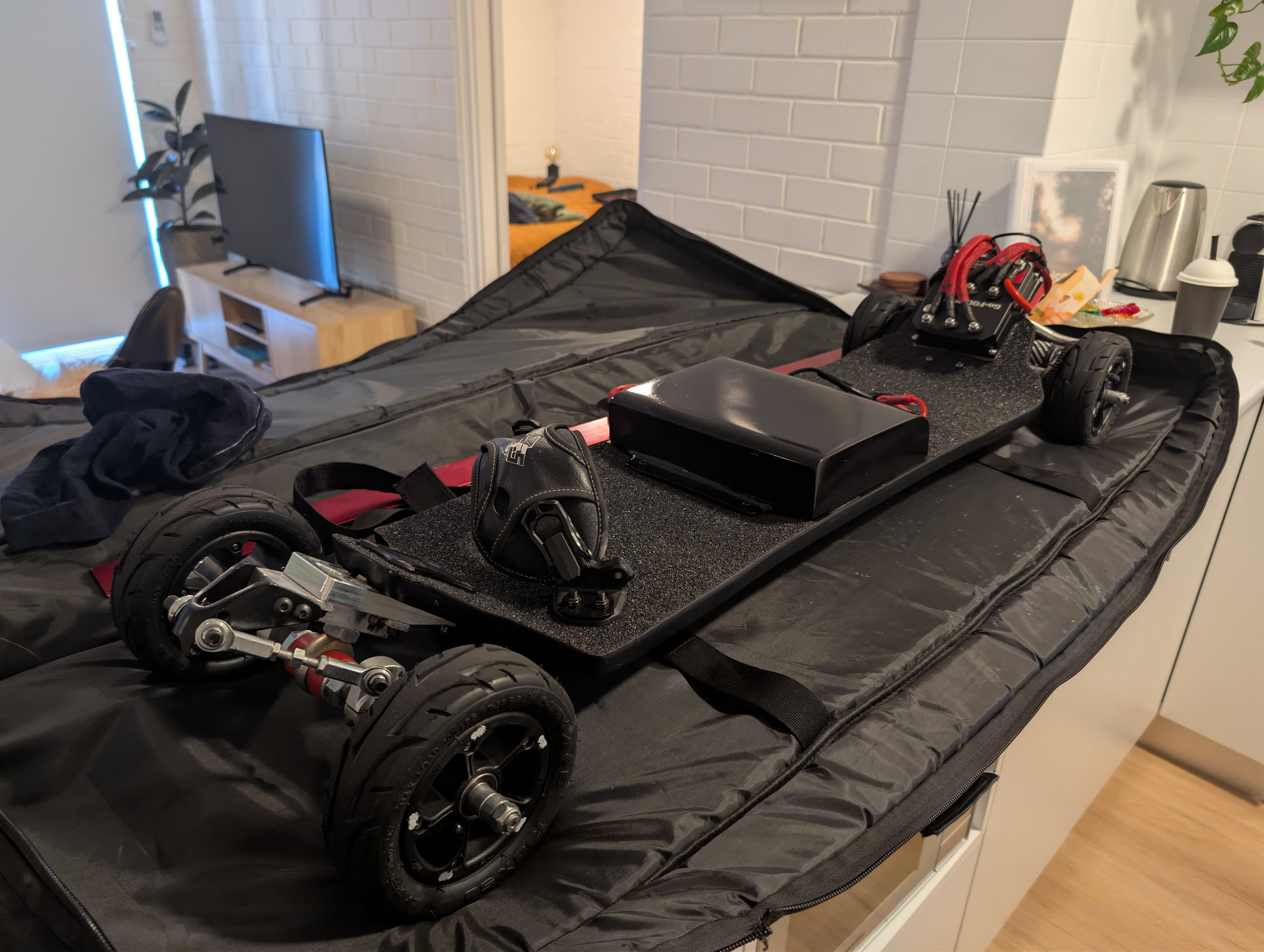

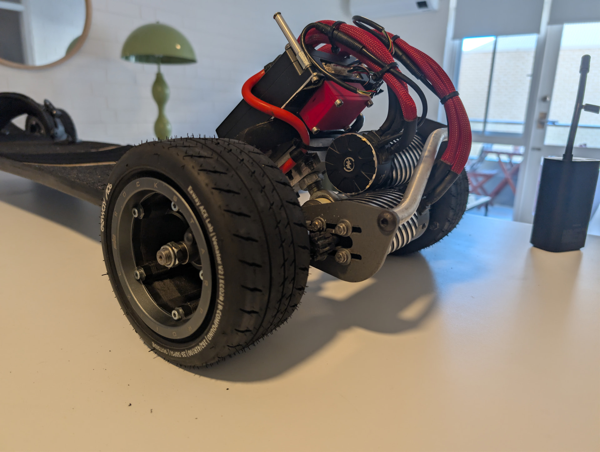

@HAIRYMANJACK I want to know how much the nose weights affected stability etc., if you rode without them before the addition or if they were installed from the start. Ive toyed with idea of adding weight in front the axle like this but haven’t implemented it yet since I spend most of my time at short track speeds.
Absolutely love the all out in the open mindset, props to you @HAIRYMANJACK
#16 heavily inspired by your setup. 35 degree ends on mine, a lil steep up front but was able to counteract that with a custom baseplate bracket. I used the mboards extension in the front and made my own slightly shorter one for the rear. I had a pretty nasty high speed crash recently at nationals so am currently rebuilding in 4wd configuration mostly for the brakes. Crash aside it’s been awesome so far.
For anyone that hasn’t been keeping up, this is the setup @HAIRYMANJACK has clocked 70 mph on. I call this the Jack spec. Very high level performance, I’m really enjoying my new G300 56118 inrunner setup.

I highly reccomend adding front weight to the board, changing the center of mass from maybe 20% rear bias to pretty much dead center instantly gave me a few mph speed boost in terms of comfortability going that fast letting me get to 63 from 59 back when I was first figuring out vesc + inrunners.
I have about 2 pounds or almost a kilo on the front.

Ive wondered what all that was on the front of your board. Maybe the 6468’s I’m throwing up front will have a similar effect. Have you gotten around to fitting thermistors to the motors yet? I’ve been wondering how far the 56118’s can be pushed or if we’re pushing them too far already. Currently 340 motor 200 battery
What are the settings in vesc “motor current max and absolute maximum current” for one motor?
340 motor 200 battery.
