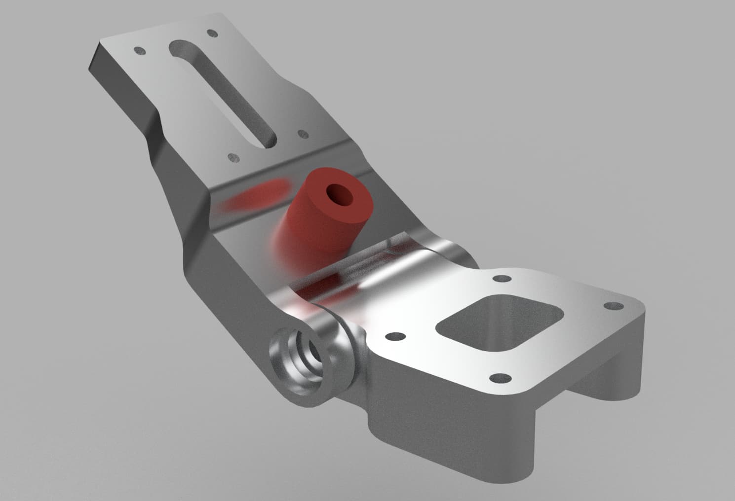

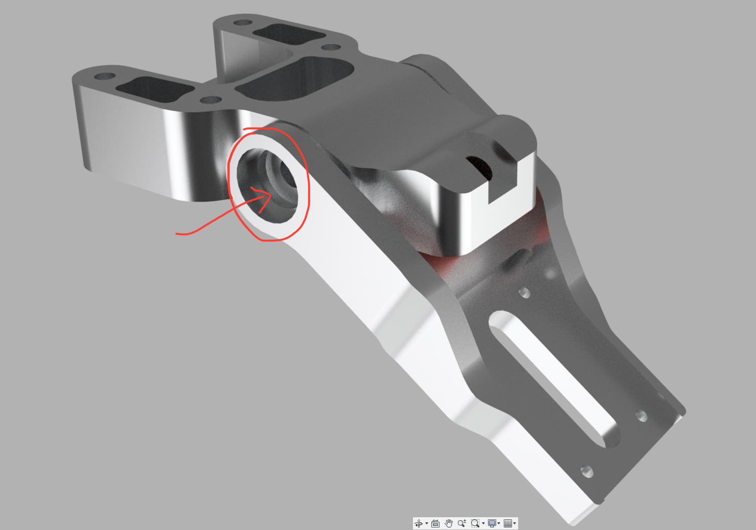

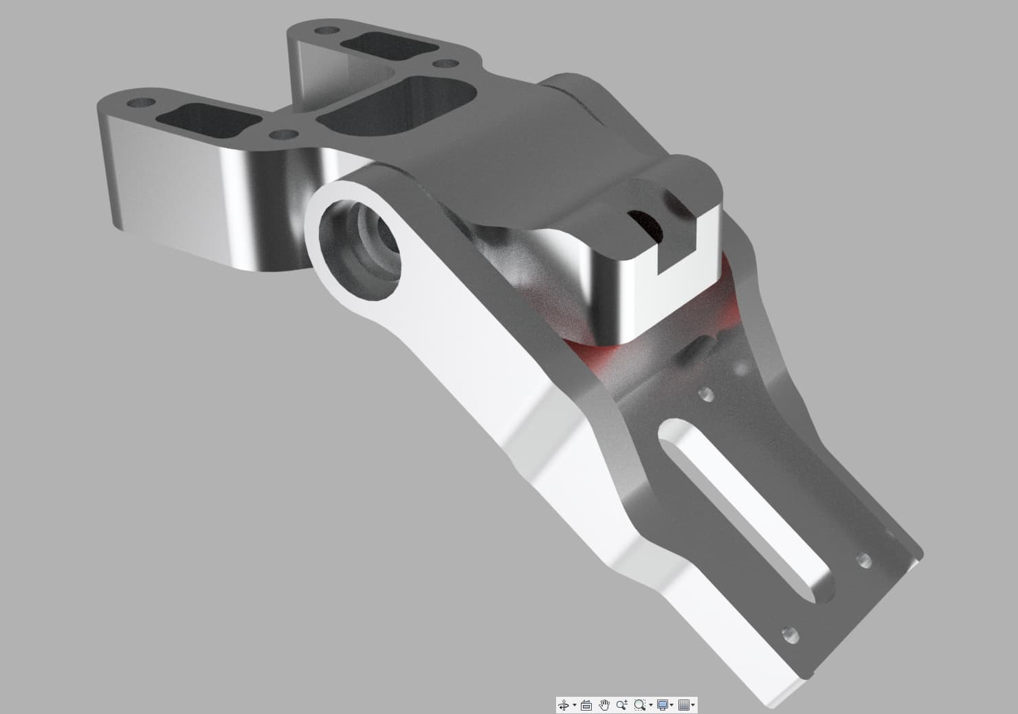

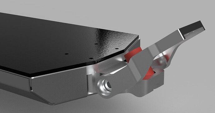

Spent a day redesigning the swingarm for CNC machining (not a simple job however not impossible to machine either). From 8.9kg alu the end result is 2.3kg for both. With some FEA I might look into more weight savings but I’m happy enough with this number for moment.
Working on acquiring a cnc mill. In the meantime the university lab just got a makera carvera air, so if my own mill takes too much time to acquire and setup, mayyybe I can cut it at uni. The 130mm Z axis travel on that small machine might make some operations impossible though. The 160mm on the ratrig would be doable but I’d appreciate 200mm Z if I can find something like that…
A set of swingarms is 200€ in raw material (7075 alu), damn, was hoping it would be about half of that. Maybe i’ll cut it in wood first to make sure I won’t mess it up :smile:

I had a Carvera Air for a bit. How big are the pieces you are looking to mill? Looking at it in photos, I don’t know that you’d be able to do the holes in the sides because it doesn’t look like you’d have the Z clearance.
Also you would most definitely want a 3D probe setup with a good vise, and they’d need to be running the Carvera community firmware in order to use the probe. It would definitely be better on a larger mill.

About 170x100x40. Definitely at the very least suboptimal on the carvera but likely impossible to make those bearing seats with that machine.

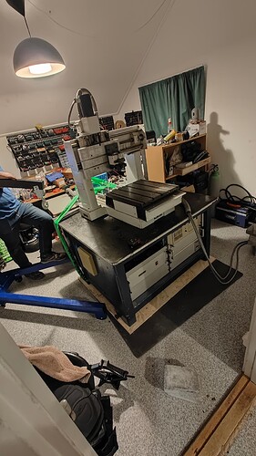

For unloading we used the ramp and some straps, it wasn’t a big issue. Then we took the parts inside, the bridge and the huge table we needed to flip 90 degree to fit through the door, which we did with the engine crane.
The parts for now are resting on the kitchen floor, and assembly will continue monday. This is the kind of stuff that I cannot work on alone.

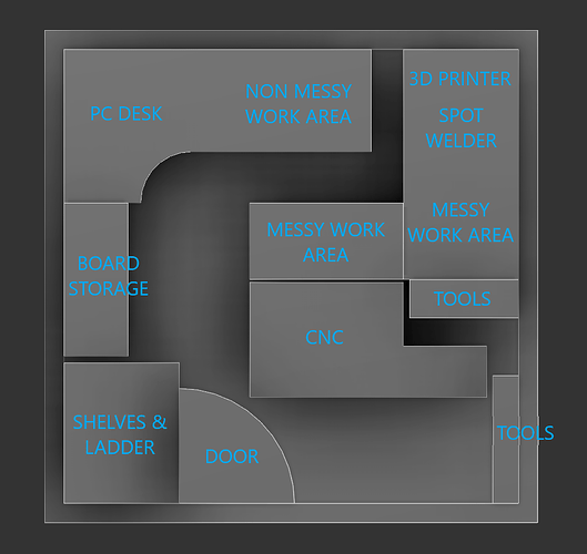

The table is in my room flipped on it’s side. When I measured out where I want the table to be, I didn’t think of a huge computer hanging off the side of it, so now I am exploring another potential layout which should accomodate that better. I don’t technically need that on the machine, but having everything CNC control related attached to it wouldn’t be a bad thing, and I like the industrial look. I need decide the final position until monday.
Edit: yep, this is what I’ll be going with. It also gives access to the back of the machine which might be useful sometime. And keeps the U shape floor space to move around, which gives the most usable space in this small room.
