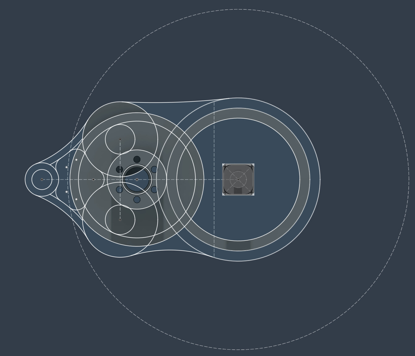

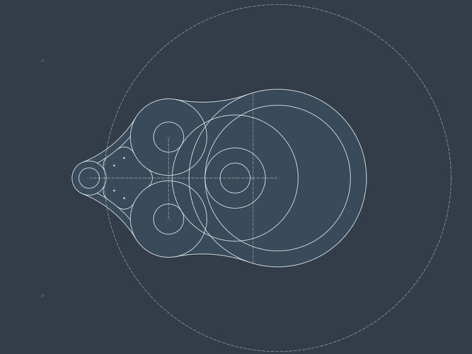

Been also doing some work on redesigning the double stage drive for the inrunners, and I can definitely compact it down from the original. Did a lot of engineering math behind it, so I’m quite confident it will test well. More on that once it’s finalized. I do still need to finish my involute internal gear generator which is quite tedious, then model what gear widths fit for the preferred hanger width. Then input that into my Mathcad calculator to finalize the gear modulus of stage 2.
My main goals for the redesign of the double stage drives were to #1 reduce size as much as possible without sacrificing any reliability or longevity, #2 apply engineering math to optimize the design, and give a decent estimation on strength.
I really wanted to play around with internal gears like these:
As I’m set on using SLM already, I thought I might as well take full advantage of the technology’s ability to customize and implement stuff sane people normally wouldn’t. Internal gears like this can be used to shrink the casing of a multistage drive… However they are quite hard to implement. For one, a gear generator doesn’t exist for them, I’ll have to make my own… The equations are freely available, but more complex than regular gears. I just don’t even want to get started on implementing that until I pick up the secondary monitor on facebook marketplace this weekend.

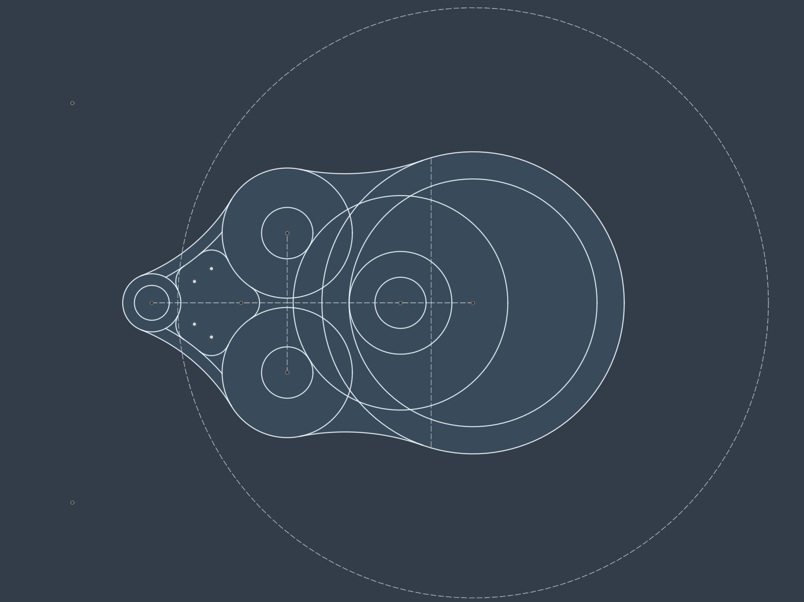

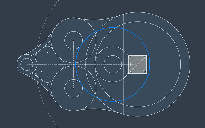

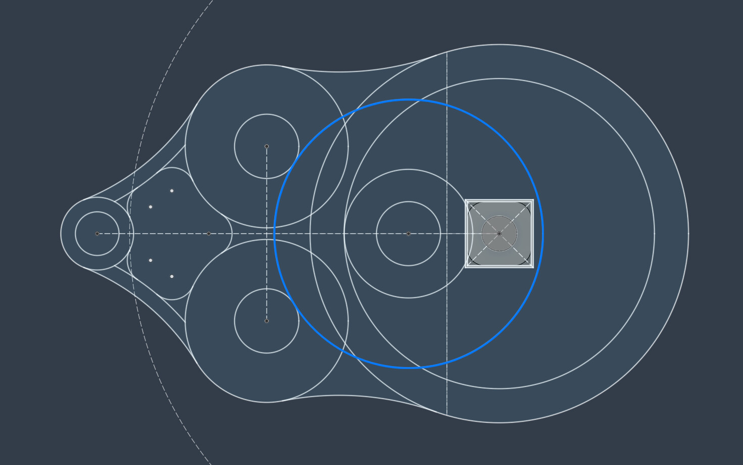

So back to the sketches… The first sketch I shared preliminarily… Highlighted is the pitch circle of the big intermediate gear. I forgot about the truck! Yikes. I guess that’s what implementing complex assemblies on sketches at 2am can occassionally result in.
So how about moving the internal gear to the intermediate stage? Should still offer similar benefits in terms of overall drive size.

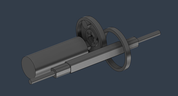

This meant the two intermediate gears are no longer just printed onto each other - the simple way would require supports, and I am not confident in a load bearing SLM part printed on supports. So figured out a way to bolt them together. All looks good, and this acts as a bearing hub as well for 608 bearings, perfect.

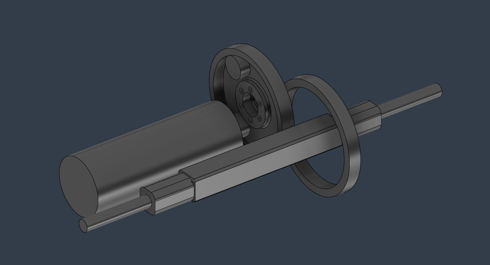

Here’s sideview of what I have in CAD for now - gears are just represented in pitch circles for the time being.
Next step is figuring out what’s the max face width I can get away with for the gears, then design the casing, taking good care around the floating shaft. The CAD is all parametric so moving the finalized mod back into fusion shouldn’t mean too much work :crossed_fingers: Preliminarily it’s looking like first stage will be around mod 1.3 and second stage around 2.6; but this might be lowered a bit if I can fit slightly wider gears. Once I’ll have the face widths finalized I’ll share the math on which I based my numbers. TLDR I estimated the material’s capacity for infinite cycle life, then I matched the gear geometry so that the stress approximately equals what’s allowed.

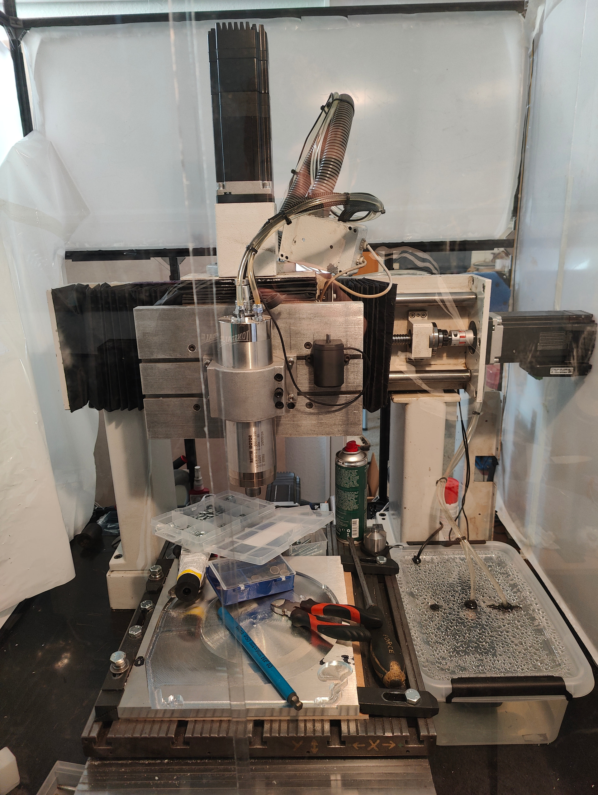

SD card wasn’t the fix for CNC gremlins. Didn’t realize initally that the control board’s PSU had isolated output, so now I grounded it’s output and hopefully that’s the fix :crossed_fingers: Cutting right now, I’ll see soon if it continues to work. Also lowered the current of the stepper drivers to make sure the gremlins are not temperature related. The drivers were pretty cool but the motors are toasty all the time even at 7/16 setting. Now I’m trying 5. That said the motors don’t have temperature feedback, so it shouldn’t have been the cause :person_shrugging:

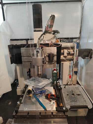

CNC gremlins weren’t the grounding / PSU either. I’ve been told to check the couplers maybe one of them isn’t tight enough. Hopefully that’ll be it…

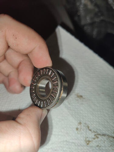

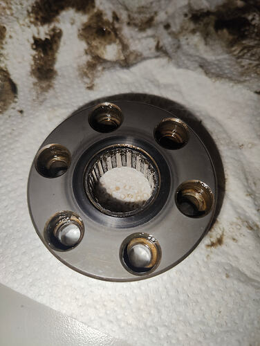

While I’m at that, I took the bearing assembly of the ballscrew apart to take some measurements and hopefully find some replacement components.
This is where the crunchiness comes from on the other axis, this axis was easier to take apart though.
Just for my own future reference, 60mm dia 16mm width bearing block, 20mm inner 23.5mm outer bearing dimension. Has a sleeve inside which is 20mm dia 20mm long.
35mm outer 15mm inner, 12mm width.
If someone is a bearing expert, I’d very much appreciate some help identifying these as my own searches didn’t return very useful results…
EDIT: found it, AXNBT 15 60

New servos, couplers, MQL coolant system, and a separate PSU for the control board’s MCU side is coming in 2-3 days. I am really hoping the solution to the gremlins is in these orders, given the 1200€ ish I just spent for the parts. The only other thing it could be is the control board, which just sounds very implausible. If this indeed fixes things, I think I could get the first CNC’d alu part finished by Friday.

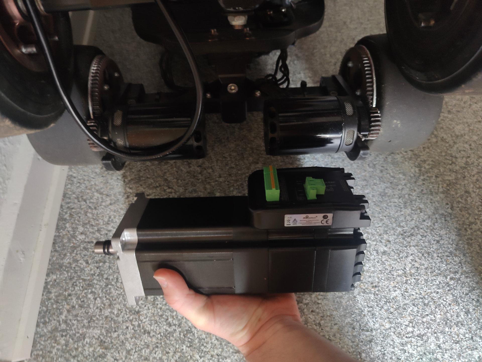

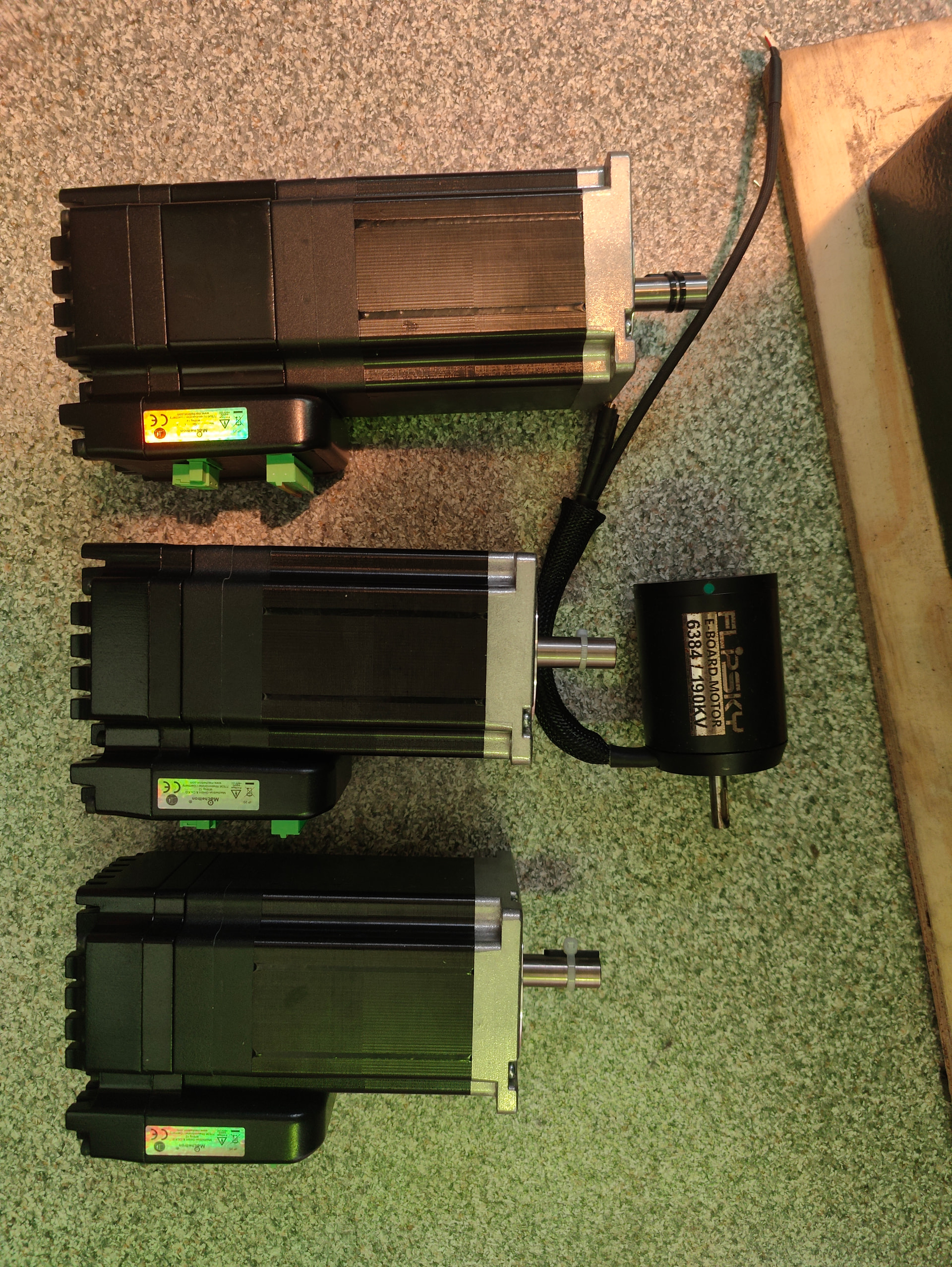

Gonna sacrifice my Huawei board charger to be the PSU for the servos until I buy a separate PSU for them. Huge nema34 660W 72V JMC servos.
Also received the quote for replacement bearings for the X and Y axis.
:rofl:
So this adds an extra project to the list, modelling an adapter / bearing housing, that fits standard bearings. On the other hand I discovered maybe my preload wasn’t perfect and the bearings aren’t as bad as I thought originally, so I also have a torque wrench coming that covers the expected preload range. Hopefully by playing around with the preloads I can get the bearings to quiet down and get rid of the low speed vibrations on the X axis.
Holy fuck that’s big!
The long one has brakes that electromagnetically deactivate when powered so that a heavy Z axis on ballscrews stays where it is when the machine is off.

Installed the new servos on the mill, had some trouble with a stripped grub screw which delayed things by basically a week. Still have to do the wiring for the servos. Then pray that this actually makes my issues go away. The motor swap eliminates most possible causes.

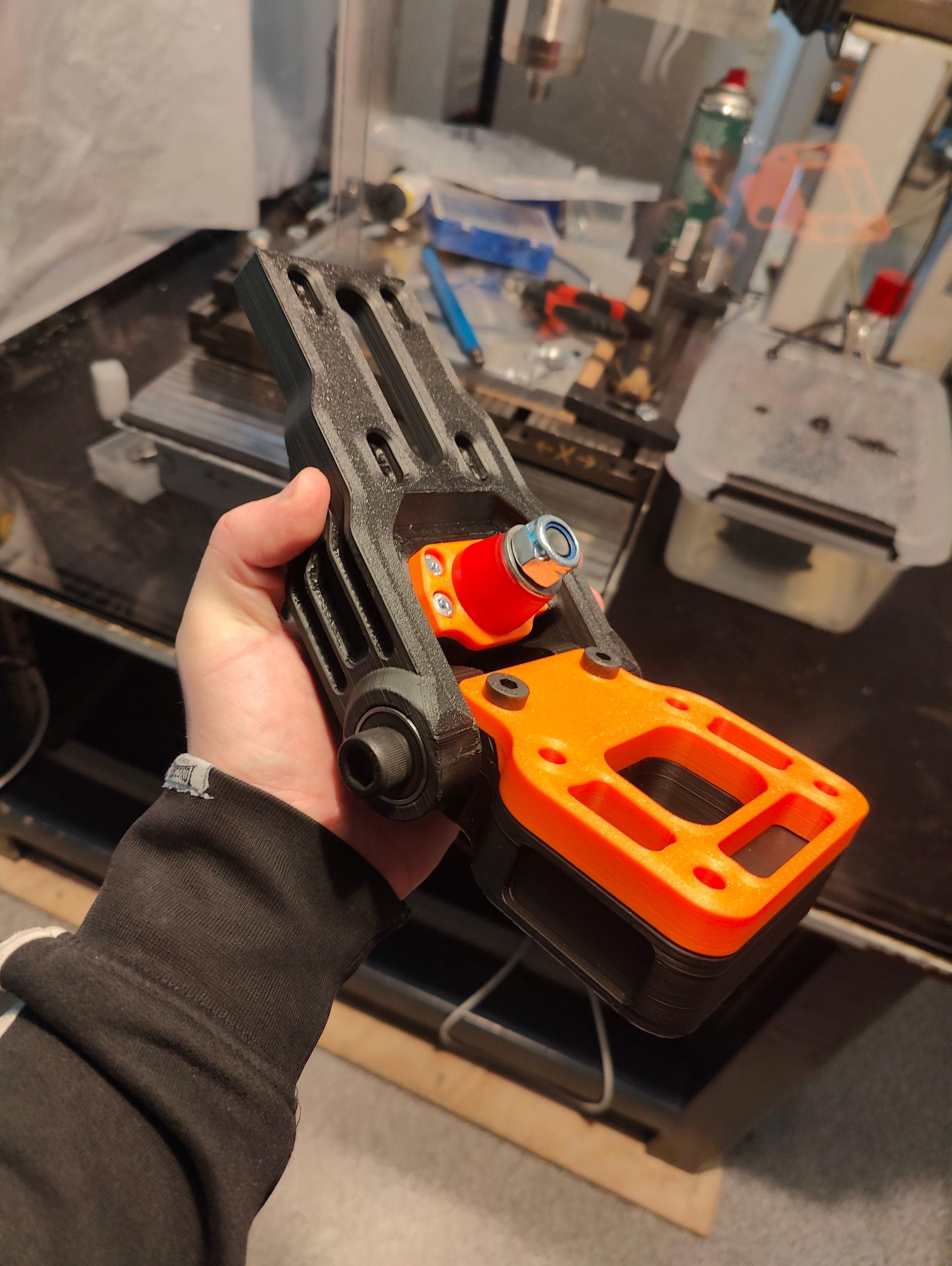

I have also printed out one of the swingarms. Obviously, not gonna be racing on 3d printed swingarms… But since the most likely scenario is that I can get the chassis done, but not the swingarms, this way I can still take the prototype with me to show it off, then finish it after my next exam on 2nd of june.
