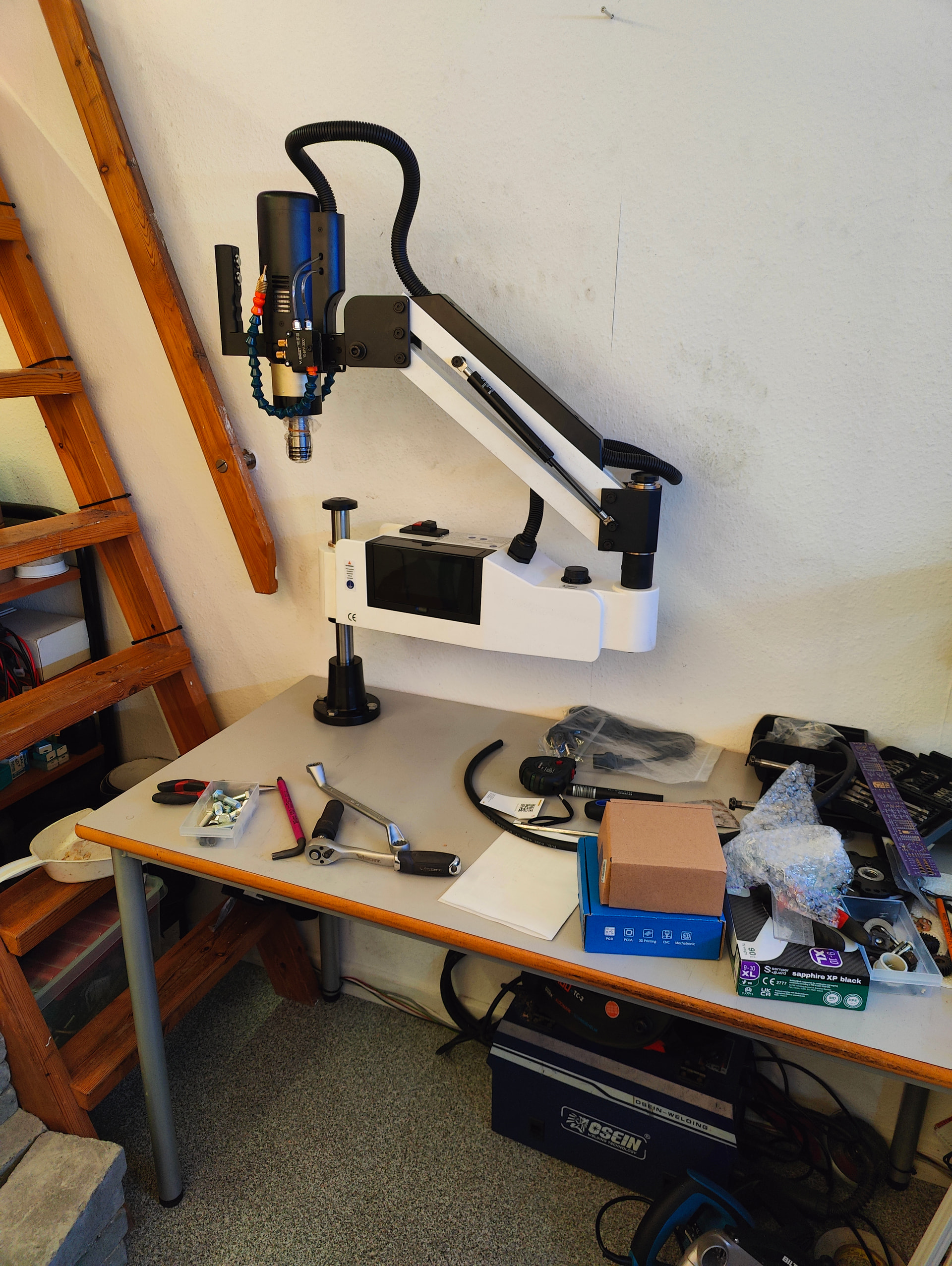

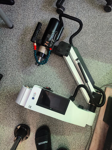

Tapping arm just showed up
Looks really nice, will make tapping holes effortless.

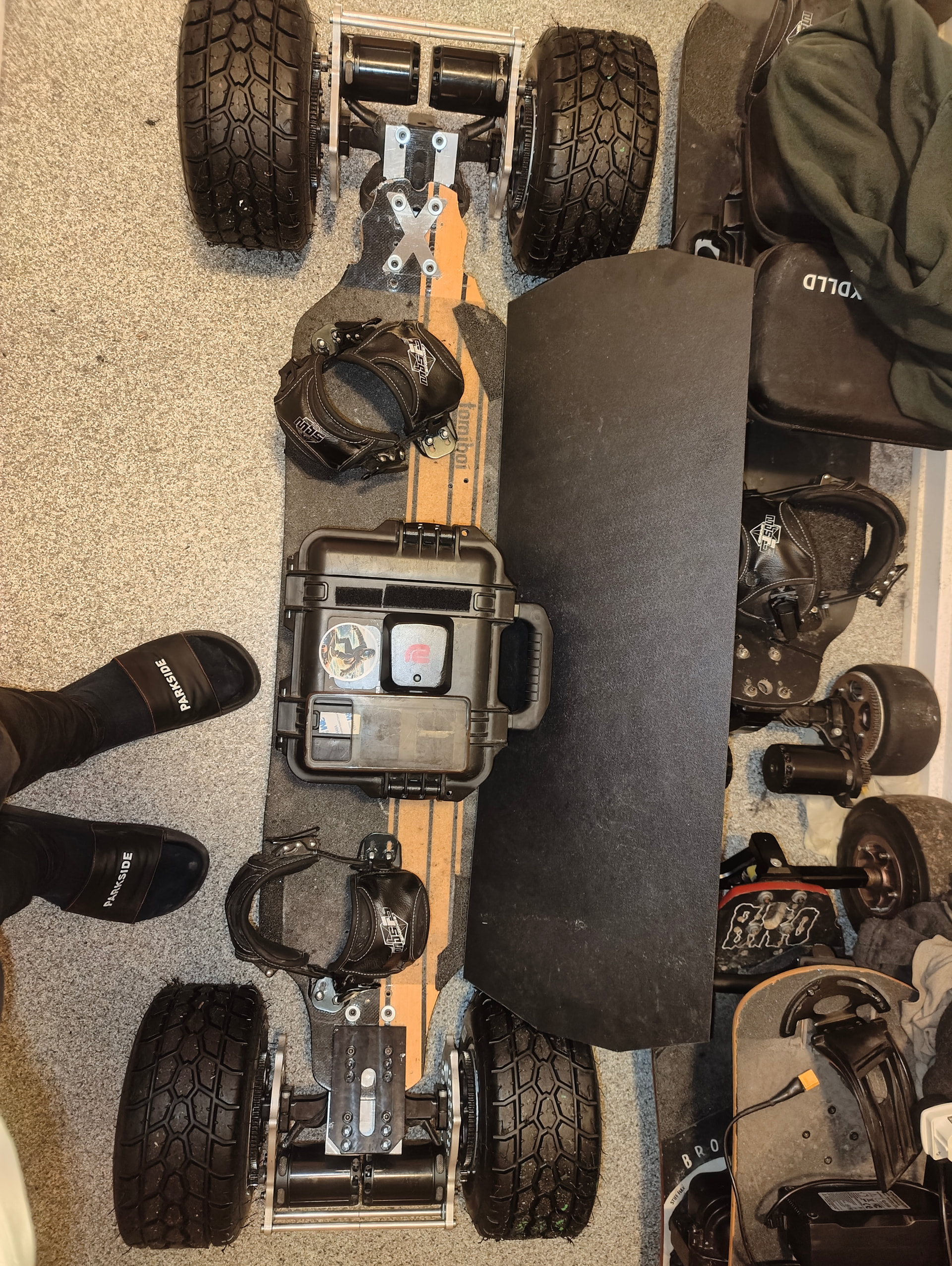

I decided to make the board 20S6P instead of 5P. So its a bit longer. Here’s a deck mockup from an ABS sheet:
875x286mm. It can house up to 4x g300 and a 20s6p. Also planning to make a shorter 5p version later. I like a wide stance personally, but the 5P version will be more comfortable for some people for sure.

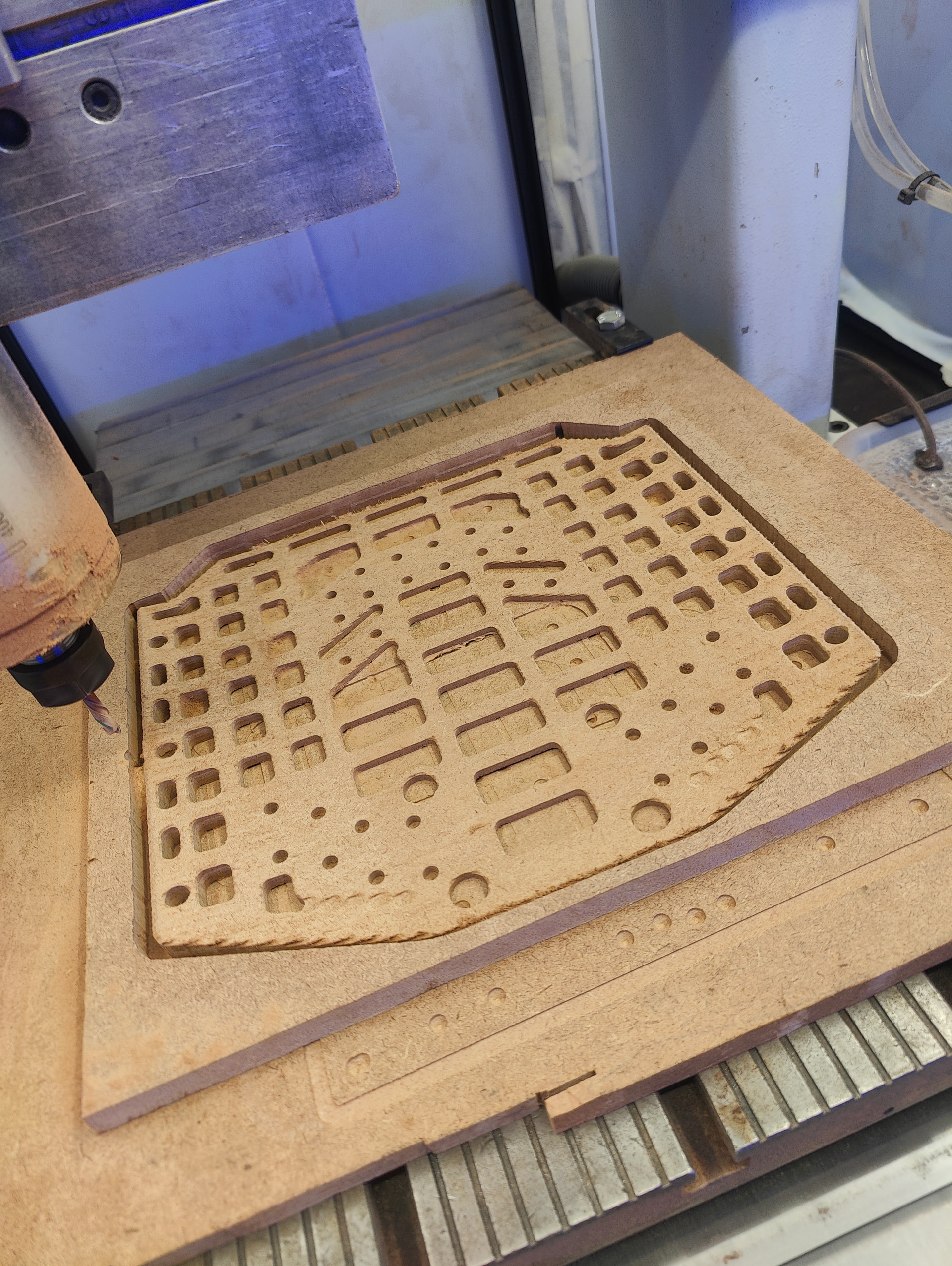

Doing a quick test print which I will pull at the first layer, superglue onto the ABS deck mockup, and confirm that the many binding mounting holes contain holes that I like. If it does, then the footpads are finalized.

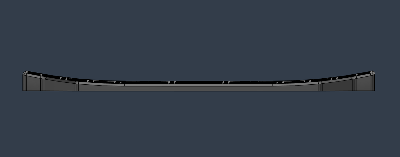

Milled out an MDF footpad. I like how it feels, so it’s geometry wise 100% final. Should probably make some more aggressive concave version as well eventually. 9mm concave sounds like a fair bit but the footpad/deck is so wide that the width mellows out the concave to a quite comfortable level. More aggressive concave would need taller stock material than I bought.
However, I don’t think that I need more concave than this with bindings on both feet. Will mill out the real thing and test.

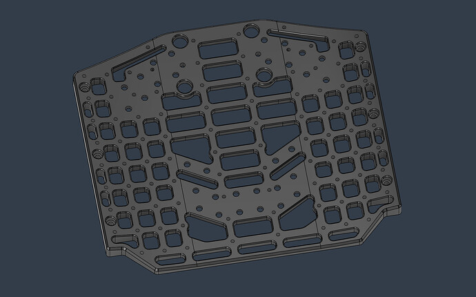

So now that footpads and chassis length are final I’ll prepare the lasercutting files.

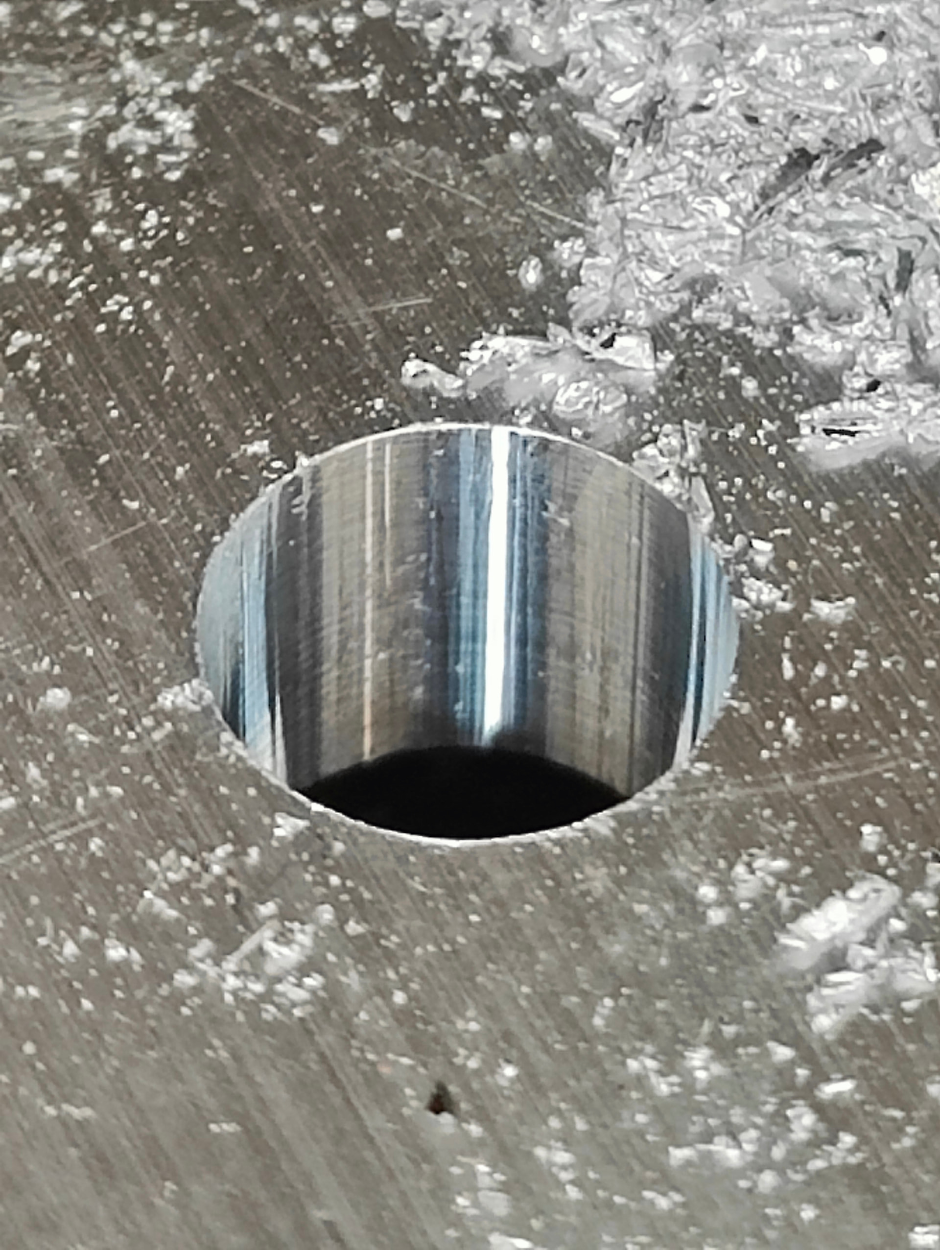

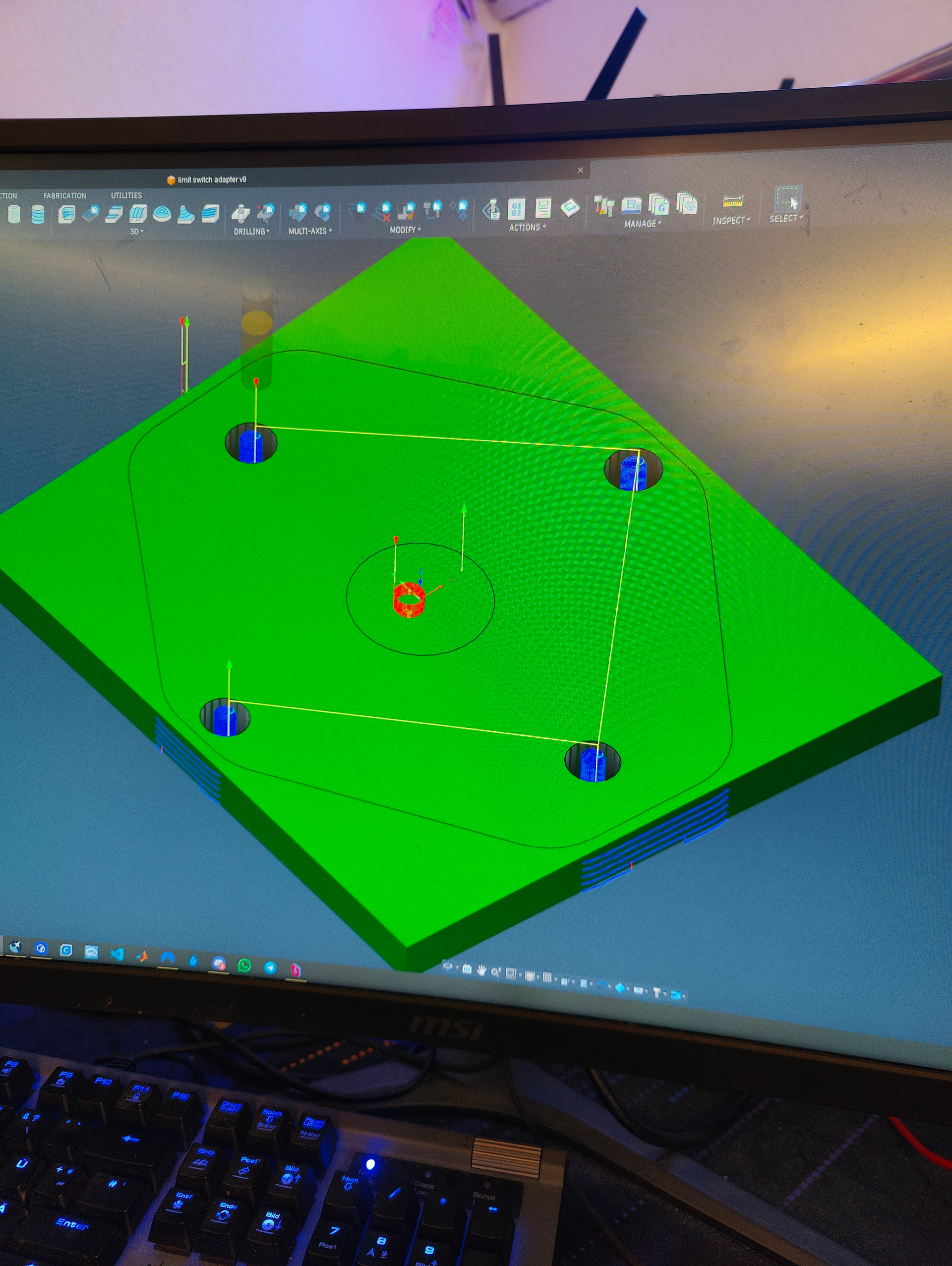

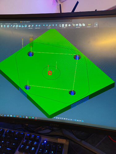

Did the first bit of alu milling today, so far just a quick test part. Still have to figure out speeds and feeds. Broke 2 endmills today! Probably in good part because I didn’t hook up the air system when doing the test part. But also have some CAM part to refine.
4x 10mm bored holes with no finishing operation, just roughing. They look really good for roughing and not even having chip extraction. Almost mirror like finish. So the mill is good.
This is a backing plate that I needed to mount the tapping arm onto the table. Basically an overkill antisink plate for the screws to not pull through wood.
I ruined the plate a lot cosmetically with the chip welding but it’s supporting the tapping arm well.
I might have underestimated the size of a tapping arm a bit. Also I need to pull the table forward to when I want to use it. It is what it is, I can live with that. Haven’t played with it yet, but it’s looking very promising. And it has an automatic oiling system fitted as well, which was a nice suprise as they don’t advertise that feature.

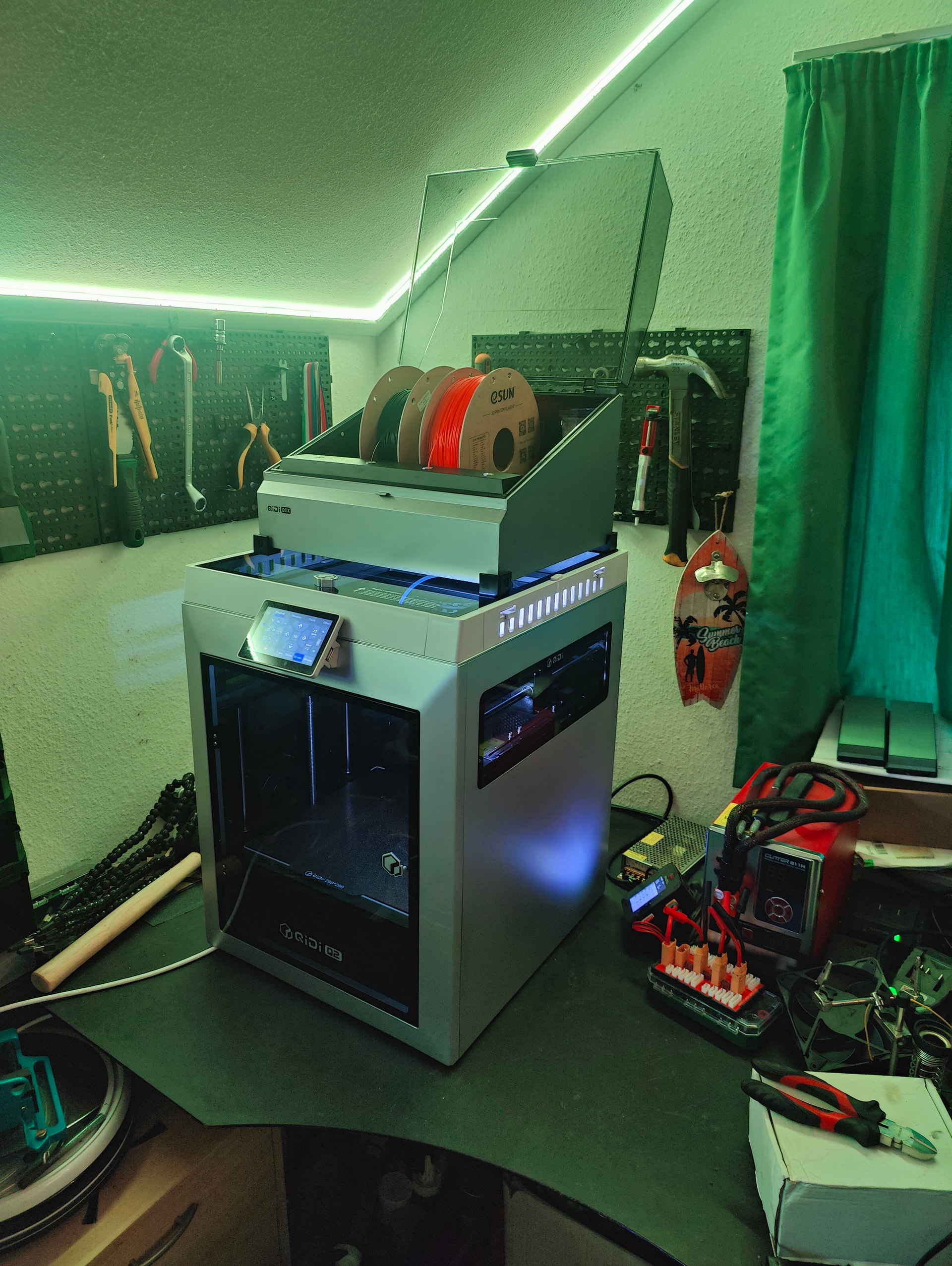

Also got a new printer, a Qidi Q2. Very happy with it so far, and it’s capabilities are going to be useful if I get into exotic materials. 370C hotend and 65C chamber heating. Gone are the days of tinkering just to get something to print. Did some PLA prints so far, but got some ASA prints lined up as well for the near future.
However, I might have underestimated the size of the printer too, seems like a tendency of my workshop acquisitions :rofl:
It needs to be like 30cm away from the wall on the side so that the filament box can open, and 25cm away from the wall behind it so that I can slide the top back to print cooler filament. And still manages to block most of my (admittedly not very good) pegboard system. So I’m having some workshop organization troubles now.

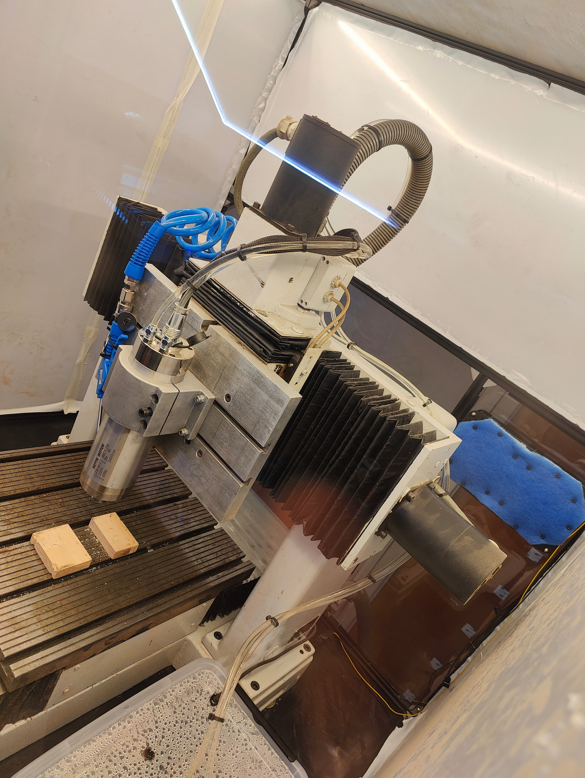

Been also playing with the CNC enclosure, the rear is pretty much done now, just polishing left. Got an access door in the middle that flips up. Also installed two Arctic P14 Pro PST fans with a 3d printed bracket and HEPA filter in front of them
Yet to wire up the fans though, need to run another cable up the cable channels with 12V power.

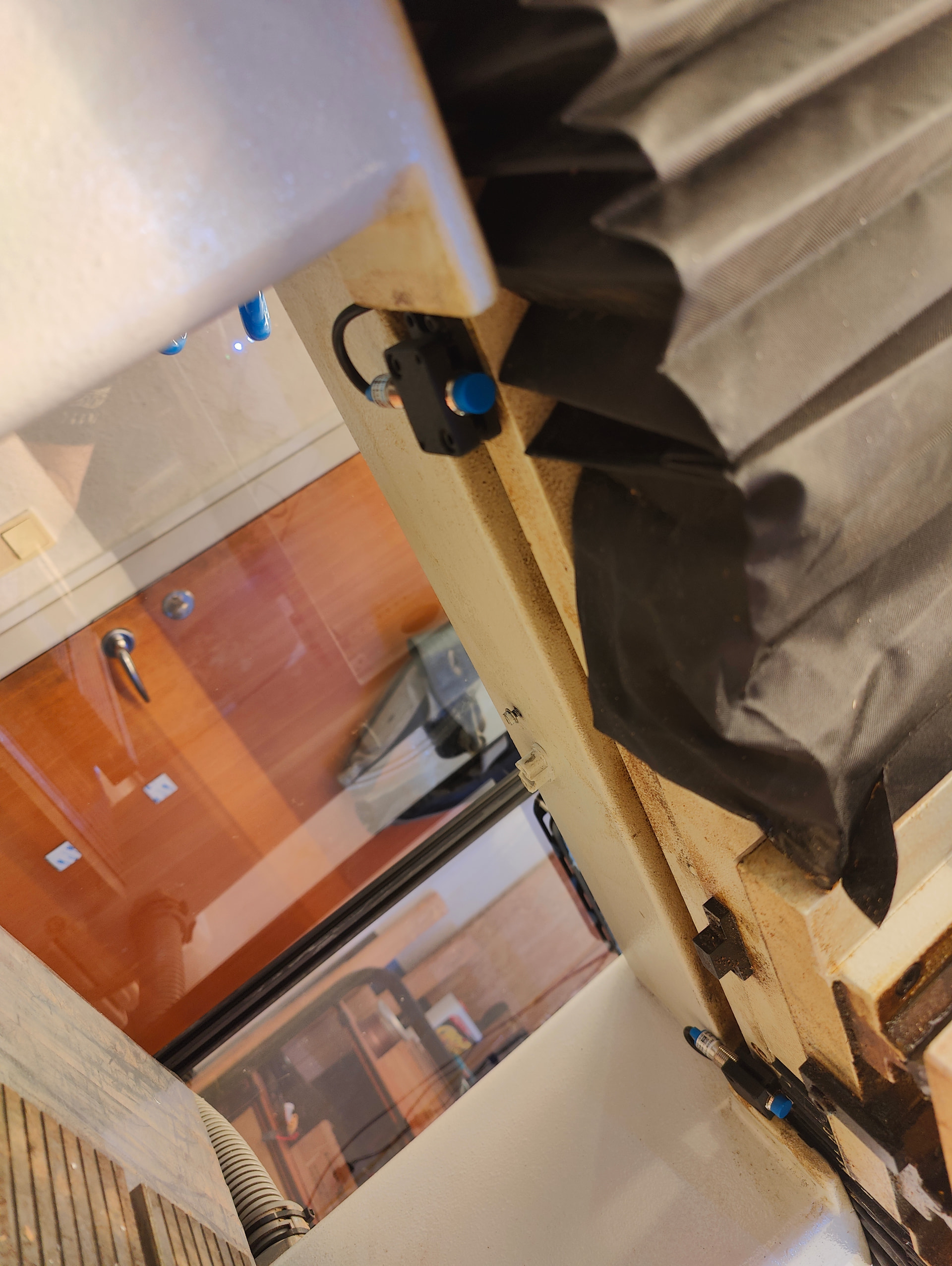

Been also playing with the limit switches
Originally I couldn’t get the ones on the machine working, so I bought new ones. These are however much bigger and thus needed redesigned brackets, designed and printed some. But then I figured out how to get the old limit switches working. So I’ll probably have one axis with new limit switches and two axes with old limit switches, as the X axis is already setup with the new ones, no point in putting in extra work swapping back. The old limit switches should be running tomorrow for Y and Z.

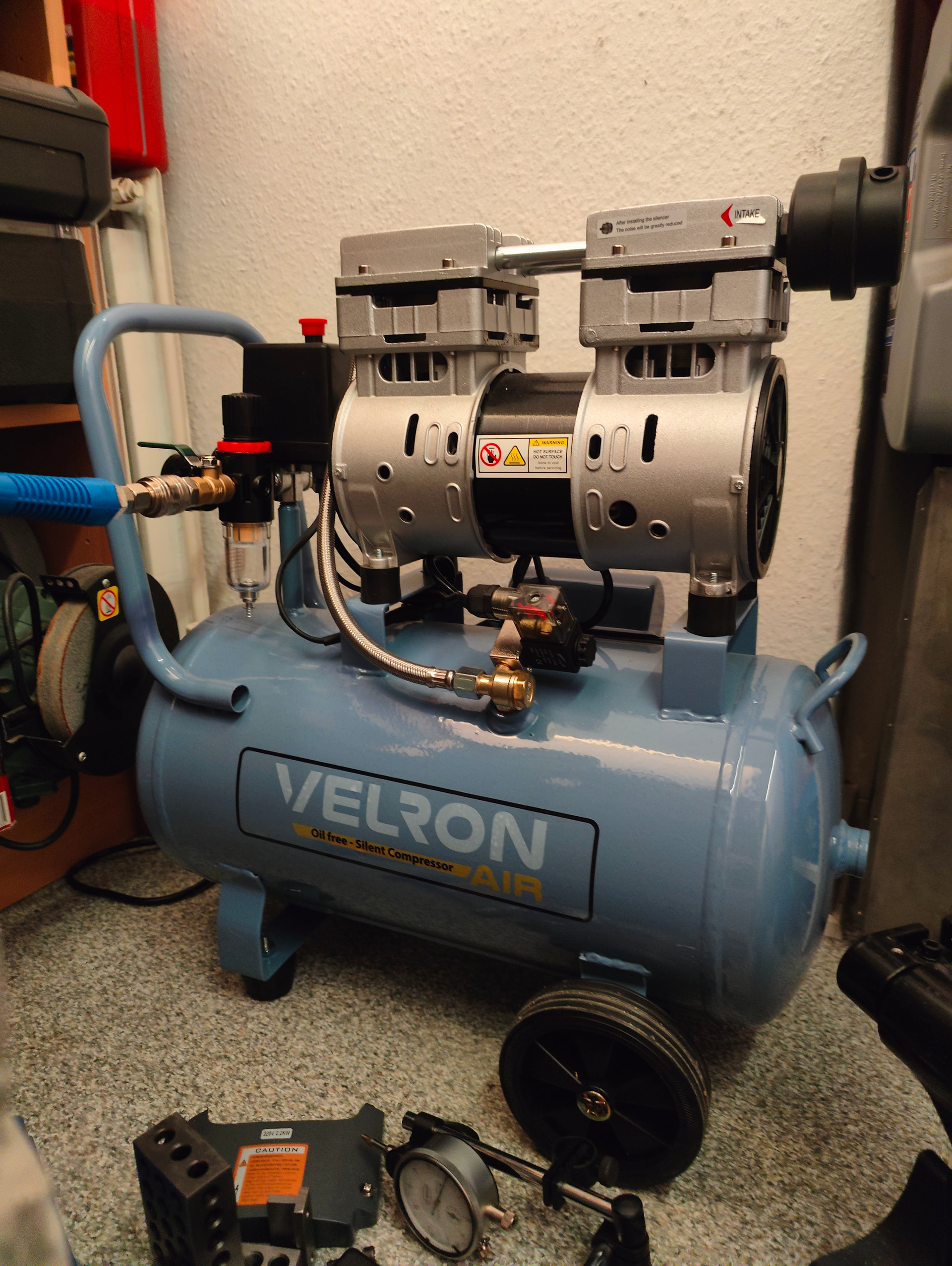

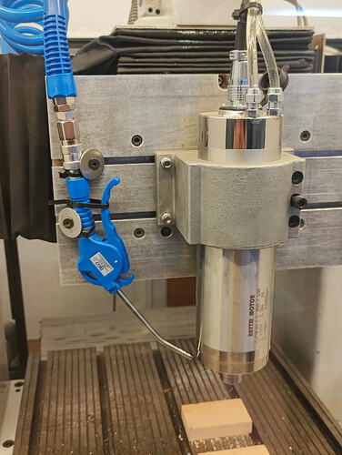

And lastly I did a shitty install of the air blast system. This is very much temporary, just can’t be bothered figuring out how to do this properly right now.
It’s powered by this small “silent” compressor, it’s not too loud but definitely a bit annoying when running indoors.

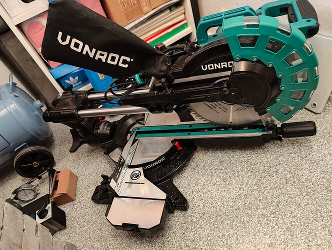

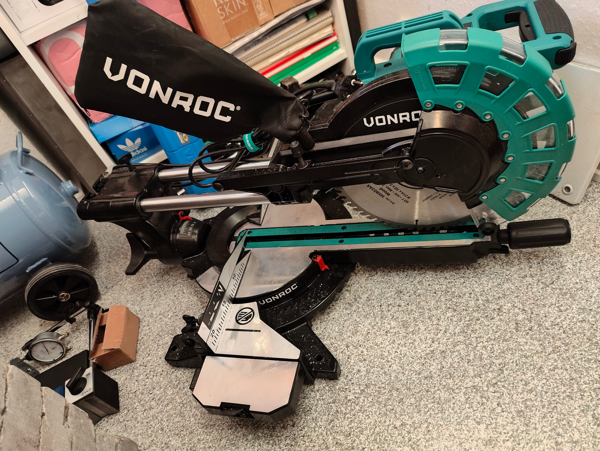

And acquired a quite large mitre saw for cutting up the aluminium stock to size before it goes into the mill.

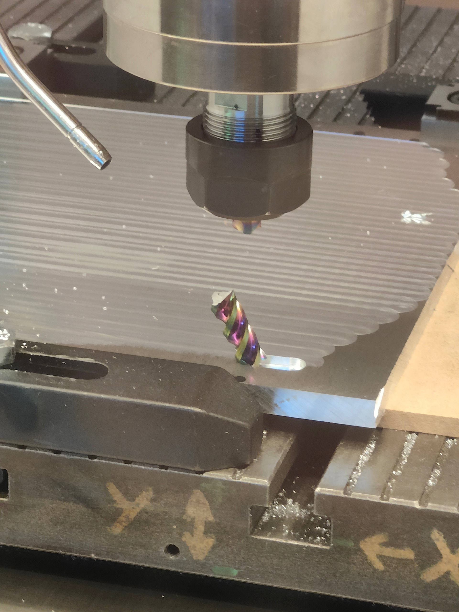

In the meantime enjoy this sad 8mm endmill that was supposed to take a very thin facing cut and due to wrong Z offset tried some full slotting instead :sweat_smile:
noooooooooooooo
Ono
I’ve pulled this stunt with a 6mm endmill, but my machine immediately stalled. I got off easy

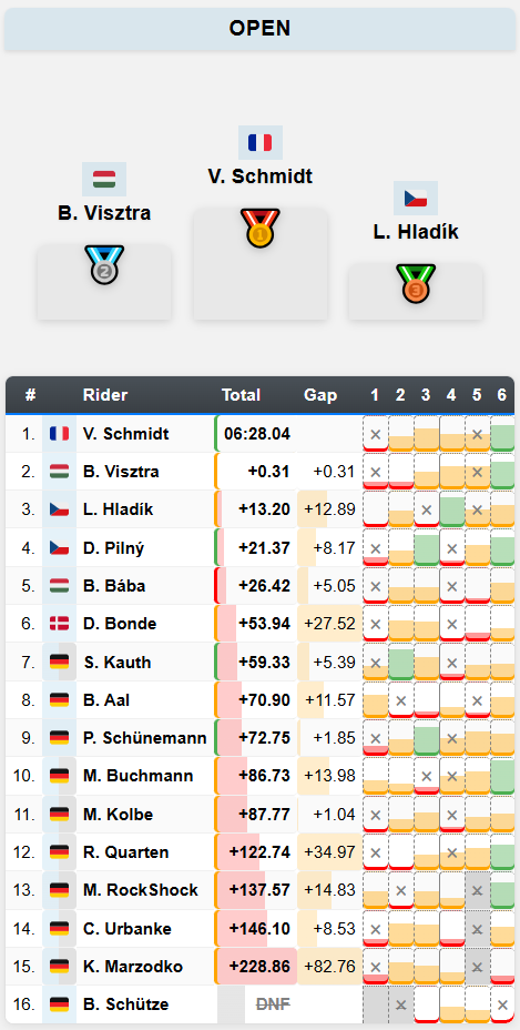

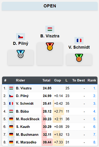

Some updates. Chassis TBD next week. The mechanic took more time to finish the car so could only return home later than planned, then I had barely any time before the Wuppertal race, from which I just came home. Also been hunting some gremlins in the CNC. Hopefully that’ll fixed now by running the files local on the CNC from SD card :crossed_fingers:

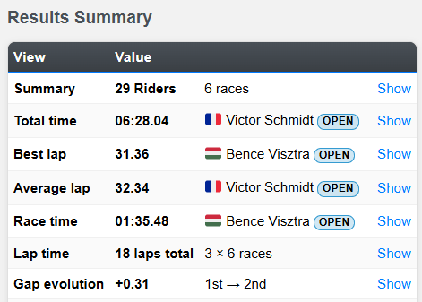

The race went pretty well. I finished 2nd, just 0.31sec behind Vik. I wasn’t very strong in the first direction, but the second direction I was doing really well.
I did get the best laptime and best heat time as well, so that’s good.

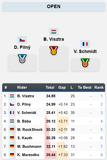

Then we had an I2S at a nearby track the next day, where I also managed to get the best lap time.
