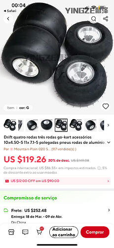

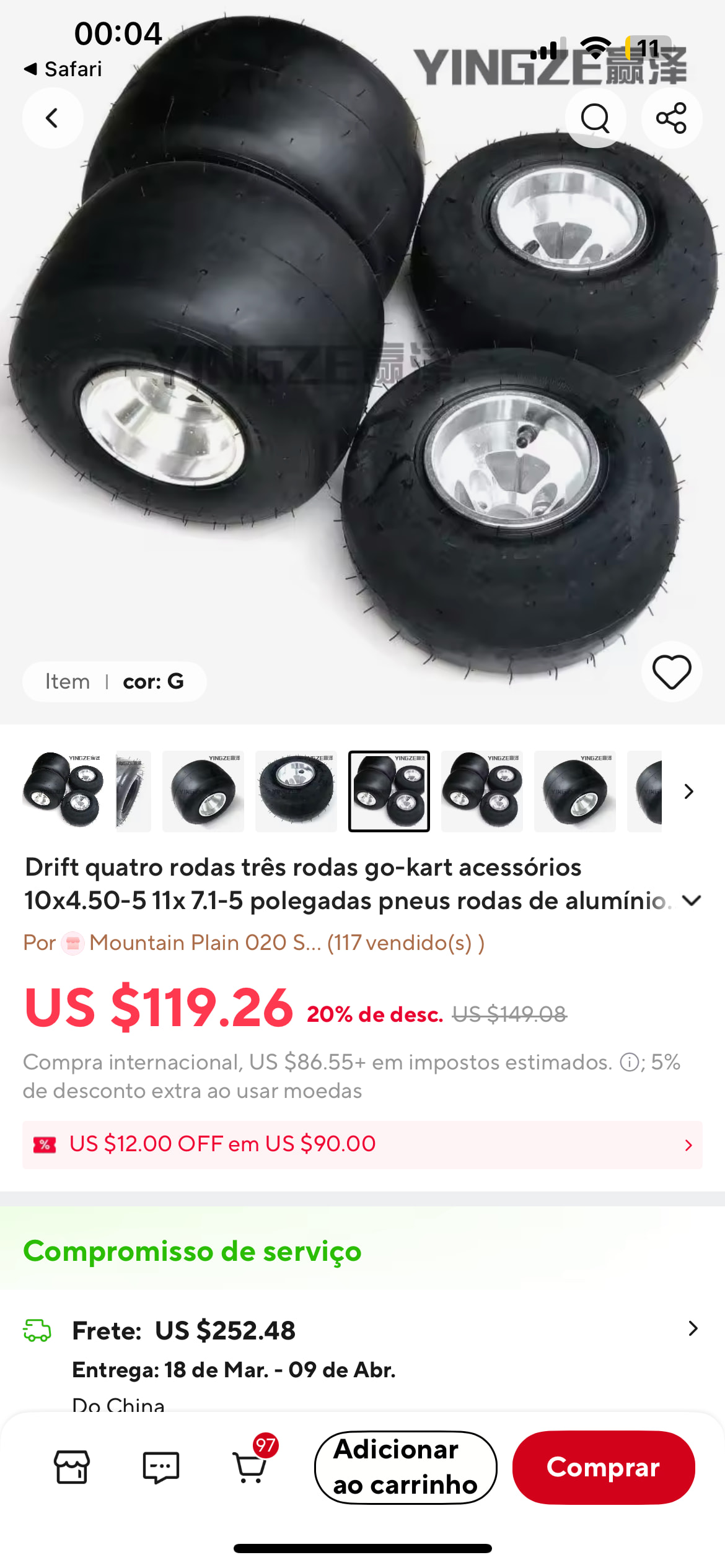

Are these the tires and wheels from AliExpress? Besides those, do I need a bracket to attach the pulley?
You should look for name brand kart tires. Lecont, Vega, MG, Hoosier. You won’t find either on aliexpress. Look for karting focused webshops. All tires should be 10x4.5-5, if you buy full kits you receive 2x that and 2x even bigger tires which aren’t good for esk8 use.
Before you buy any rims, find some wheelhubs first that support esk8 pulley mounting patterns - there aren’t many options at the moment (I’ll be making some in a month or two). I don’t think traditional belt setups will work with these, open gear is your only safe bet right now, until I get to making some enclosed gear drives for them (few months). After you got hubs look for rims that fit those hubs and have a 5" diameter, and somewhere around 5" width.
Also anything less than 12mm axle on your trucks and I can almost guarantee you’ll bend them. You need strong trucks. And then you’ll also need to extend the wheelbase of your board otherwise you’ll have wheelbite.

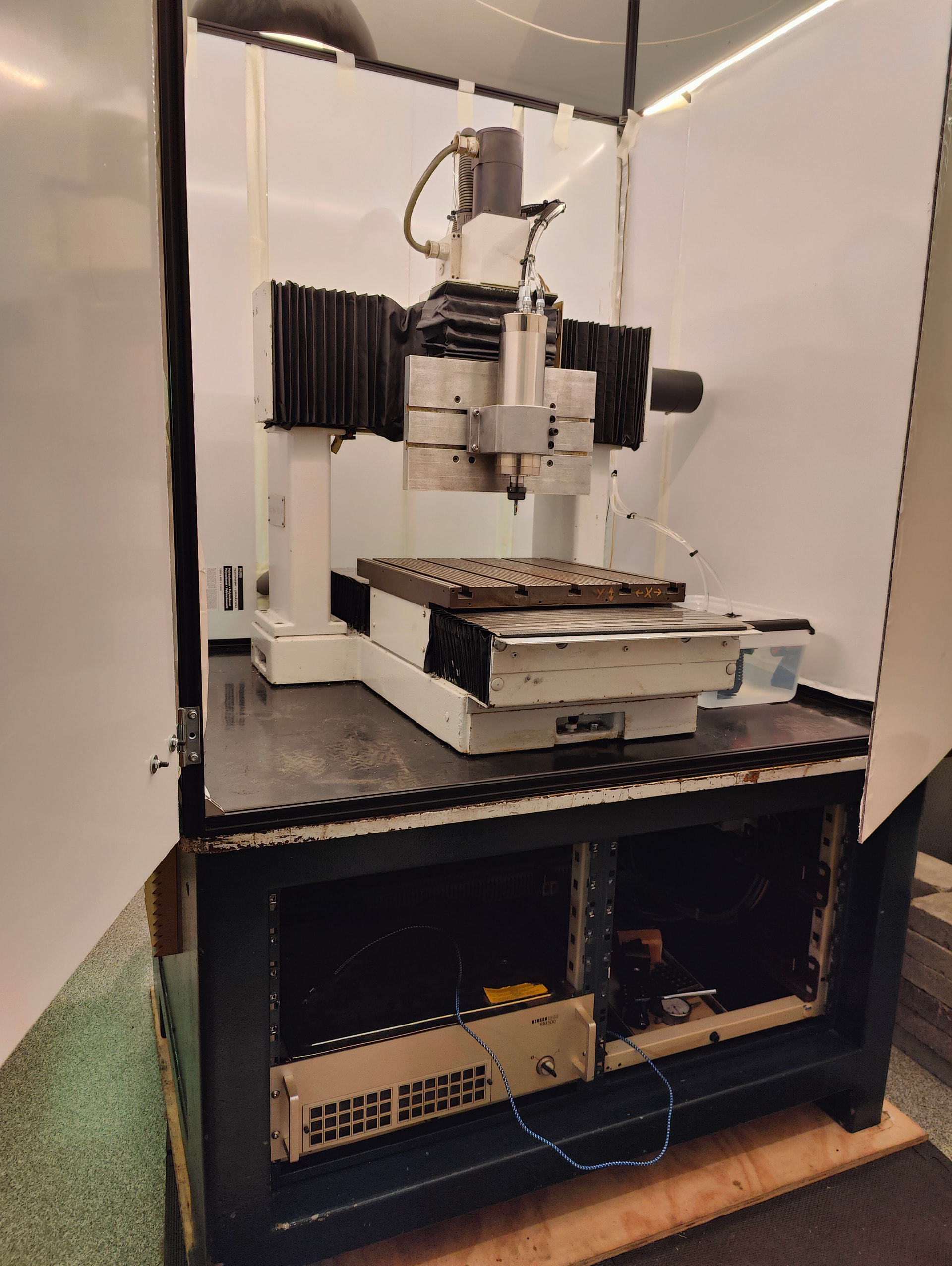

Some general updates regarding the production of this board - my CNC motion control system is finally figured out. The 40 year old steppers/ stepper drive definitely caused some headaches but they are working well enough for now, I needed to create a custom intermediary PCB to get it working. More on that in my CNC build thread when I have a bit more time to document stuff in a few days.
The rest of the electronics should just be plug and play and very simple to wire up. I’ll finish wiring tomorrow, then make the enclosure Monday. I’ll start cutting out the first chassis from wood on Wednesday - this will be just a mockup and not actually something rideable. I just want to verify my gcode before doing the real aluminium parts - messing up in the alu would suck a lot. I’m hoping to do the first test ride in about 2 weeks.
After countless hours of hard work… It’s finally working
Doing some test cuts in a bit.
