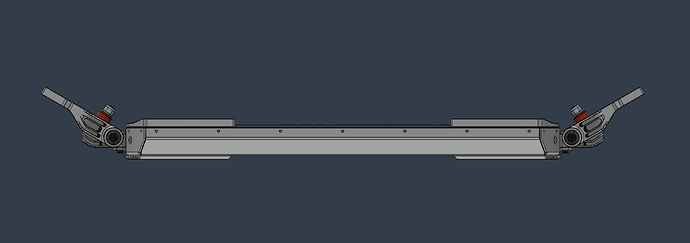

PROJECT: ENDGAME a karting inspired raceboard's development

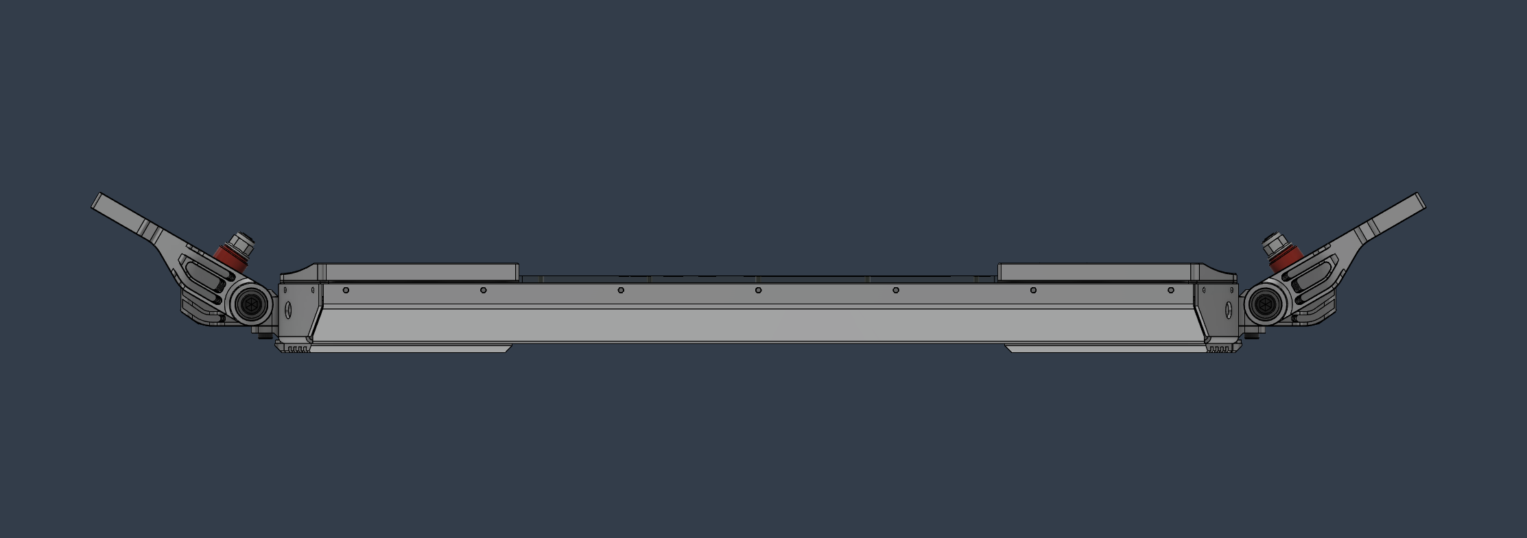

Things are coming along slowly but surely, setting up a CNC and kitting it out in itself is a huge project. Most of the CNC tooling is here already, I’m gonna finish up the wiring and order the last of the accessories that I still need this week.

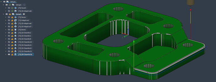

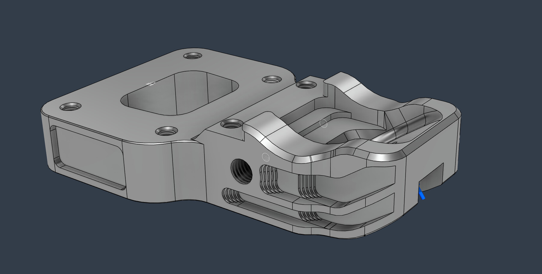

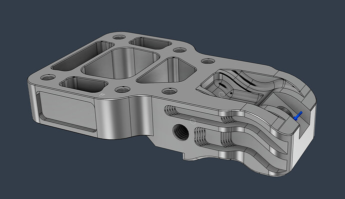

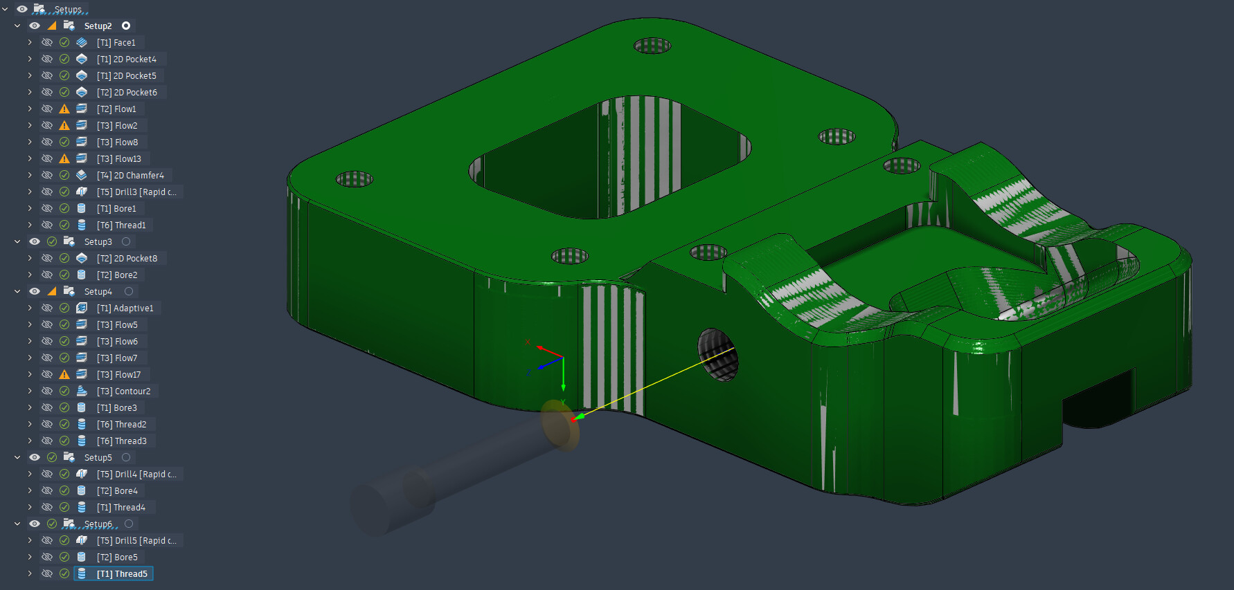

I’ve more or less finished learning the basics of CAM in Fusion by doing the toolpaths for the base of the swingarm. Some polishing still left for both parts I’ve done so far, but not too bad for first and second CAM projects ever.

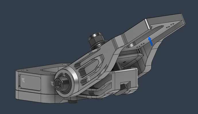

I’m not sure if that will work. There is going to be a lot of load on those pivots.
I would love to see a set of these suspension units that can be fit onto a more traditional flat deck.
You are not the first one to ask for that. It’d offer less benefits (lose the major benefit of completely eliminated torsional flex - which here is done by effectively having a big box section through the whole length).
That said it could still be a good option for something like a carbon wrapped idea style deck, but I think the actual idea decks arent very long?
One issue I foresee with universal compatibility is that the deck essentially needs to be chopped to be like a bracket deck, and only stiff decks can work well as a baseline, due to how far out the axles need to be from the bracket mounting. Also I’m standing directly over the mounting bolts. So some sort of big antisink for the bolts integrated into a separate footpad would still be very advised - I could make something like that as well though.

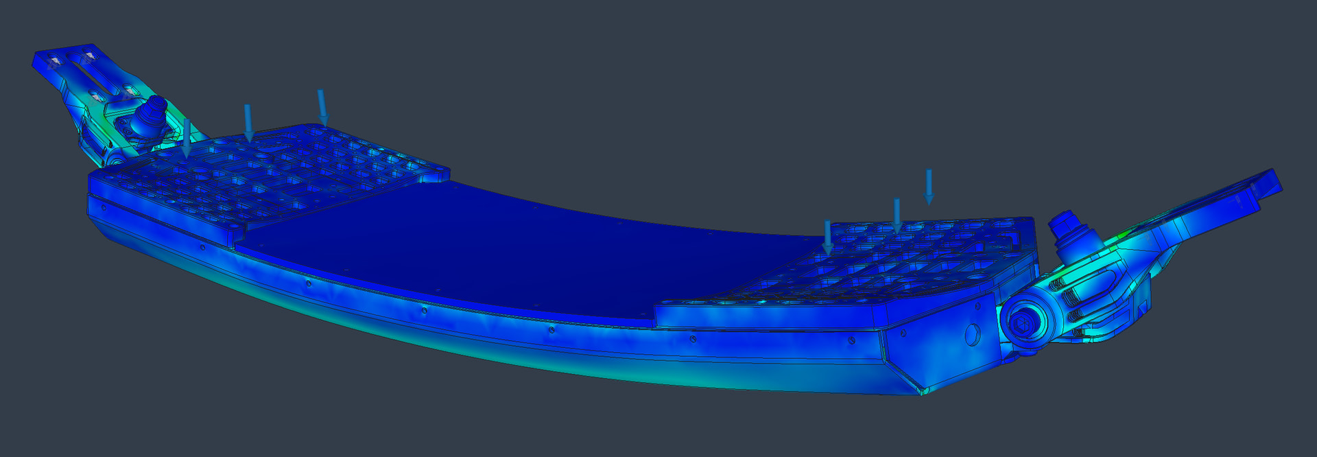

Added some weight saving cutouts

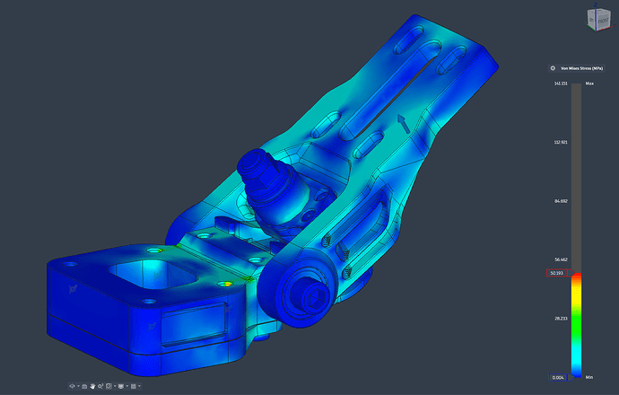

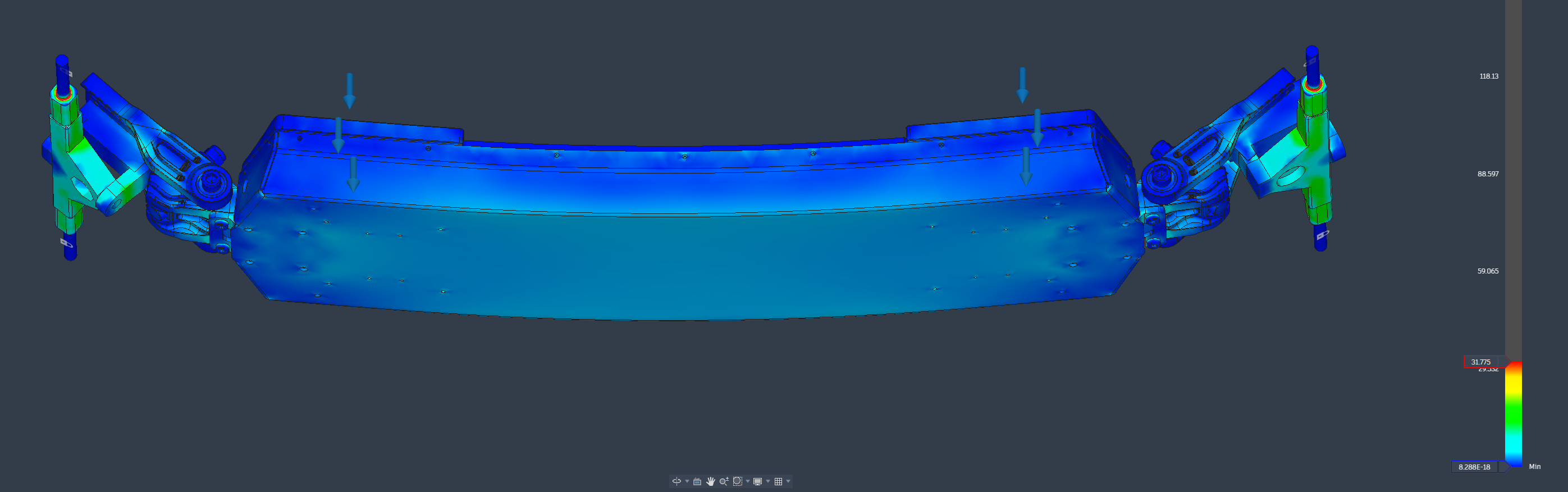

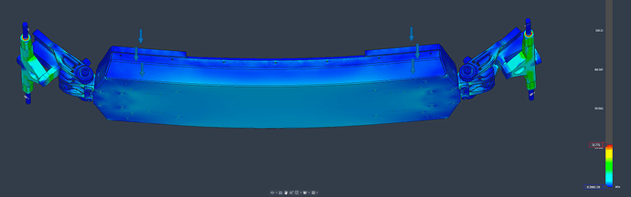

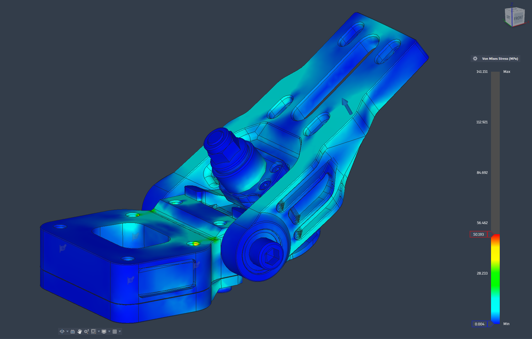

And did some FEA. For some reason it thinks the bearing spacer has the highest load out of everything, but I’ll chalk that up the FEA errors. The rest of the stress distribution looks good, and I probably removed most material already that I want to remove.
Probably the pin constraint for the M8 mounting holes wasn’t the right call, as there’s a sandwich assembly in reality and it seems to put most stress there. That said that’s definitely a high stress area in the part.

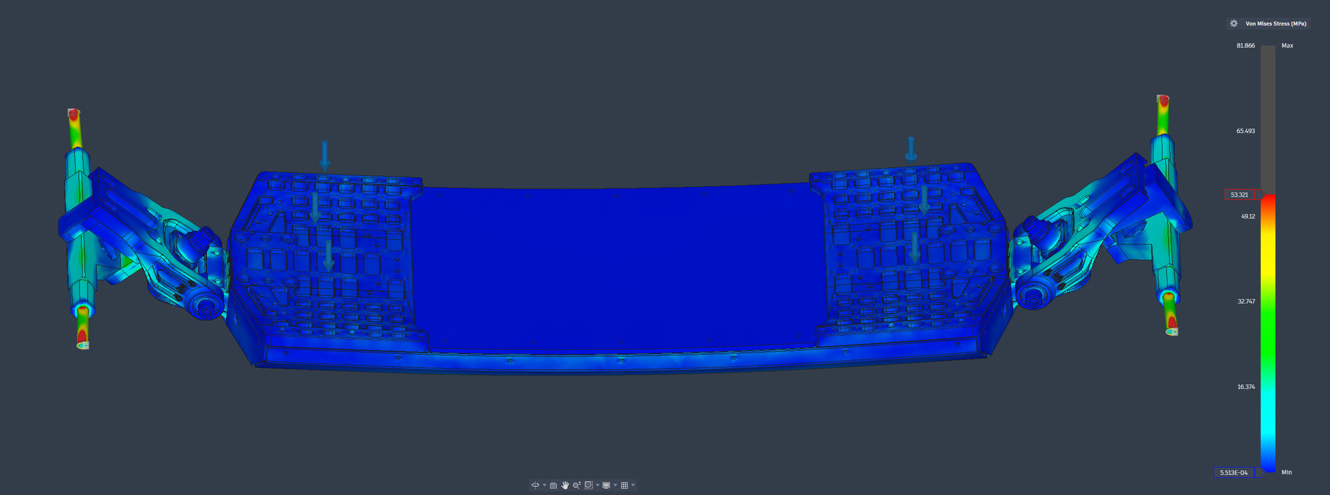

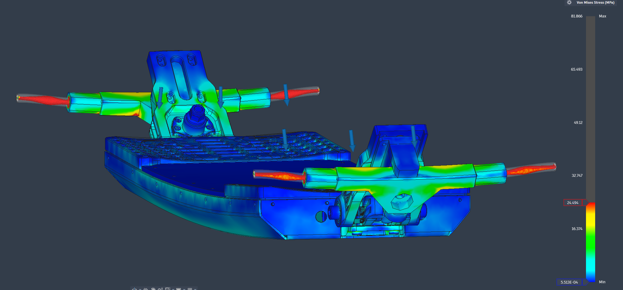

Trying to run FEA for the complete mechanical assembly, but it’s a big model so still playing with the settings and simplifications just to even get it to run at all.
The cutouts look great on the swingarm

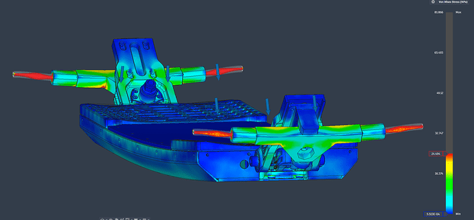

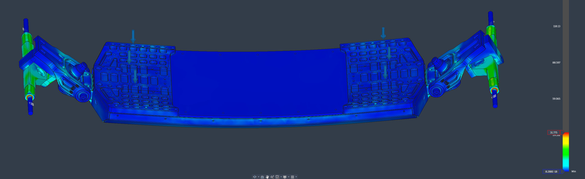

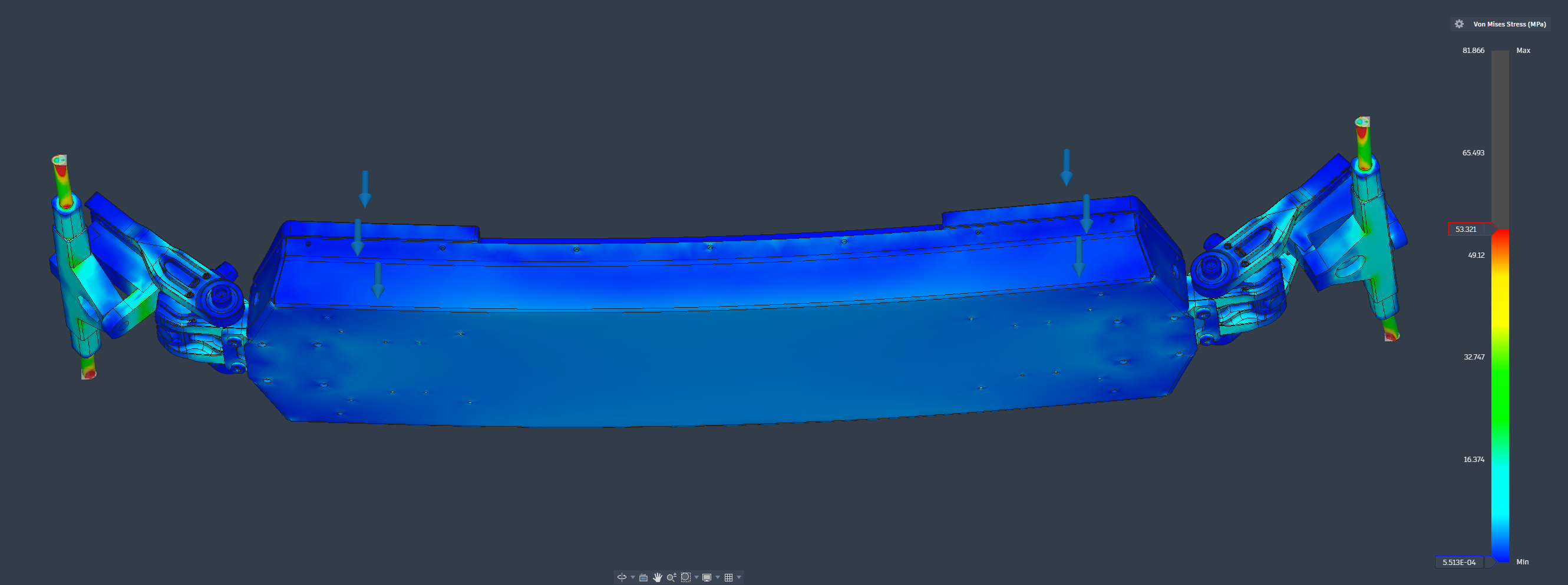

Refined the mesh and did a bit of simplification and now its running. The sandwich construction did reduce the stress around the bolt hole as expected, I’ll refine the constraints tomorrow. Cool to see the bellypan also taking up some of the load though.
Probably constraints still aren’t perfect, but saying that the axles are fixed (tried fixing the cylinder part and the flat end as well, probably fixing flat end is most realistic as middle of tire contact patch is more or less around the end of the axle) is a decent enough statement and close enough approximation for me.
Worth noting that I have the whole trucks modelled in steel, and they aren’t exactly accurate measurements.
That said. The 23.3^2 hangers and 12mm axles seem to be the weakest spot in this even when everything about the truck is modelled from steel. Which are pretty much known to be indestructible already from alu (from which duality hangers are made). So this pretty much assures that the chassis will be indestructible as well.
Seems like the parts I’d make max out at around 20-21 MPa at 120kg total static load on the footpads (probably around 80kg rider weight if board is built out to full spec)
If we don’t count the (already indestructable) trucks, then the weakpoint is the neck of the swingarm base. That’d leave enough safety margin for around a 25G impact. 25G getting past the tires and the pivot cups and the suspension is probably a knee breaking impact so I’m happy with that.

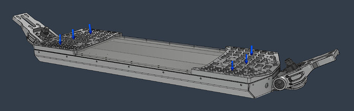

It’s probably bigger than it looks. Having internal space for a 3 cell wide double stack 20S5P + 2x2G300 kills ground clearance while turning… The kart wheels make up for it though. The internal space requires the deck to be super wide but I like wide decks. This will definitely be great for bigger people. 286mm wide deck with a long standing platform. I feel like the size and design definitely makes the kart wheels look more proportional and much less out of place though.

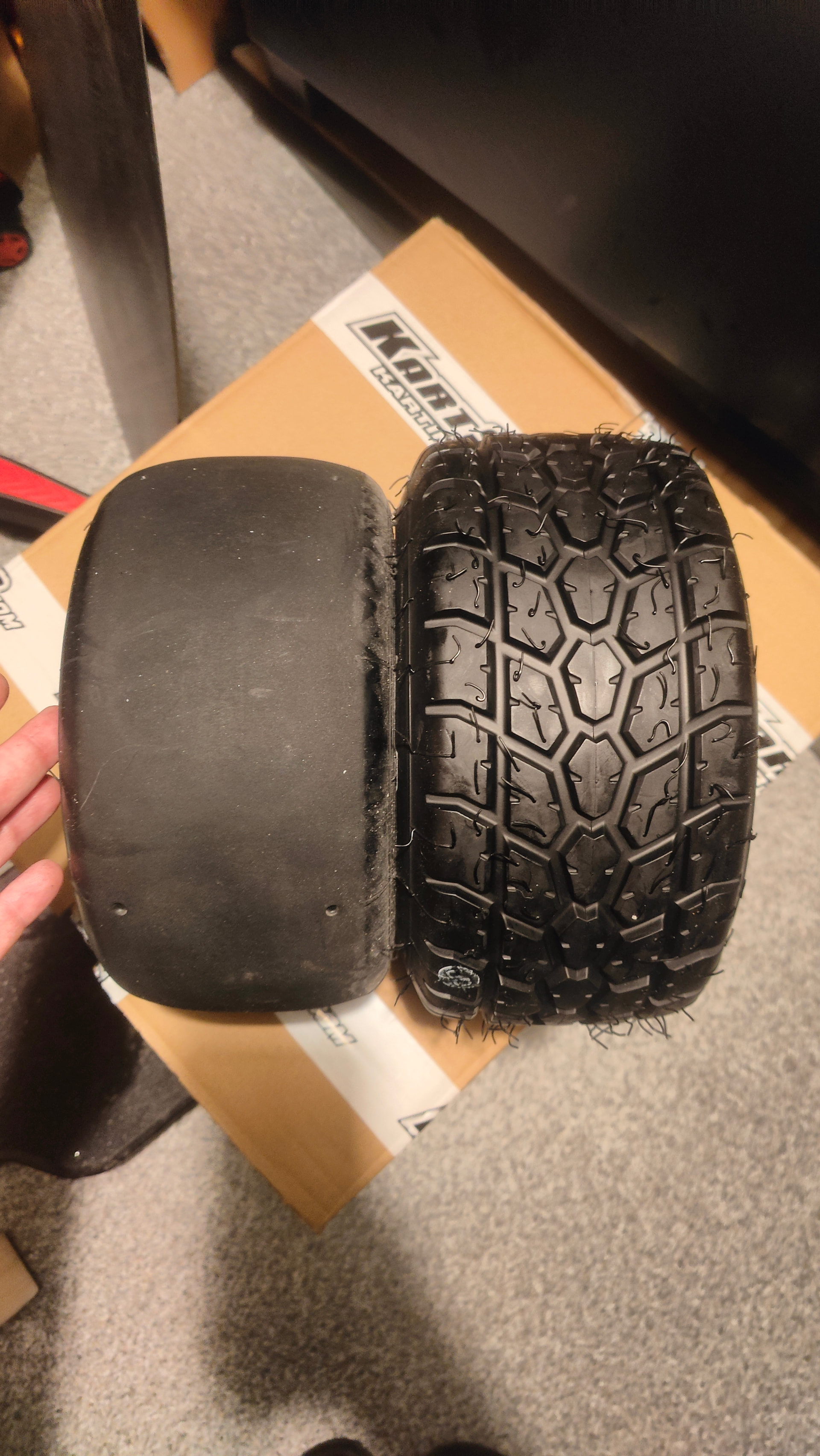

The fresh tires mounted up very nicely onto the rims thankfully, I think I was supposed to use 5.5" width rims for these tires but mine are only 5". Also they are 11", 10" would probably be preferable, but it should work fine, especially for 8€ a piece on clearance sale. The rubber feels almost like glue when touching it, pretty crazy.

Designed some heatsinks/ bolt head covers on the underside of the deck. Idea is these will scrape instead of the boltheads on the underside. Plus of course offer bunch of ESC cooling for intermediate electronic setups.

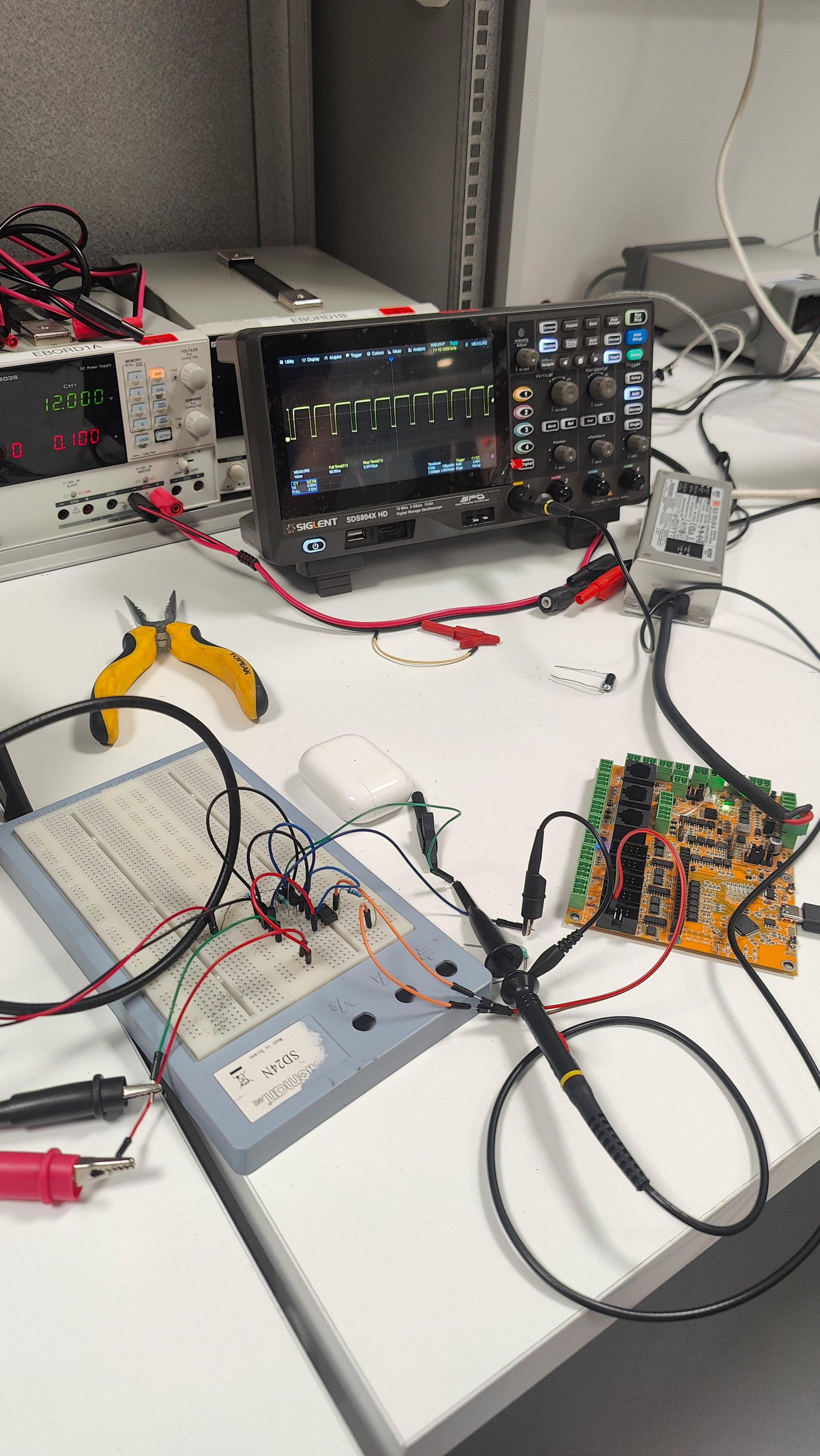

Made this circuit which takes low voltage logic input from the cnc control board and drives the stepper driver which operates at 12v logic. This is tested to work on a breadboard, got a pcb design done, been trying to cut that out at university and failing miserably with makera’s buggy cam software. Will go back to uni and keep trying or just make it on prototype boards if I can’t figured the carvera pcb work out.
Once that board is assembled the cnc will be running with maybe 2 hours of extra work.
