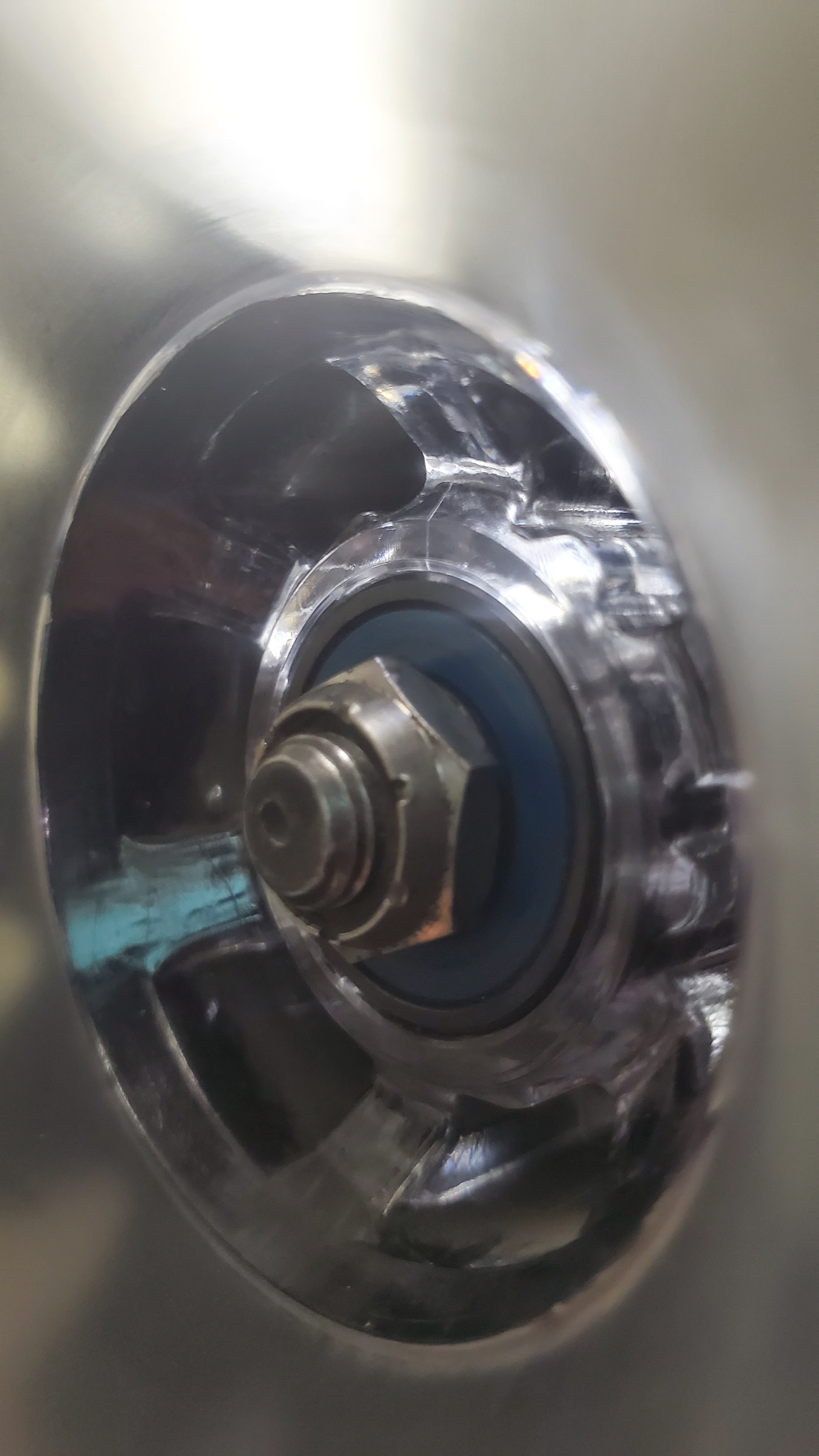

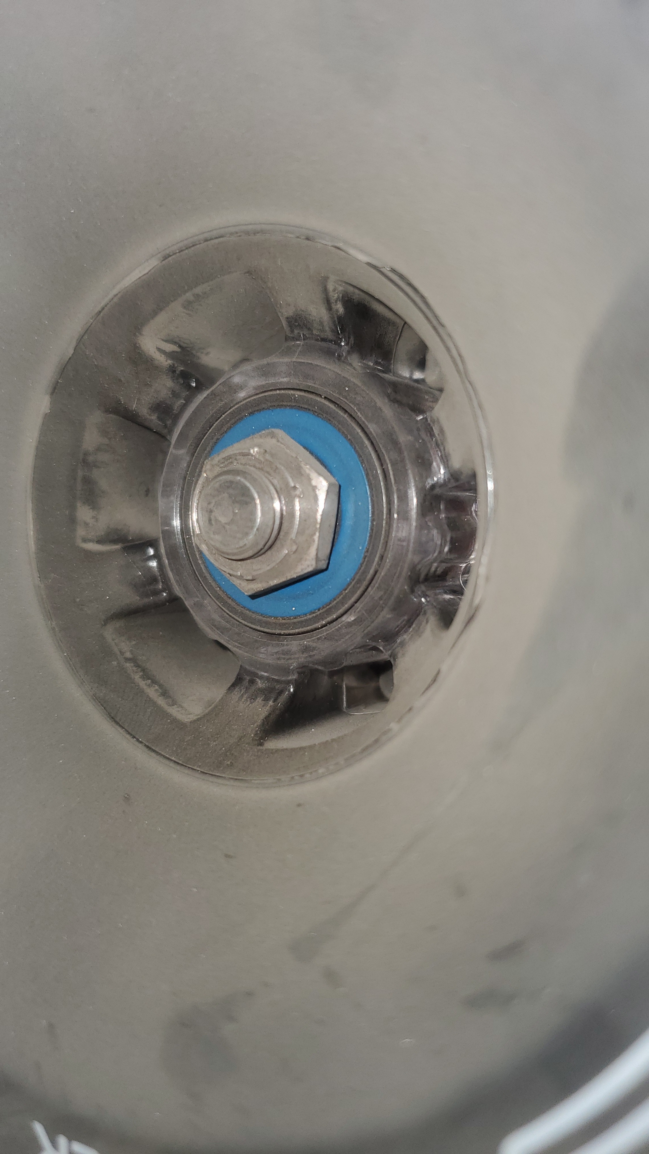

Well, put about 20 miles on em today, little mold line hanging in there. Much easier to inspect for cracks now that it’s clear…

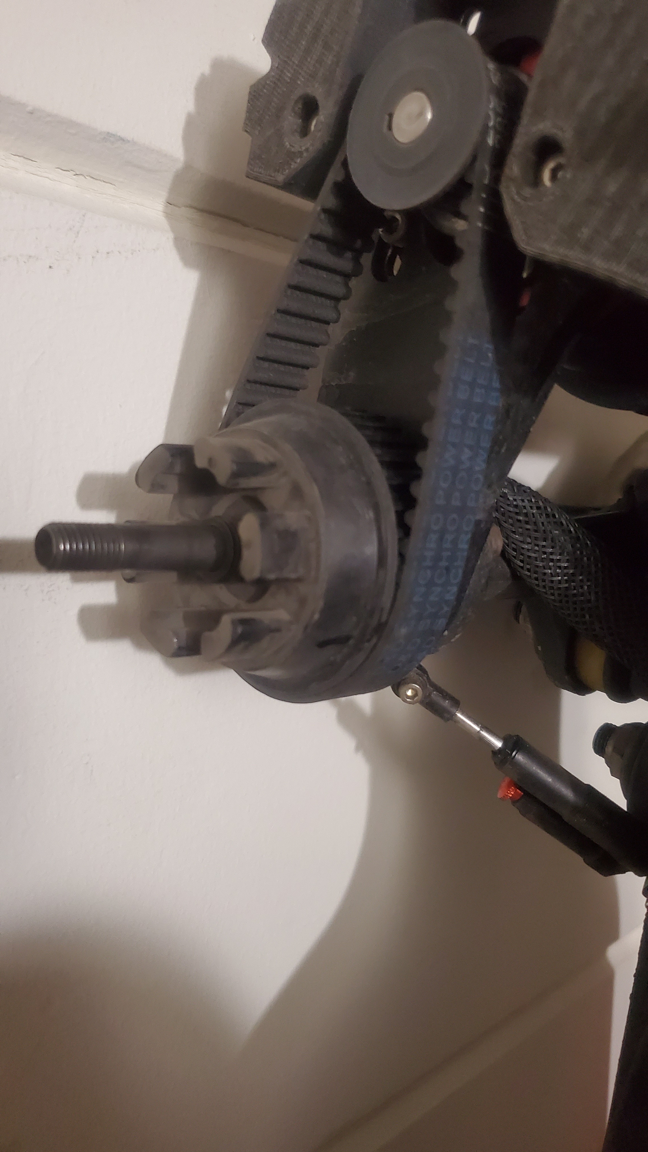

What are you using for pulleys?
No problems yet. Although I thought it would be cool if you offer these in a stone ground version, where the center thread is ground flat for better contact patch out of the box. Brand new the traction is very bad, I overshot a few corners from sliding. They take about 50 miles before they start to feel good…
@rafaelinmissouri BB press fit clone pulleys. They have very short arms going into the core, they grab maybe 1/3 the width of the core, so they should be putting some significant torque stress into the core spokes…

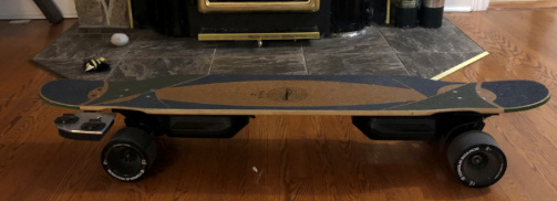

So if you do another video, I have a two suggestions for consideration:
  1. A camera outrigger to get POV footage of the wheels. Something like this:
  1. Some footage riding over sidewalk expansion joints. Also transitioning the curb where the sidewalk ends and the pavement starts.
That type of footage could be a big help to I-wonder. Its something they could use on their facebook page to inspire confidence in the new core.

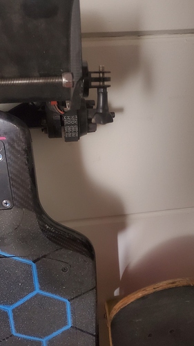

I’m still working out how to mount a camera to the board, my last attempt did not pan out
This mount whipped the camera housing bracket right off, need to do another mount on the deck with some vibration dampening of some sort, but coming soon :+1:

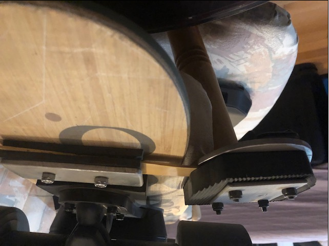

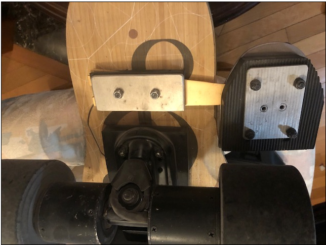

Since you mention vibration dampening for the outrigger, here are a few ideas. I use 1/4 inch rubber flooring to make a sandwich (aluminum, rubber, deck, rubber,outrigger, rubber, aluminum)
The outriger supports a 1/2 inch vibration pad sandwich (aluminum, rubber, outrigger, aluminum.
