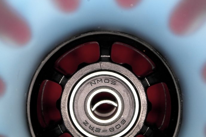

I have 2 sets of these new still in the box and 5 of the 8 are cracked, just like Alan’s. Glad I came across this thread guess I’m out $200 :expressionless:

This is so fuckin weird. I also was going to suggest that it was maybe a mold line or something, but if you’ve checked well is obviously a crack … But a crack on brand new wheels ? That’s fucked up.

Better pictures:
Both sides of the worst wheel.
