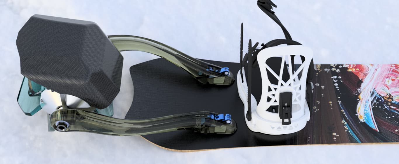

Super cool! How do the threaded studs on the dead axle of the motor (would you technically call that a dead axle?) connect to the mounting arms?
Axle locks (Patented) :slight_smile:
Still working on the fender… Getting closer.
