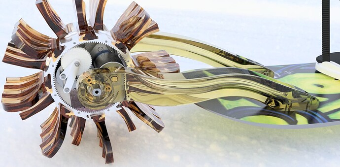

Finalized gearbox v1
Dual 5065
7.8:1 gearing
This should be a lot lighter and less expensive to power.
In your last video it looks like the power really surges as the paddle grips or hits ice. I wonder if a planetary gear drive would be better than a single spur gear. I could see it easily chip a tooth when the paddle goes from spinning fast and then abruptly stopping when it gets traction. Although I don’t think you could do the planetary gearing with two out runners in the hub, maybe it could be Incorporated into a hub motor design? I have an ebike with a DD rear hub and a Geared hub in the front, and the front motor has more than double the torque even though it’s less than half the size and weight.
Planetary geared (and reasonably silent) hubmotors has been a wet dream on this forum since forever.
Its no easy feat. maybe bit easier at that size but still :slight_smile: Think best route would be to take one of those bafang motors that are planetary geared that has been developed for a few years and retrofit em to a skate. They’re s’posedly real solid.
up to the snail race? they are like <10KV and also the gearbox is made for super low RPMs (planetary gearboxes are usually all made for low speeds, like max 5kRPM input)
I played around with some neugart ones, but problem is always the same: high RPM => noisy + fast wearout
low RPM => heavy and not really an advantage vs investing weight and money of gearbox into a bigger/better motor
We have a few planetary hubs, tried to go that route but they are all too slow. 400RPM
(Tring to avoid stamping our own stators if possible.)
I was thinking we could add a 2nd idler gear to the other side of the pinion giving it more bite.

Not to crap on your design or anything, its really beautiful. But I think the best way to prototype this would be to have the driving motor external. Leaving you lots of flexibility to experiment with gear ratio and size of motor. (You might have done this already, I have only skimmed thru some of the info here)
Once a motor size and gear is estabished sufficient for intended use. One could iterate abit better on this information to something you’ve modelled above. I think realisticly you’d be able to draw maybe 1kW of peak power per motor from those motors. Since they’re isolated from free air as I understand it, you’re more looking at the cooking pot scenario, yeilding a decrease in avaible performance depending on outside factors, such as heat dissipation and ambient temp.
Regarding the brand, if they’re in the same pricerange, they wont differ alot. The avrage generic outrunner is anywhere from 80-150 buckaroos and the upper span isn’t necessarly any better then the lower span. Theres some german brands out there that are 4x the price of the chinese ones. I have no idea if they’re any better tho.
Albeit they’re expensive, Hoyt’s tiny motors are surprisingly powerful (56x53 though):
If I was designing this personally, I would stick with a single, larger motor. Alter the design / add more gears if need be. Would be simpler, which is usually better. Means you only need a single ESC too.
Figured the biggest differences would be bearing quality and how tight they are wound.
I purchased some to test.
The goal is to cool them in ATF fluid. The rotor is frozen from the ambient conditions.
I am worried about eating gears, tried dual idlers but they wouldn’t mesh. Went with the largest idler that would fit.
