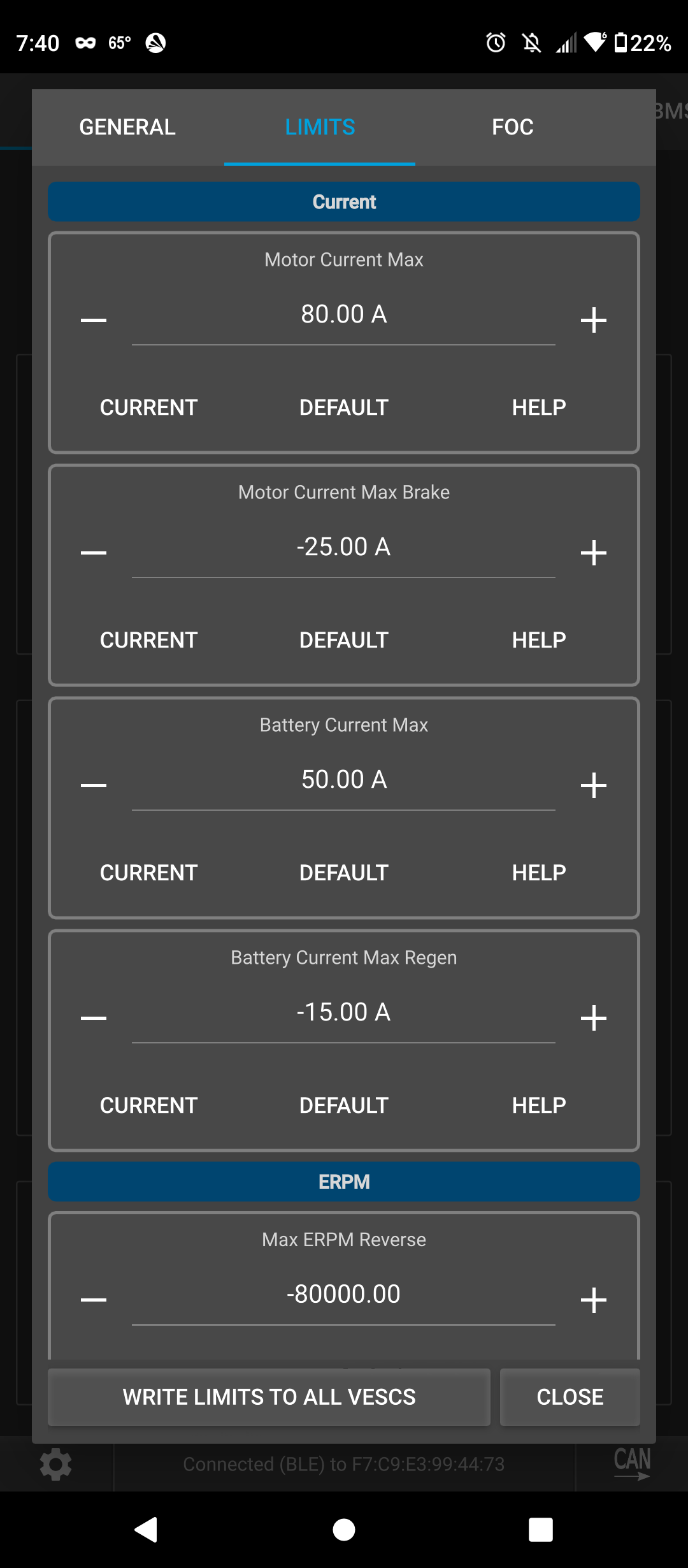

I tried lowering the absolute max to 200a but when I went to save a pop up window said the value was truncated (lowered) to whats allowed or something then it changed it back to 400a. Wtf?
Since the android app wont save adjustments i will have to open the enclosure every time to make adjustments. That sucks.
25A for what setting? 62.5A for motor max?

Try
motor max 80A (each motor)
motor min -60A (each motor) (low speed brake strength)
battery max 40A (each motor) (or 62.5A as @glyphiks said)
battery min -17A (each motor) (high speed brake strength)
absolute maximum current (don’t touch)
max erpm (don’t touch)
In the advanced section, lower “Fault Timeout” to 85ms and set “Duty Cycle Max” to 95% and “Duty Cycle Current Limit Start” to 85%
Then save.
Then, do ALL OF THAT (except the helmet) again for the other motor.
When numbers are negative, they have to be negative.

Mboards instructions said all builds should use 80,000 erpm. Should I recalibrate and leave the erpm at the original figure? I think it was like 100,000. Same with absolute max. It was around 401A.
Oh I know they aren’t safe. Ive been riding for 4 years and always gear up. I meant safe so I dont fry the hardware.
That’s an erpm limit. 80k erpm is the “limit” for older v4 hardware. A normal 12s setup isn’t getting near that. Leave it at 100k
Disregard MBoards, and leave that setting alone. They don’t know what they’re talking about.
