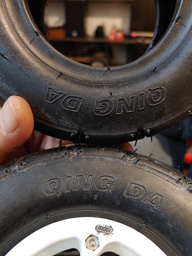

FWIW: I just got 2 different brands/sources of 200x75 slicks in. Total of 12 tires. I’ll snap some photos tomorrow to show the difference- there’s a clear winner between the two sources I ordered from. Same Kenda markings on each though. Guessing an A/B stock thing. 8 of them look great though, but now stretching my favorite Kenda k909s is super enticing.
