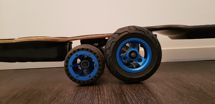

Just wondering if those wheels are available in the US?
Sure, If you buy the board.
@Chricious, what board? I’m just curious about the 105mm airless wheels with the blue rims. They might work for me and I’ve never seen them before.
The Teamgee H20T
