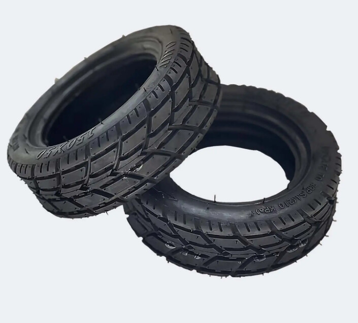

Has anybody tried OMWs 6 inch tires? They look good.
I am currently testing a hussar with omw with these tires, and I’m a guy obsessed with tires.
They have a nice flat profile at lower psi, but become a little rounded with higher psi.
Sidewalls not as stiff as other flat profiles I’ve tried.
Grip is lacking a bit. I think it’s because of the tread pattern, since the formula seems okay. Can’t carve as hard with them without the grip breaking, and feels a little more slippery on sandy/dirty corners.
They are pretty balanced, but I wouldn’t call it perfect, or amazing.
Overall I think they are great tires to come with a production board that riders don’t need to upgrade, but it not something many of us would opt for as an aftermarket tire.
I think it could be the compound too. It is a little hard. It is still a good all around tire for those that want a tire that lasts for a long time.
